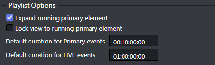

Playlist Options
Expand running primary element: If selected, the primary element playing will be expanded when started (triggered).
Lock view to running primary element: If selected, auto-scroll the current running group (primary element) to the top in the playlist view whenever the primary element is changed.

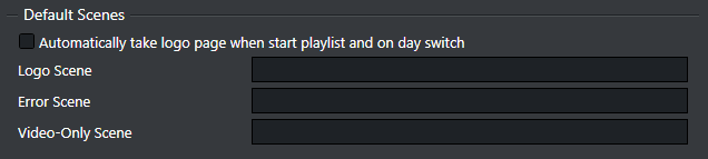

Default Scenes
Automatically take logo page when starting a playlist and on day switch: When selected, once the day switch occurs, the logo scene goes on air.
Logo Scene: Enter the scene name of the required logo scene to be played.
Error Scene: Enter the scene name of the error scene that should be easily accessible in the event of an error.
Video-only Scene: If Play Video Through the Viz Engine has been selected in the Basic Settings, enter the scene name of the video-only scene that will be played when Viz Channel Branding has no templates or playlists in memory.
Note: If you have a Matrox X.mio 2 plus card this is not required.
Tip: The above scenes can also be set using the context menu available to pages listed in the Templates, Pages and Pilot Data Elements pane.

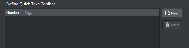

Define Quick Take Toolbar
For adding and defining Quick take buttons to show in the Client menu bar.
Press New to add an entry and define what page should be taken when pressed.
