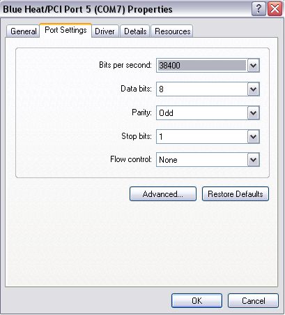

Make sure the COM port used has the following suggested parameters under Windows Configuration on the Media Sequencer machine:
Bits per second: 38400
Data bits: 8
Parity: Odd
Stop bits: 1
Flow control: None

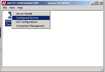

Launch the ADC-100 Configuration Utility and locate the icon that represents your Device Server.
Right-click the icon, and select Configured Devices.

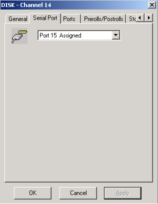

Double-click on the Disk device that was just created. From the resulting dialog select the* Serial Port* tab.
Select the physical port the Media Sequencer is connected to. The Harris Device Server is now configured properly to communicate with Media Sequencer.

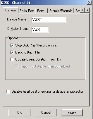

Configure the following parameters on the General tab:
Device Name will appear in the Device Status and configuration windows on the client applications. The default name may be used, but it is recommended to use unique names to ease later identification.
ID Match Name will be used in the Transmission List’s *ID Field *to let the system know that the event is intended for the Vizrt device.
Stop Disk Play can be selected as required.
Back to Back Play can be selected as required.
Update Event Duration from Disk must remain unchecked.

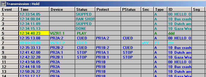

Secondary A/V or Secondary Backtimed events can be used to execute the pre-loading and playout of media.

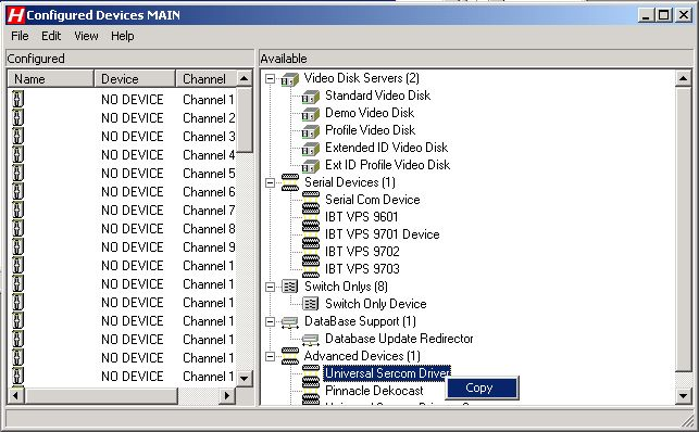

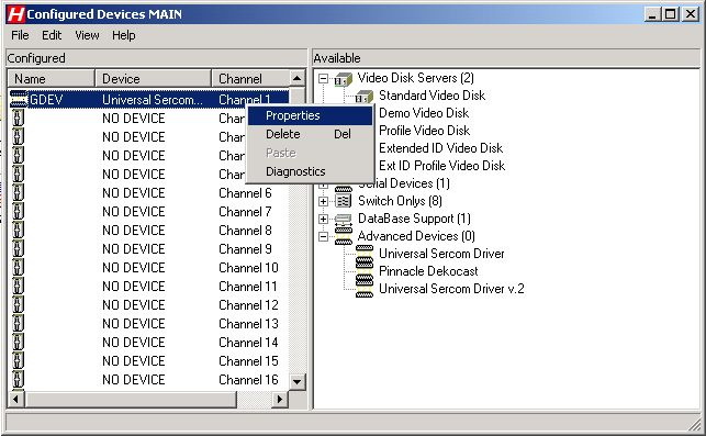

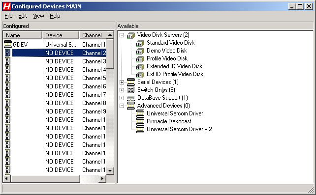

In the Available column on the right, under the Advanced Devices category, locate the Universal Sercom Driver. Click and drag the driver to one of the channels in the Configured column that reads NO DEVICE.
A new device will appear in the left pane of the Configured Devices main window.

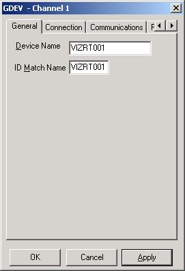

Right-click the new device and select Properties.
In the General tab replace default name and ID with VIZRT001 and click Apply.

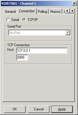

In the Connection tab, insert Media Sequencer machine’s IP/Host or Serial value and the Port (for TCP) as configured in channel settings for TCP or VDCP device settings.

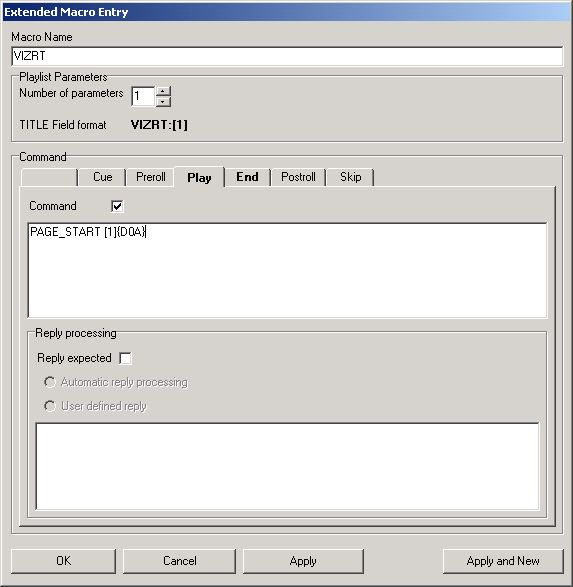

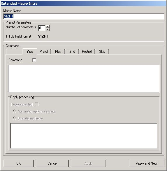

In Macros tab click the Add button to create a new macro.
The Extended Macro Entry dialog box is displayed.In the Cue tab set the Macro Name to VIZRT.
Set the Number of Parameters to 1.
Check the Command check box.
In the Command field, enter the command to be used.

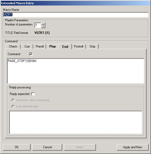

To edit the graphics stopping macro string, click the End tab.
Play will be triggered when an event starts. End will be triggered when an event ends.

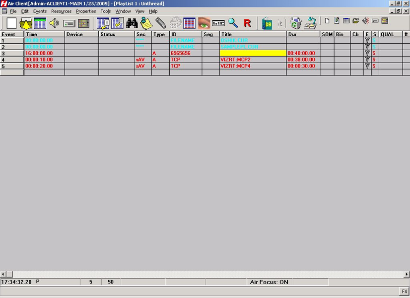

When an event is triggered (primary or secondary), the command take id is sent where id is the Trigger ID value in Viz Channel Branding and ID field value in ADC-100.
Harris playlist (.LST) USD format:*
TITLE field: macro_name:trigger_id (Media ID). For example: VIZRT:MCP2
ID field: USD_NAME (device) name
Reconcile Key field: Template name
Harris macro format: trigger_command [1]{D0A}. For example: PAGE_START [1] {D0A}. {D0A} is the char symbol for Enter.

Viz uses A/V, Secondary A/V to execute the pre-loading and playout of media.
