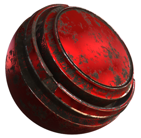

In our example, we use the default Preview Sphere from Allegorithmic Substance Painter samples. Import your geometry (or use a built-in geometry) and add it to your scene. Drag any Material Definition from the server view to a container or right-click and select Add Material (Viz Engine Pipeline).... This adds a default material to your object.

The traditional material in the Classic Render Pipeline has a diffuse setting, describing the the color of diffused light. Working with PBR materials, the same setting is now represented by the color (or sometimes called albedo component). This can be a color only or a texture, typically mapped using UV coordinates.
Color or Albedo Map
Defines the basic color of any diffuse light hitting the geometry. As the Viz Engine Render Pipeline renders in linear space, the sRGB flag defines whether a sRGB texture is in use. If you are not using a UV mapped image, you can change the wrapping method. Additional filter settings for scaling can be applied (linear filtering and nearest filtering algorithms). Usually, those settings do not need to be changed unless you see some jaggy artifacts.
The anisotropic filtering value defines how pixels that need to be stretched, are filtered in z-order. A higher filtering reduces blurriness in the back and adds more detail.
If a texture is going to be used, the base color can be kept white, unless you want to recolor your image. In addition, an alpha value can make the object transparent (without any special transparency effects). Albedo maps should not include any kind of lighting information.

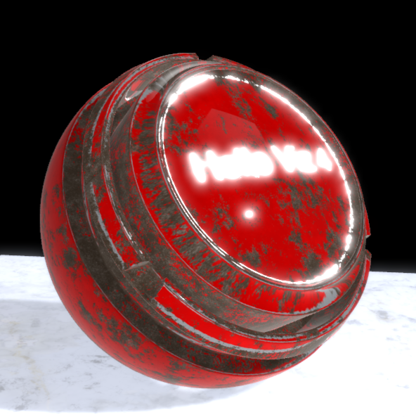

The emissive component defines the areas and color of any light hit by the object and reflected again. Substance Painter can also export an additional emissive texture. If you want to add some blooming effects afterwards, the emissive map can define these highlight areas.
In the given example, we added some highlight effects on the top surface. This is done using an emissive map, the intensity factor and the blooming post-processing step. The base color should be kept black, otherwise your geometry emits all light.

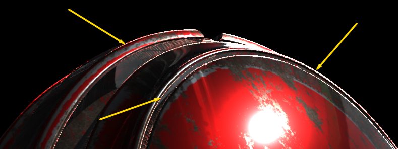

Specular Anti-aliasing

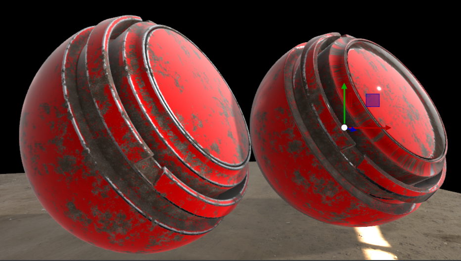

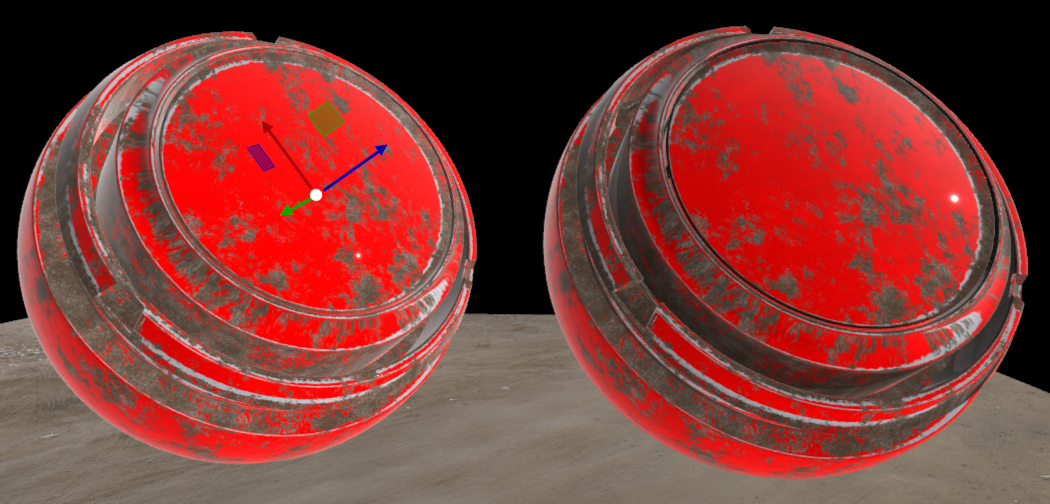

In some conditions, if your light source hits a beveled surface, the lighting effects on the edges can be over sampled, as in the following image:
To correct these unwanted artifacts, use the Specular Anti-aliasing settings in the Material Settings.

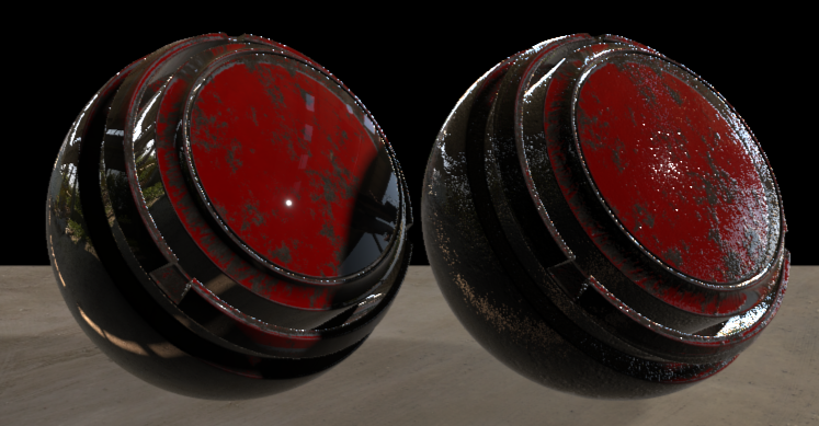

Roughness
Roughness maps (or microsurfaces) defines how rough or smooth the surface of a material is. Rougher surfaces show wider but dimmer specular reflections, whereas smoother surfaces show more brighter but sharper reflections.
In the Viz Engine Render Pipeline, a roughness factor of -1 defines a very smooth surface, +1 the opposite. If you play with surface reflective settings, the roughness factor is very important.

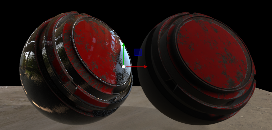

Environment Maps

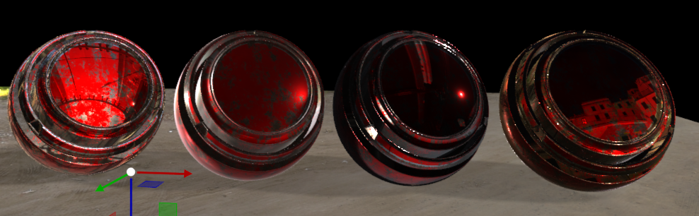

By default, each geometry uses the default scene environment map. Under certain circumstances (for example, when simulating glass effects), it might be useful to apply another environment map than the default one.
Various Environment Maps |

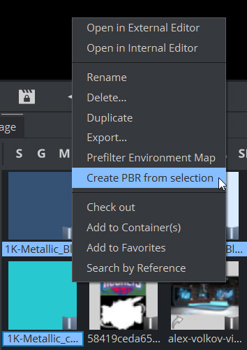

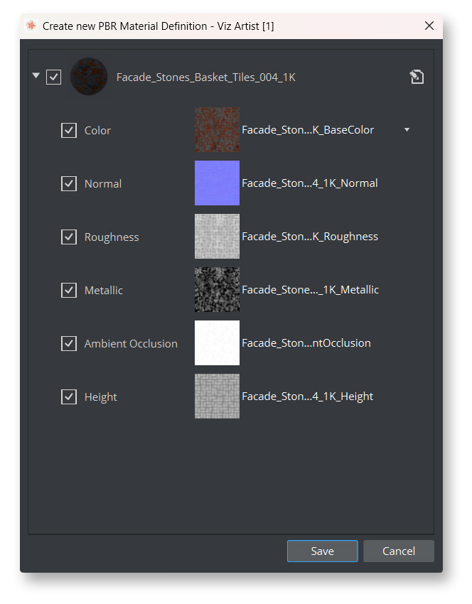

Improved Image Import for PBR Materials
When dragging a collection of images or a .zip file into the asset view, the importer automatically recognizes if these files belong to a PBR collection. The identified images are presented in a dialog and the user can choose if the images are correct or, if multiple choices are available, select the right one.
To create a PBR automatically:
Drag a .zip file containing multiple images to the Asset view, OR
Drag multiple images to the Asset view, OR
Use the context menu on multiple images in the Asset view:
Information: If your images are not identified automatically, you can modify the naming convention list by opening the file C:\ProgramData\vizrt\VizArtist\MaterialDefinitions.json and adding your own pattern.

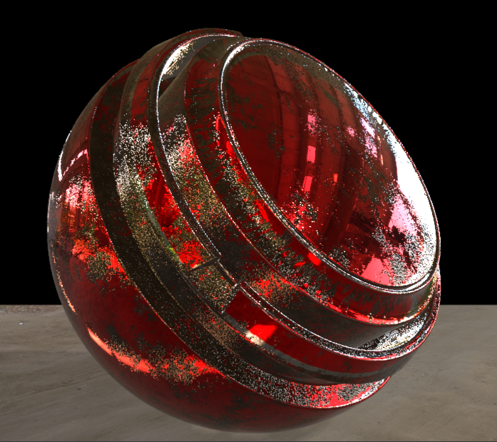

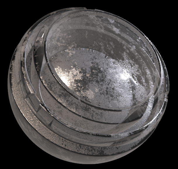

Using Transparency Effects
Creating photo-realistic glass effects have always been a challenge. This is now much more easier using the new PBR material editor. The refractive index in combination with the Alpha Fresnel Power makes your object transparent and adds some refraction effects. The refractive index is the deflection of light when it pass trough your surface to another surface with different density.
Tip: Turn down the roughness factor and increase the metallic factor a bit to achieve nice reflection effects.

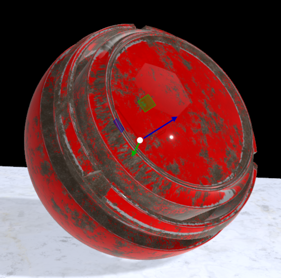

Texture Manipulation

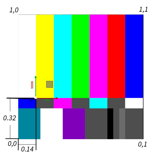

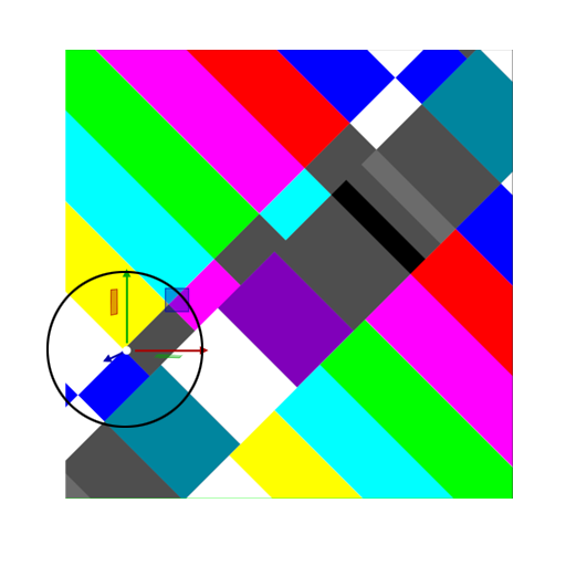

Non-UV mapped textures can be modified on PBR and Phong Materials. This can be Rotation, Offset and Scaling. Rotation and Scaling are based on a Pivot position.
Example: Rotation a texture on a Pivot point: The coordinates of a textures are 0,0 in the lower left (U) and 1,1 in the upper right (V), therefore if the pivot is set (as in the example below) to 0.14 in U and 0.32 in V, the rotation would look like this:
The same applies to the Scaling.
For more information, see Texture Generation.

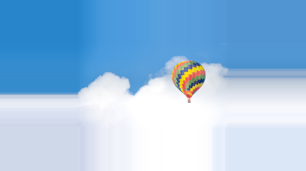

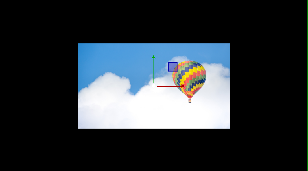

Clamping

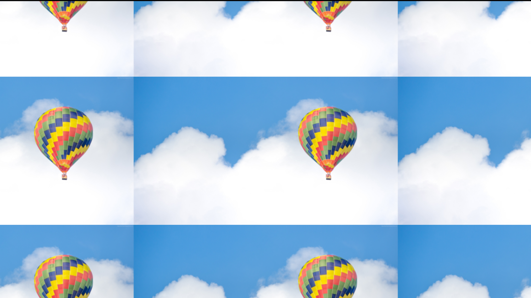

Textures can be set to clamp to a border color. This means instead of repeating the last pixels, they can be overridden by a border color. This can be set by using the Wrapping mode in U and/or V:
Repeat Mode | |
Clamp Mode | |
Clamp to |
Information: The Alpha mode of the border currently only works for RGBA images.

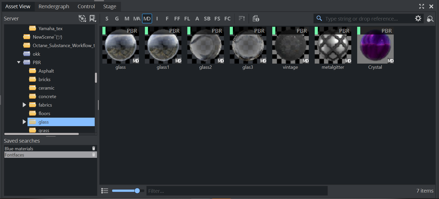

Working with Material Definitions on Graphic Hub
PBR Materials can be stored as Material Definitions on Graphic Hub. This means you can build your own library of pre-defined PBR Materials on your Graphic Hub. To store PBR Materials as Material Definitions, drag and drop them from the Scene Tree to your Server view and give them a proper name. PBR materials are labeled with PBR on top:

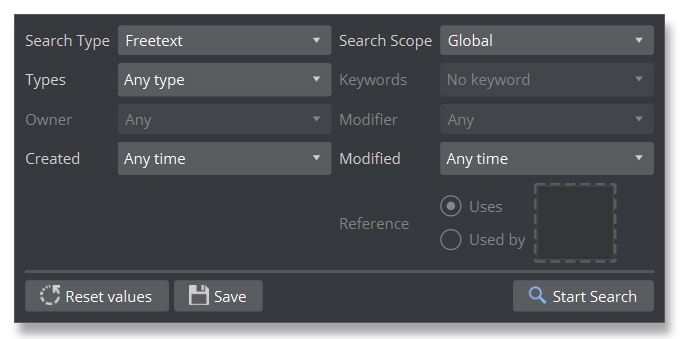

You can also search which texture you have used within this Material by using the search widget in the Asset View. Make sure you select used by:

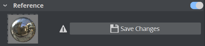

When using PBR Materials from Graphic Hub, they are linked into the scene, meaning if you modify them inside the scene, these changes are lost. You can break the connection between PBR materials and Graphic Hub by turning off the reference switch. This means the material becomes part of the scene.
If you modify a referenced material and want to keep these changes, you have to Save them to Graphic Hub (Save Changes).
Note: Be careful if you use these Material Definitions in other scenes and modify them, this also modifies the reference and affects all referenced scenes.
