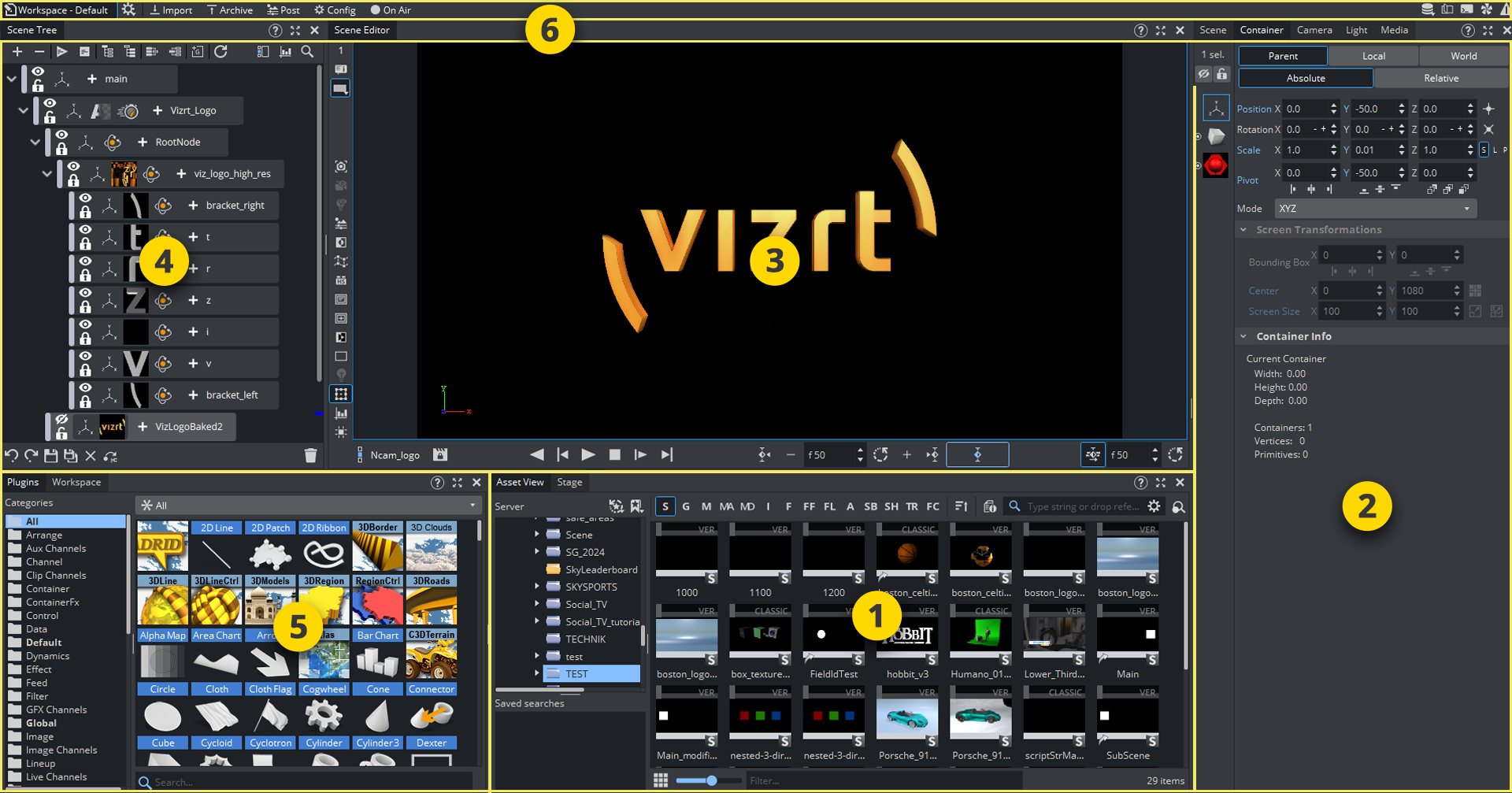

Main Window
When you start Viz Artist, the main window opens after you have logged on. This is the default view:
At the top of the main window is the Main menu bar. Below the Main menu bar is the display area. The content of the display area changes according to selections made in the Main menu.
You can move, dock/undock or resize the panel areas to accommodate your workflow.
At system start (default workspace), the area is divided into four panels:
Fig Item
Panel
Description
1
Asset View
From the Asset View panel, it is possible to browse for items such as Materials, Images, and Fontstyles, as well as search Graphic Hub.
2
Properties
Properties for Containers, Cameras, Lights and Video Clip Playback Considerations are controlled from the Property panel, where size, position and other settings can be modified as required.
3
Scene Editor
A visualization of the Scene is shown in the Scene Editor panel.
4
Scene Tree
Items in the Graphic Hub database can be added to the Scene Tree, which is the logical visualization of a Scene. The Scene Tree is built up of Containers, which can hold items such as Materials or plug-ins.
5
Built-Ins
Shows plug-ins and media assets.
6
Main Menu
Display of views, configuration settings, and import/export.

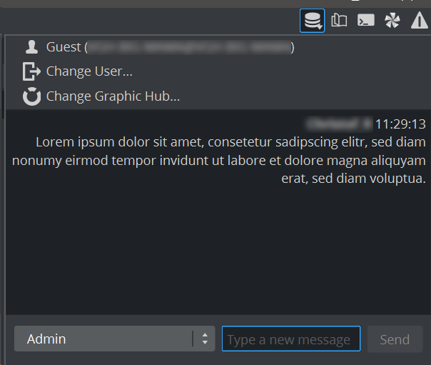

  • Server Menu: Opens the server window. The Server Menu allows communication with other users or other groups as well as changing the current user or the selected database server. System messages (for example, if a shutdown is happening), are also shown, and these messages appear in red.
    Select a logged-in user or a group, type your message and click on Send. To switch your user, click on Change user... and select a new user.
