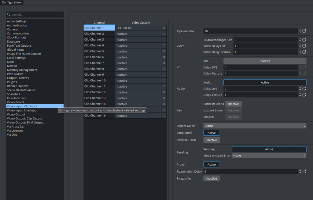

  • The selected video clip must have the same frame rate as the clip channel. You can mix different Output Formats and Video Input Formats with different resolutions, but you must make sure to use either progressive or interlaced for Input and Output. You can play, for example, a 720p clip with an Output format of 1080p, but you cannot mix and 720p with a 1080i format:
    • Video Input: Clip Channel 1: HD 1080i
    • Output Format: 1080i
      Each available Clip Channel can be configured for independent resolutions, providing the designer quick access to a range of options. These settings are configured in the Video Input section in Viz Config. Please refer to the Video Input page in the Configuring Viz section of the Viz Engine Administrator Guide.
  • Make sure that the correct container and codec is selected (see Supported Codecs).
  • Video clip playback can be applied through either DVE or Texture.
  • To be able to use a Live input channel, a Clip channel or a Stream channel, they first have to be set to active in Video Input (see the Configuring Viz section of the Viz Engine Administrator Guide).
  • If alpha is required for a video clip, click Config and configure the alpha in Video Input (see the Configuring Viz section of the Viz Engine Administrator Guide ). Enable w/Alpha when alpha is required in video clips. Either two clips, or one clip that contains both the fill and key, are required. If there is only one clip, that contains the fill (without a key), the key is created dynamically and is fully opaque. For the naming convention of two clips, the alpha/key clip must have the same name with an attached _key before the file extension, this means if the main/fill clip is named example.mxf, the alpha/key clip must be named as follows: example_key.mxf.
  • The Matrox Clip Player supports TDIR (Time Delay Instant Replay), which enables Viz Engine to play back clips while they are still being written by Viz One. When a clip is played, with TDIR support enabled, looping is not enabled for this clip. Viz Engine determines automatically if it needs to set TDIR support on, or if the clip is already fully loaded.

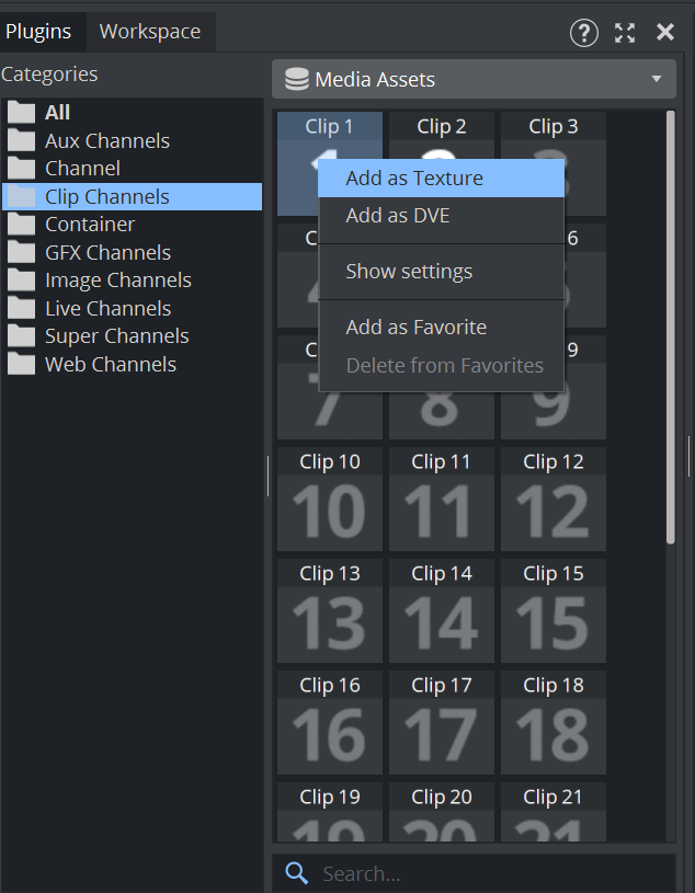

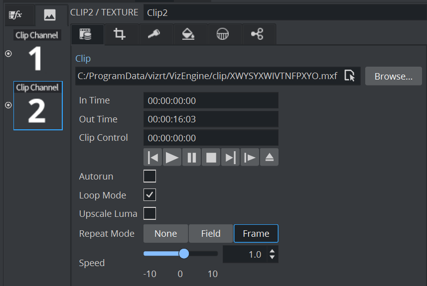

To Play a Video Clip as Clipchannel (Texture)
  1. Click on Plugins / Media Assets / Clip Channels.
  2. Drag one of the available Clip channels to the scene tree or Right-click on a Clip Channel, and select Add Clip<1> as Texture.
    • The Texture button in the Media Asset Manage) is automatically selected.
    • The selected Clip Channel is added to the Scene Tree and a new Container is created (click Tree to view).
Tip: The Clip<1> Channel can be made active or inactive. Toggle the active/inactive button.

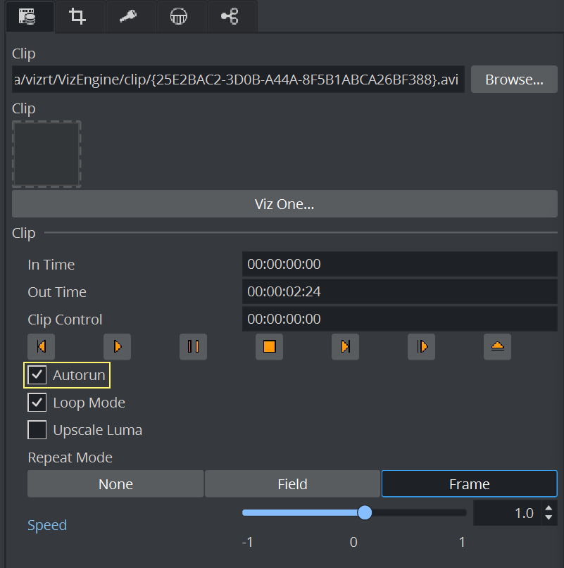

  1. Click on Clip<1> Channel, in the Scene Tree panel (Media Asset Manager) Texture view, to open its properties panel.
  2. Select the required Keying Mode (see Keying Mode).
  3. Add a video clip:
    • Drag a clip from Windows Explorer or from Viz One browser
    • Click Browse..., and select a video clip to import
  4. Configure the video clip playback as required.
  5. Click Play to test the video clip.
Note: To transfer and download videos from Viz One, Viz One must be integrated and configured with Viz Artist/Viz Engine.​

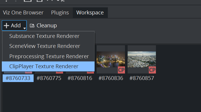

To Play a Video Clip as Texture ClipPlayer
Container-based Clip Playback is mainly used for decoration clips, promos or if the clip dimensions are non broadcast formats. The texture clip player is based on the VML player and supports various formats as well as transparency.
Note: This feature is only available in the Viz Engine Render Pipeline.

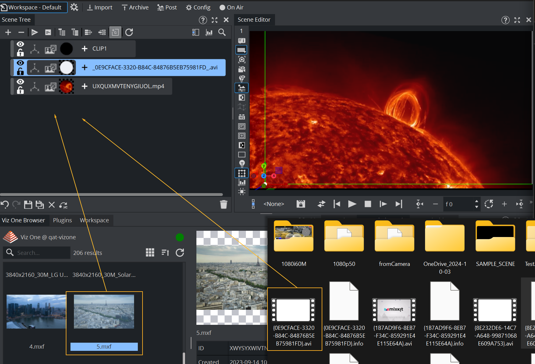

When using the new Viz One browser or if you drag any clip from the filesystem inside the scene editor or scene tree, the ClipPlayer Texture Renderer is used automatically.
Drag a clip from Viz One browser or filesystem
or create it manually:
  1. Open the Workspace Dock.
  2. Click on Texture Renderer.
  3. Add > ClipPlayer Texture Renderer.
  4. Double Click on the new generated Texture ClipPlayer.
  5. Browse or assign a clip file.
  6. Drag the texture to a container.

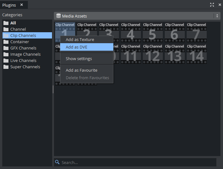

To Play a Video Clip as Clipchannel (DVE, Matrox only)
  1. Click on Built Ins.
  2. Click on Media Assets (MA).
  3. Right-click on the required Clip Channel.
  4. Select Add Clip<1> as DVE.
    • The DVE button in the Scene Tree panel (Media Asset Manager) is automatically selected.

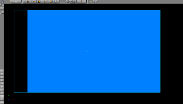

      The Scene Editor shows a blue rectangle, which shows that the live input channel is correctly configured for live video.
  5. Click on the Clip<1> Channel to open its properties panel.
  6. Adjust the parameters in the DVE control panel, as required.

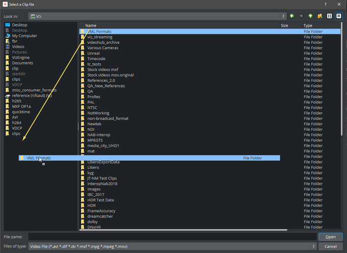

Browsing for Clips always shows the default Clip Root location. If you need to access other locations, you can create an alias inside the file browser dialog. To do so, drag an folder from the right side into the locations area on the left side:

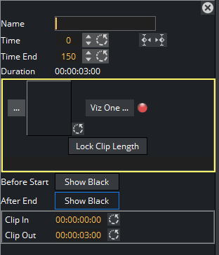

Video Clip Animation in the Stage
Video can also be played out as part of an animation. This is useful when video clips are required to interact with animation.

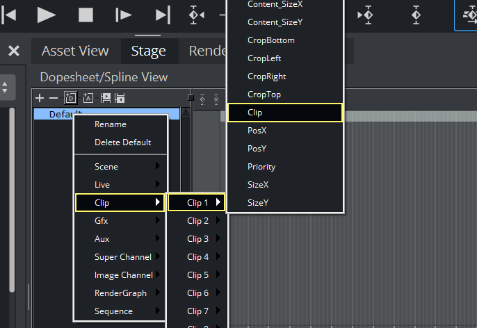

To Animate a Video Clip
  1. Before a video clip can be animated, it must first be applied as a Texture or DVE.
  2. Click Stage.
  3. Click the New Director button.
  4. Right-click on the Director.
  5. Select Clip > Clip1 > Clip
  6. In the Clip1 channel, click in the dark blue area. The Clip Key Frame Editor opens on the far right.
  7. Add a video clip:
    To load a clip,
    • Click to browse for a local clip, or drag a Video Clip item from the Asset View.
    • Click Viz One..., and select a video clip to import.
    • Click Lock Clip Length to specify a certain time/length for your clip. This is useful when loading clips from an external control application via Viz One. In this case, the lock clip length acts as a placeholder, but does not change the clip length automatically after loading.
  8. Configure the Clip Key Frame Editor as required.
