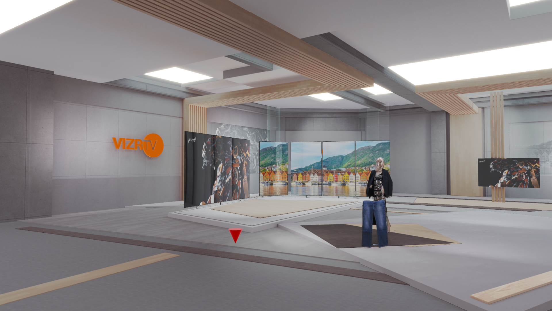

Virtual Studio

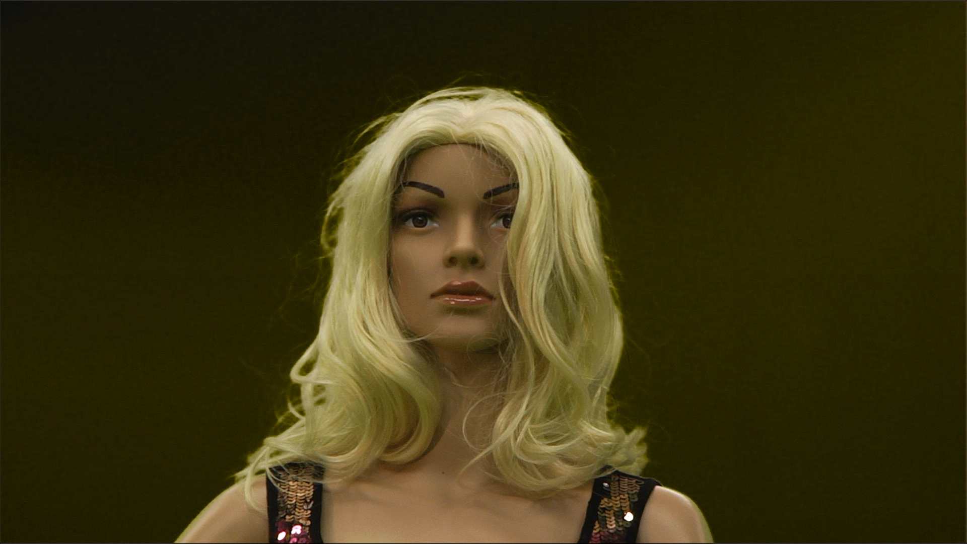

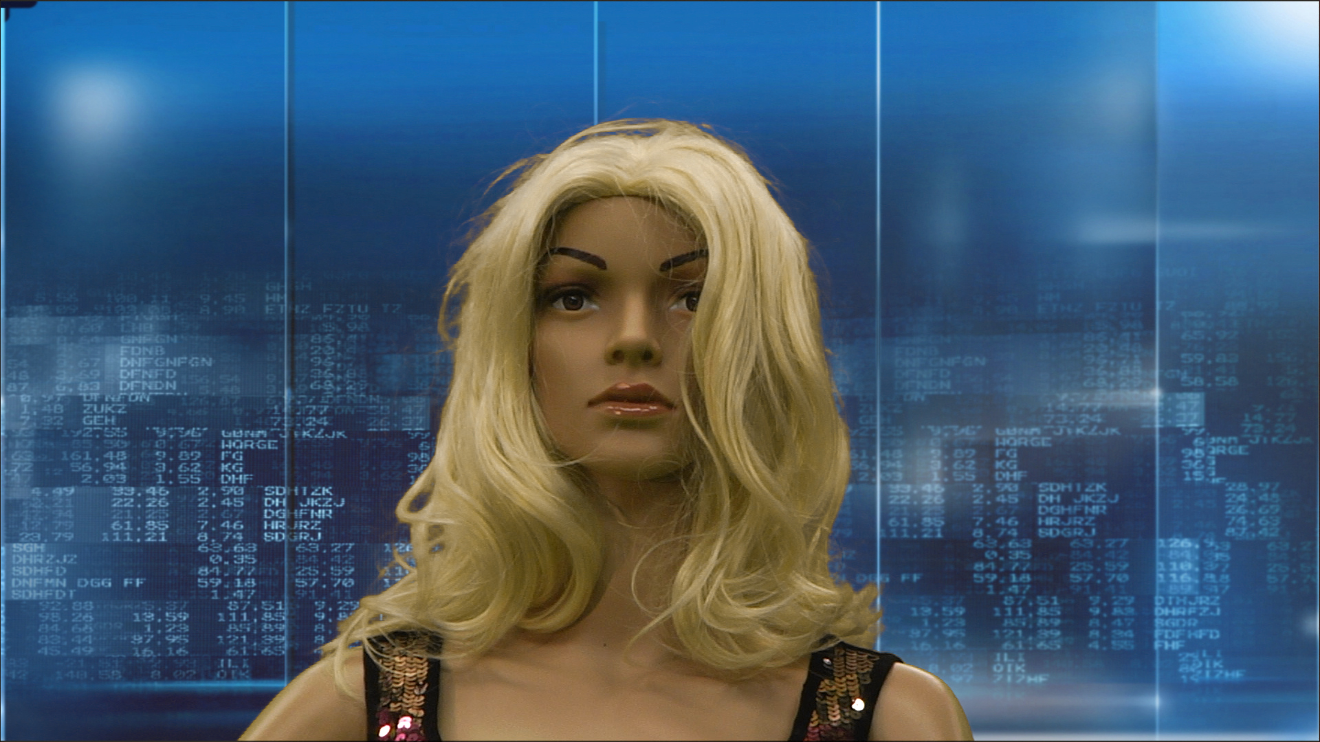

Live input as FOREGROUND asset

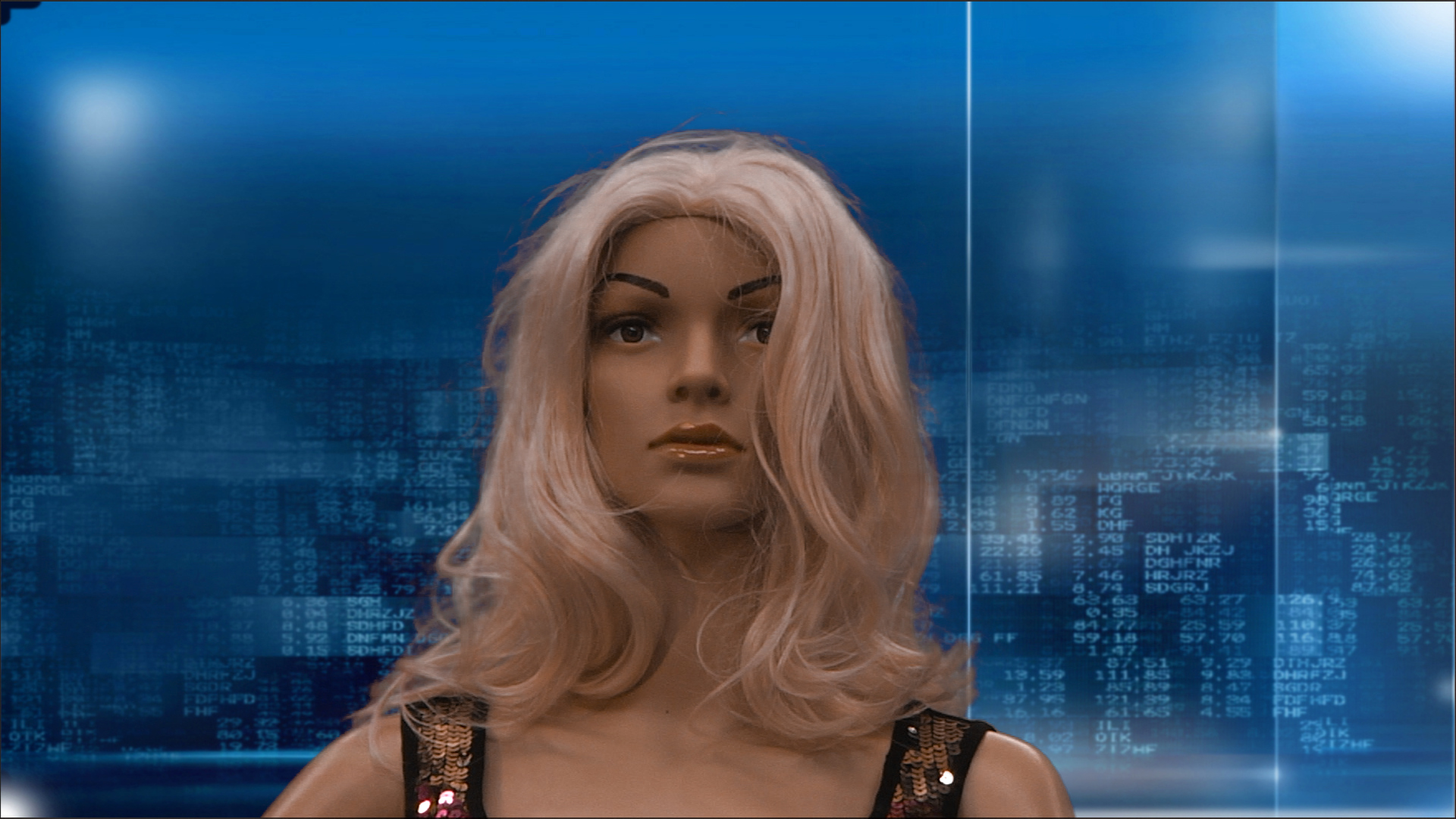

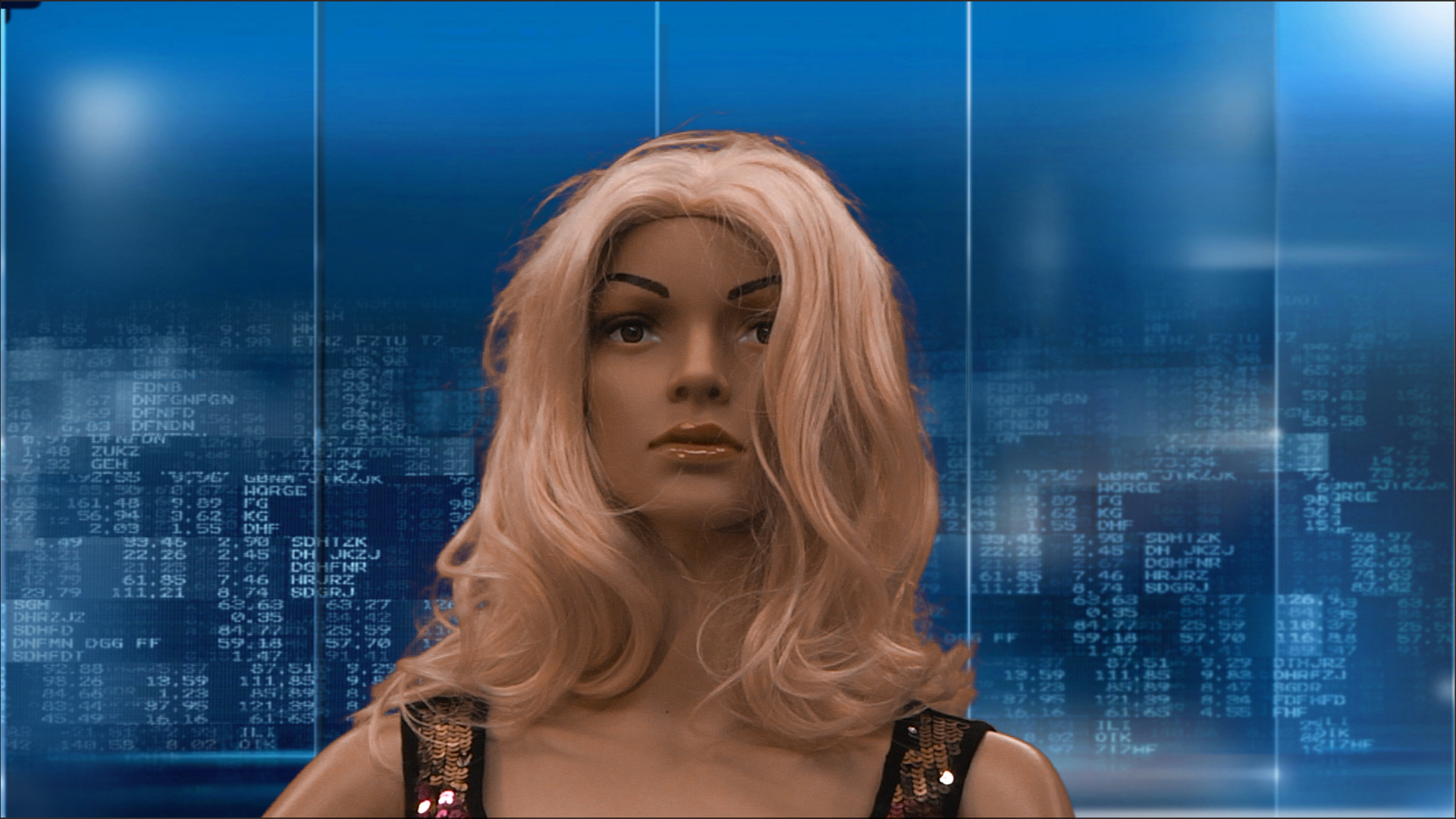

Result with configured the Precision Keyer

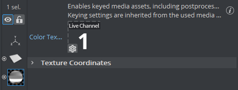

Key Textures in Scene Tree

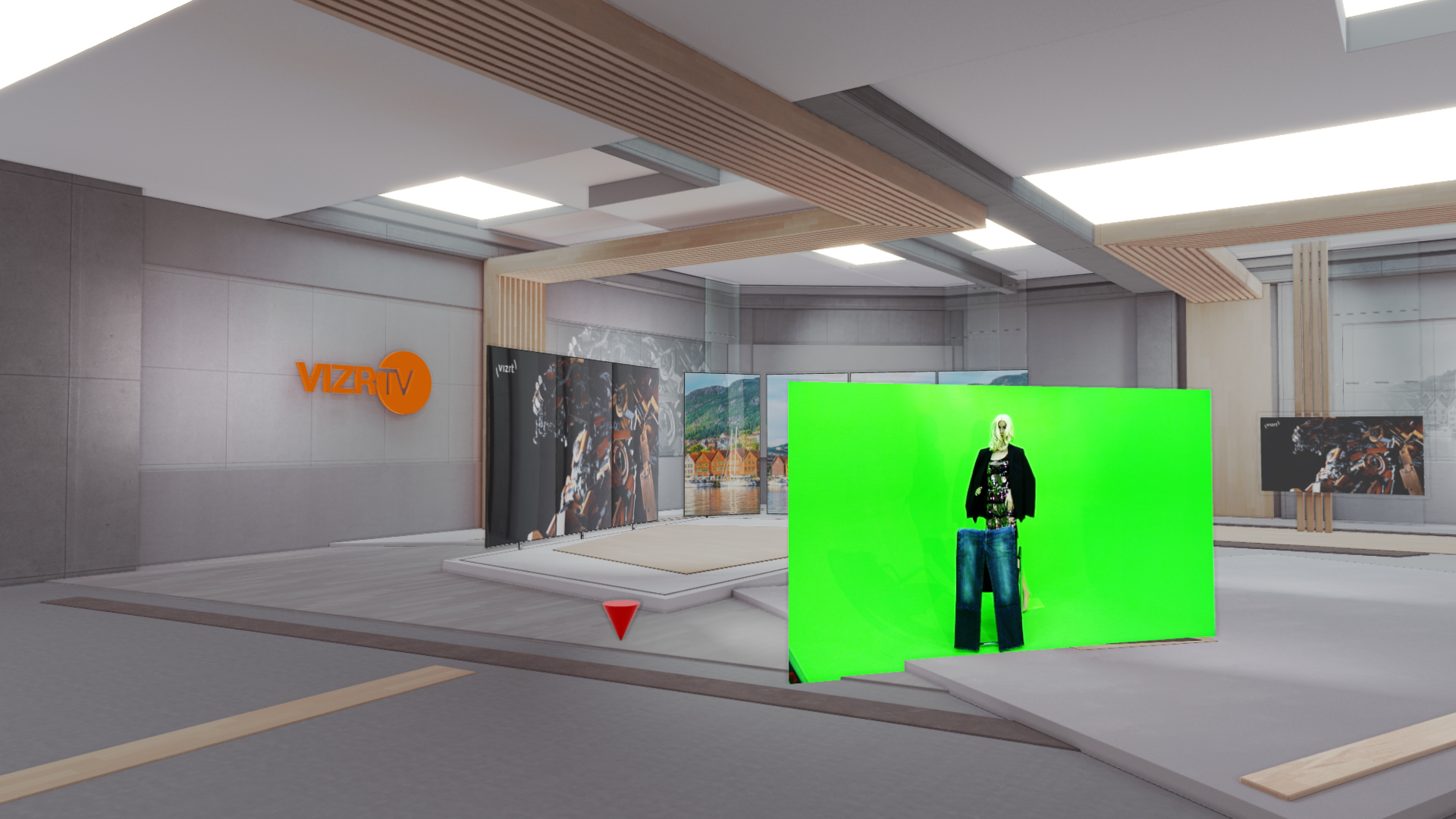

If used within the scene, use a container with a geometry and add a RenderSystemMaterialPrecisionKeyer. Drag the used media asset on the color widget of the material. The Keyer must be enabled on the asset (for example, Live1).
Additionally, the texture coordinates can be manipulated. See Texture Generation for more information.
Virtual Studio
Live input added as texture in the scene

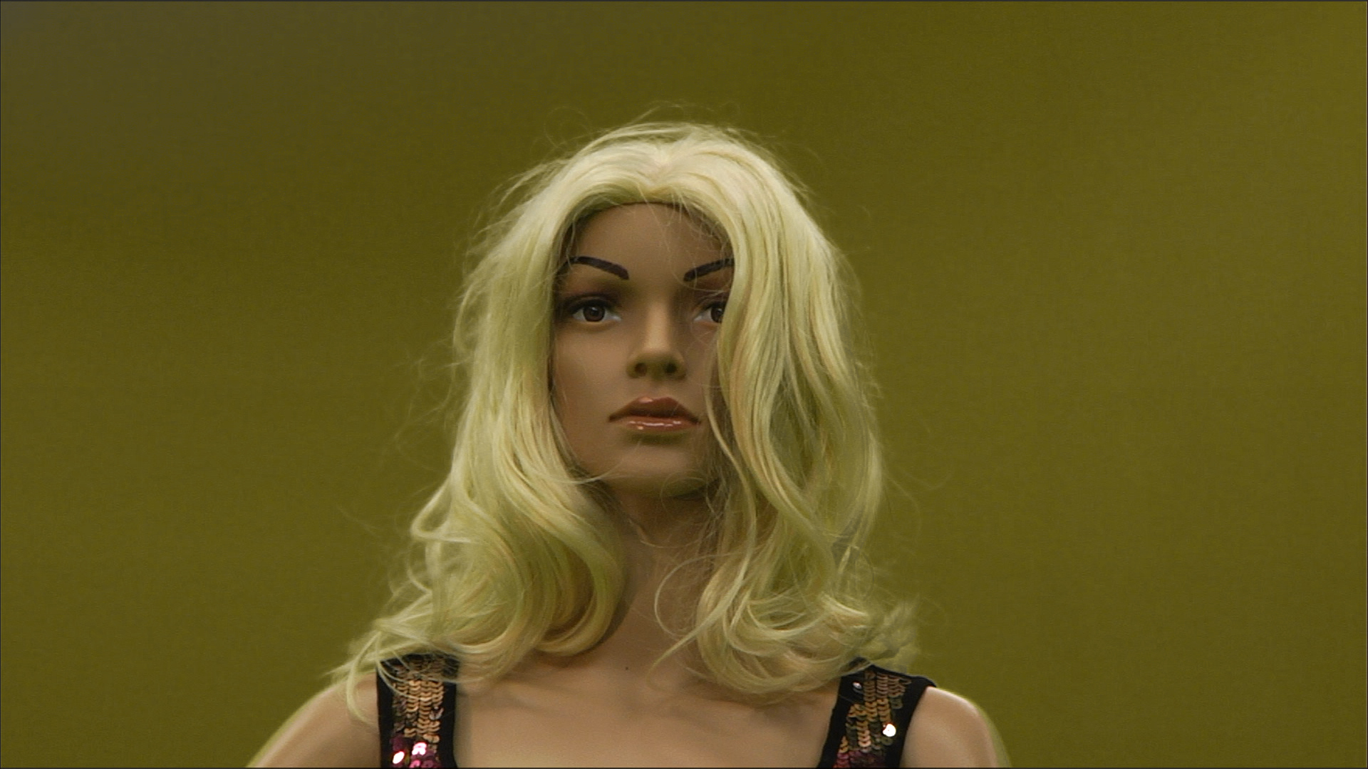

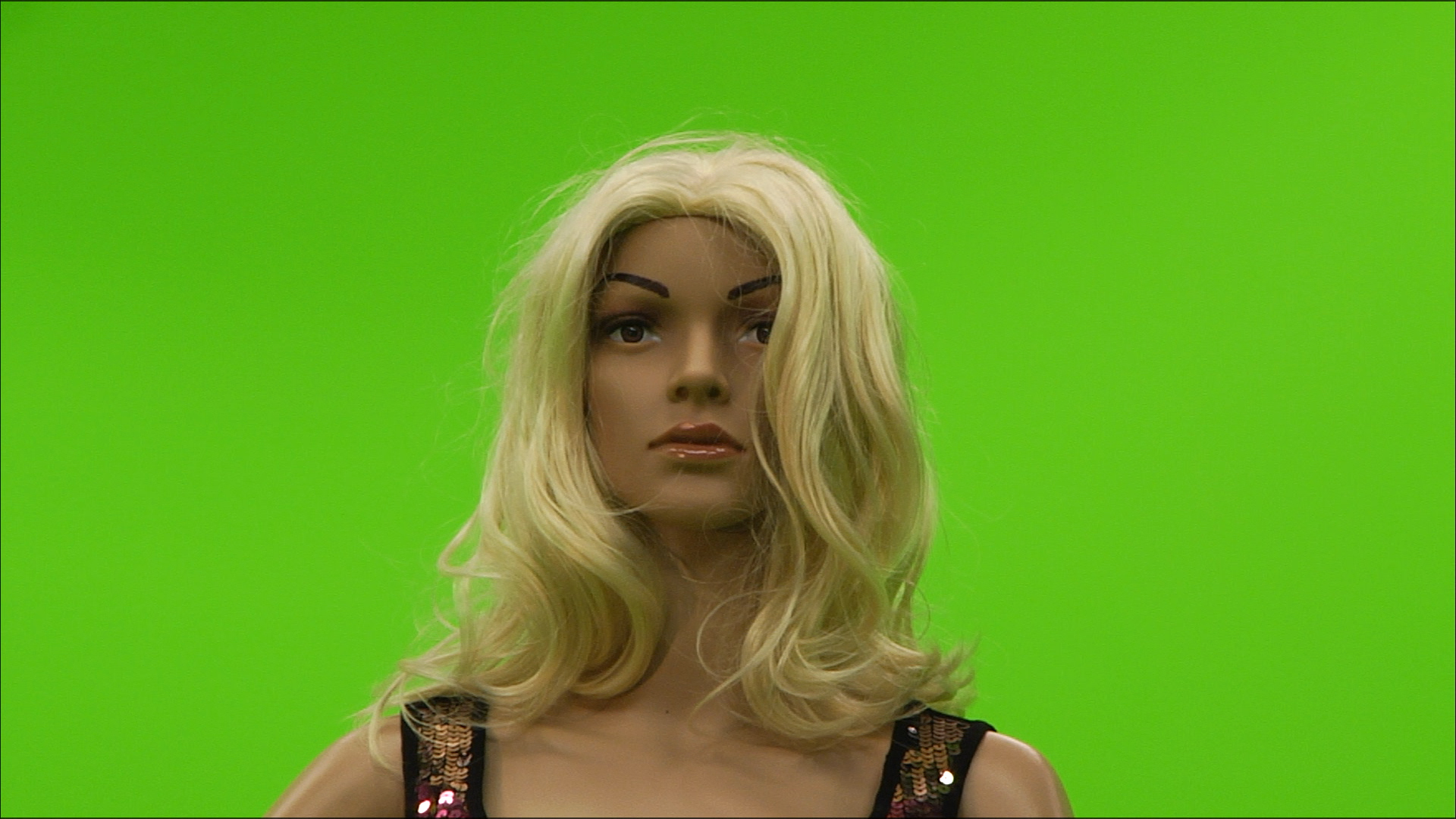

The Keyer works best if the background is perfect green (RGB(0, 255, 0)) or perfect blue (RGB(0, 0, 255)). As this is not what we have in most real-world setups, you need to color-shift the input signal until you get perfect green or perfect blue.

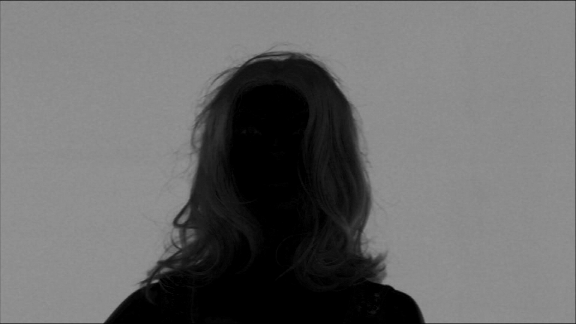

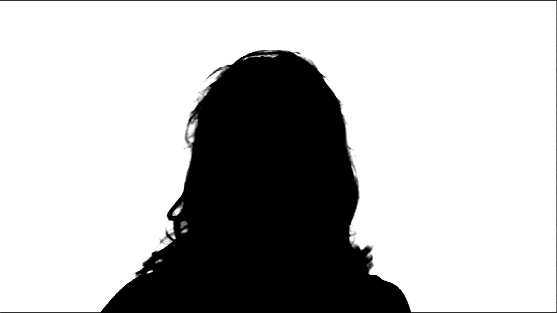

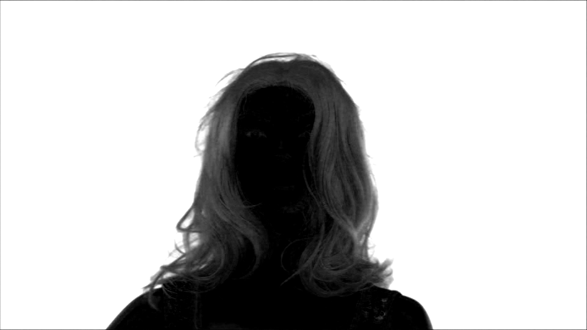

Enable the Matte view and adjust the hue shift until you have the maximum of contrast you can get. In perfect scenarios, this would mean that you get a full white background, and a opaque black foreground. Depending on your lighting situation, you will not get perfect white and black on the matte view, this is handled in the next steps. Try to find the hue shift which is the best you can get now, and use 100% for the white point (Transparency) and 0% for the black point (Opacity) to see the unscaled values while adjusting the hue shift.
Input Signal
Matte Before Hue Adjust
Matte After Hue Adjust

After the hue adjustment, we should adjust the white point. This scales the input values so that the background is fully keyed (full white on the Matte view). Start from 100% and reduce it until the background is fully white, Do not reduce it more as necessary, as it would start remove details at the border of the foreground.
Now we need to find the black point, which scales and shifts the input values so that the foreground is fully opaque. Start from 0% and increase it, until your foreground is fully opaque. Have a look on details and borders and do not increase it more as necessary.
Matte Before White Point Adjustment
Matte After White Point Adjustment
Matte After Black Point Adjustment

Input Signal
Processed FG before RGB Adjustment
Processed FG after RGB Adjustment (0.345, 0.713, 0.078)

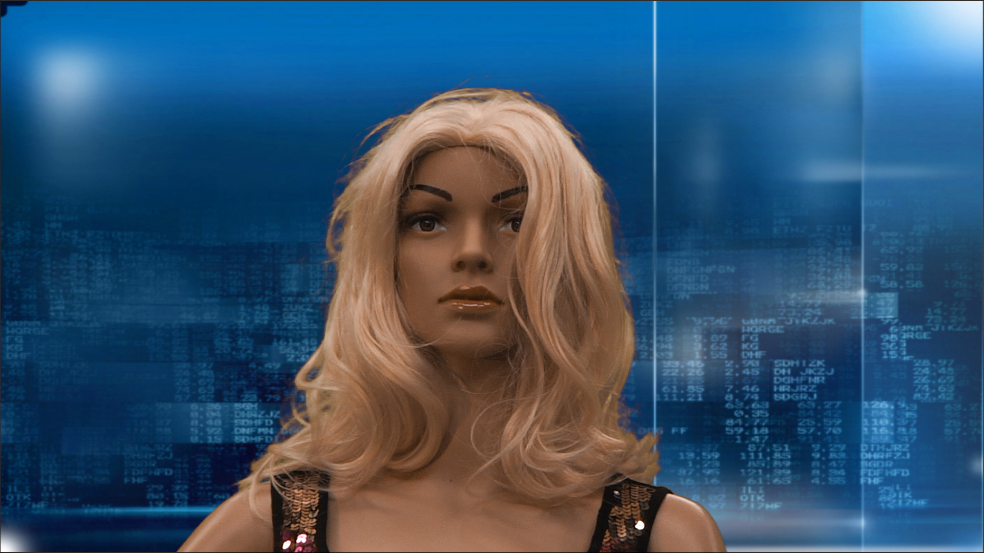

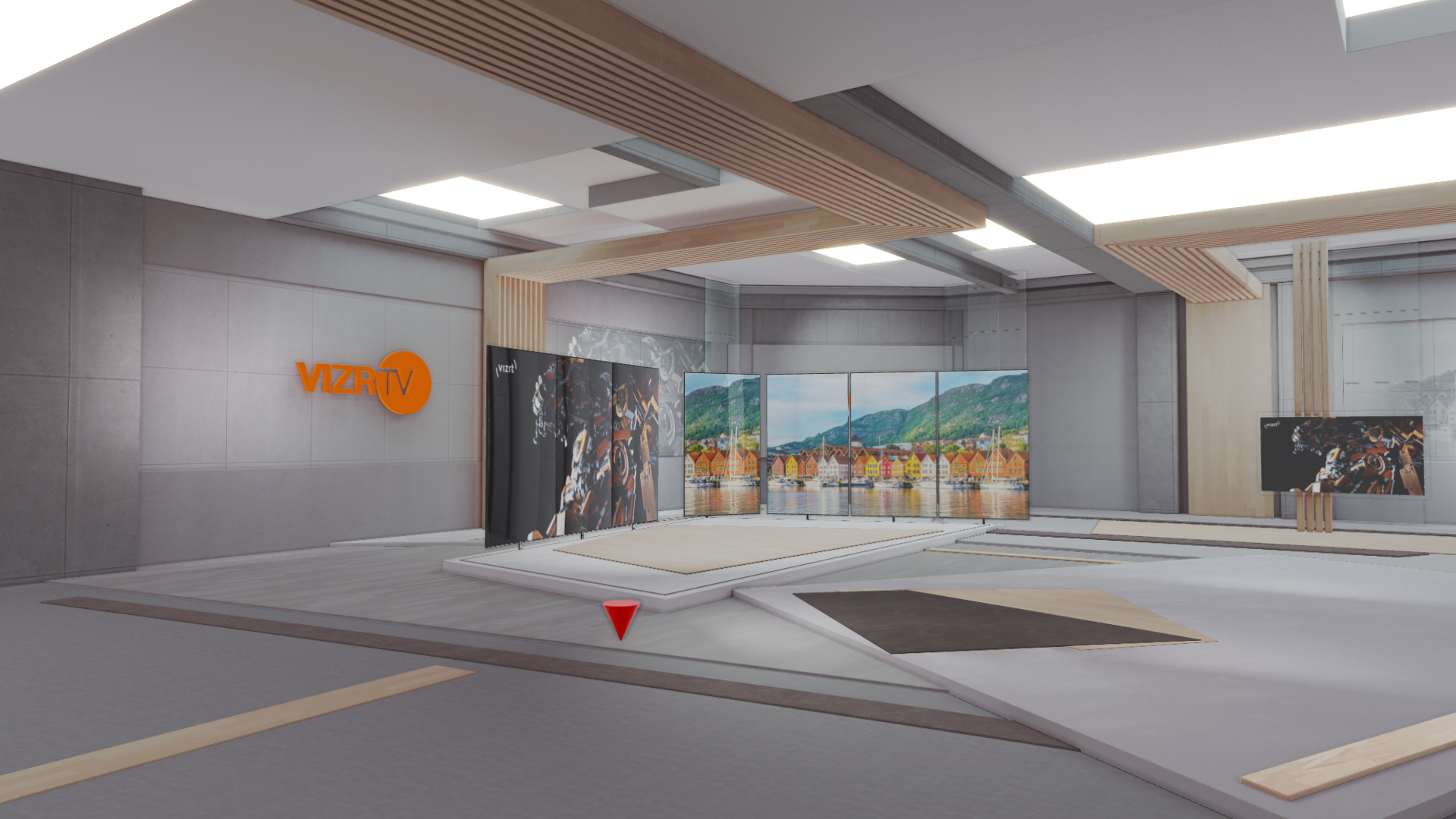

Final Result
Now add a background or your Virtual Studio and check the result:

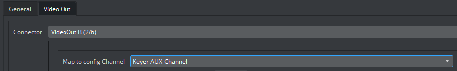

Since Viz Engine version 5.3, these textures can be shown in parallel on a separate SDI outputs. To enable this feature, map one of the video connectors to the config channel Keyer AUX-Channel.
If one of the connectors is mapped to Keyer Aux-Channel, the Aux Output of the Keyer is sent to this output by default (instead of the Program output). This can be overwritten with commands:

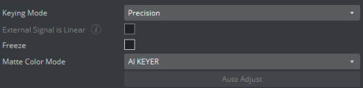

AI Keyer Color Mode
Important: The AI Keyer Greenscreen-less license is necessary to use this feature.
The Precision Keyer settings now support AI Keyer Matte color mode.
AI Keyer and Keying Licensing in Viz Engine
  1. No chroma Keying license, no AI Keying license.
    1. Keying mode is inactive.
    2. AI Keyer color mode is not possible to set and returns a missing license answer. We still get key signal (as its embedded to RGBA texture), but extra control of Precision Keyer is not possible.
  2. Chroma Keying license available, no AI Keying license.
    1. Keying mode Precision is possible. Precision Keyer color mode of GreenScreen, BlueScreen and External Matte works, other keying modes also work.
    2. AI Keyer color mode is not possible to set, and returns a missing license answer.
  3. No chroma Keying license, AI Keying license is available.
    1. Keying mode Precision is possible. Precision Keyer color mode of GreenScreen, BlueScreen and External Matte do not work, other keying modes do not work.
    2. Precision Keyer Color Mode of AI Keyer works, and edge/blur/light wrap properties of Precision Keyer can be applied on AI Keyer. ProcessForground needs to be disabled.
  4. Chroma Keying license available, AI Keying license is available.
    1. Keying mode Precision is possible. Precision Keyer Color Mode of GreenScreen, BlueScreen and External Matte works, other keying modes also work.
Commands to get and set Keying Mode, and Matte Color Mode:
send MAIN_SCENE*VIDEO*VIDEOIN*3*KEYING_MODE SET/GET
send MAIN_SCENE*VIDEO*VIDEOIN*3*KEYER_COLOR_MODE SET/GET
