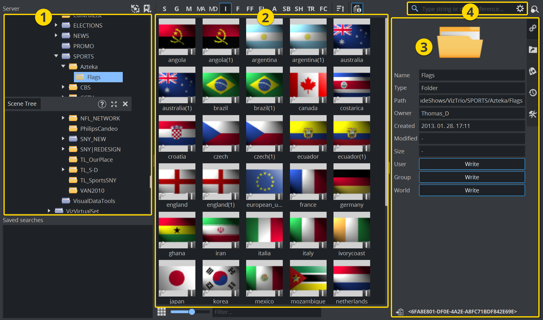

Asset View Window
The Asset View window is split into the following parts:
  • Server Tree (1): Manage files and projects on your Graphic Hub.
  • Items View (2): Browse and view your available items.
  • Properties (3): An even more detailed view on your assets and a set of tools.

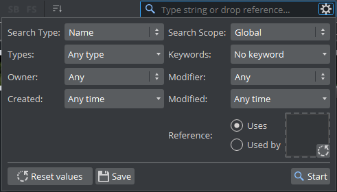

  • Search (4): A powerful search tool to find the items on your Graphic Hub.
Server Tree
The Server Tree shows a structured representation of your Graphic Hub. It has the possibility to create projects and folders, so anyone can organize assets matching various needs.
There are two types of folders:
  • Regular folders
  • Project folders

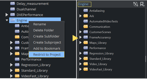

The difference between a regular folder and a project folder is that by defining a working project, the tree can be collapsed so that only the currently selected project and its sub-folders and sub-projects folders are shown. A project can contain various folders, but a folder cannot contain projects. To restrict the view to your current project only, right click on your project folder and select Restrict to Project.
This allows to see only the relevant structure of your project, while search functionality and others are still available. The current select project is shown on the top of the server tree. To switch back to the original view, right click in the scene tree and select Remove restriction or click on the light blue colored project name on top of the tree (Engine in the sample above).

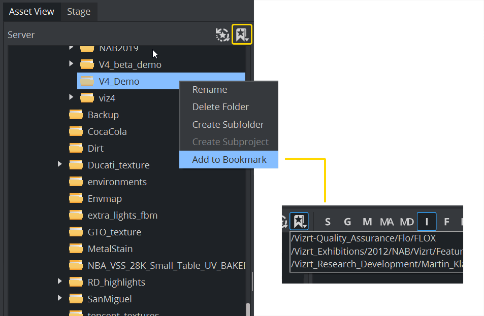

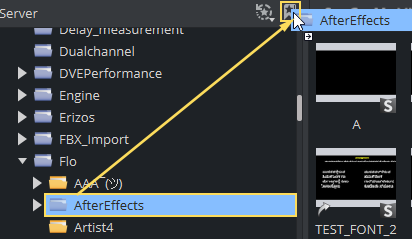

Working with Bookmarks
To provide quick access to the most important folders or projects, they can be bookmarked to speed up navigation. Bookmarked folders are added to the Server Tree Bookmark context menu. Right click on a folder or project and select Add to bookmark. This adds your favorite into the bookmark drop menu on top of the server view:
Bookmarks can also be created by dragging a folder to the Bookmarks Icon.
Bookmarks can be deleted by opening the bookmarks menu and clicking on the small trashcan next to the item. Bookmarks are sorted alphabetically by their full path.
Information: Bookmarks are stored on a per user level on Graphic Hub. If multiple users use the same login (for example, Guest) Bookmarks will be mixed up.

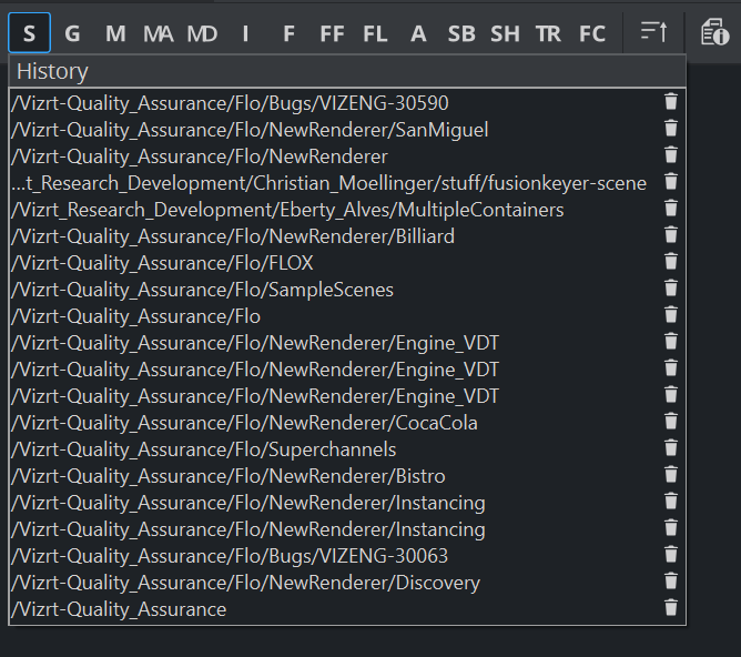

History
The asset view automatically adds up to 20 folders and project locations into a history once an asset has been used from within that folder. This applies to actions (like an item has been deleted or double-clicked, renamed, dragged into the scene tree and so on). Whenever an action happened within a folder or project, it is added to the history list. This history is available at the top of the server tree.
Information: History is stored on a per user level on Graphic Hub. If multiple users use the same login (for example, Guest) history entries are mixed up.

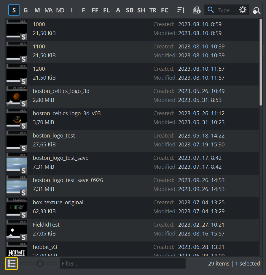

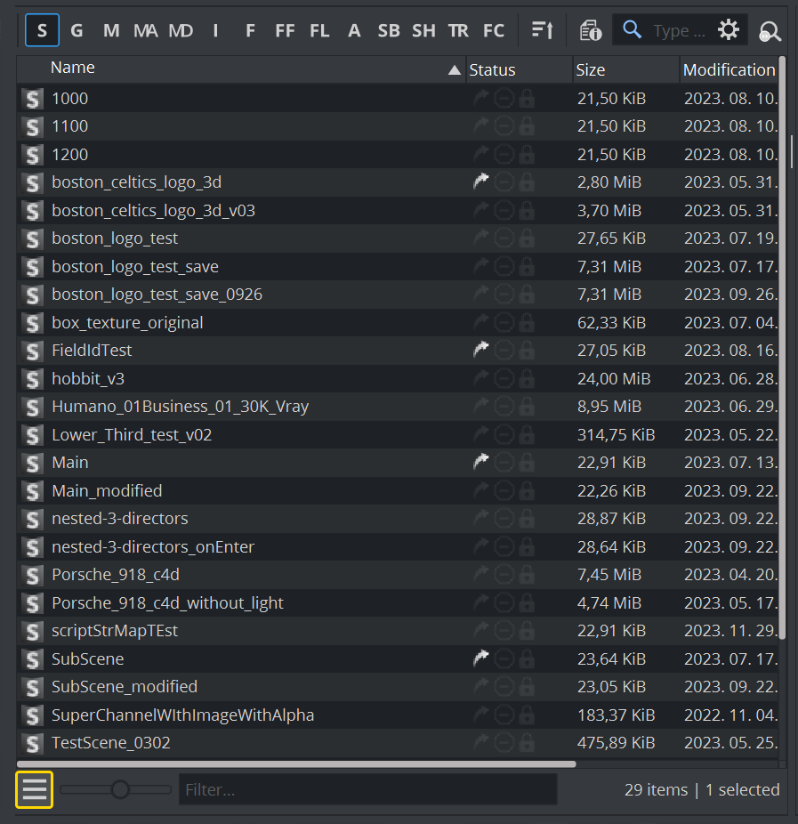

The content of a selected folder or project is shown in the Items view. Items can be represented as icons, list or details view.
Icon View
Note: The size of the icons can be changed by using the slider, the configured keyboard shortcut (default CTRL + + and CTRL + -) or by using CTRL + Mousewheel.
List View
List View with Details
Information: Columns can be shown/hidden by right clicking on the column bar. Columns can also be resized and reordered. Clicking a column header sorts the list according to the selected column.
By using the slider on the bottom, you can choose the size of your icons in Icon view. Once you switch to list view, this option is disabled. Since Viz Artist version 4.4, the creation time is also shown.

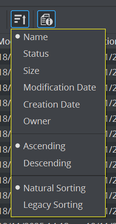

Sorting and Filtering Items
image-2024-7-31_10-20-24.png You can sort how items are being displayed by using the sort icon next to the Content switcher. Then you can sort by Name, Modification Date, Creation Date, Size and in both Ascending and Descending order.
In the Details view the same can be achieved by clicking the corresponding column header. Clicking the header again changes the sorting order.
Underneath the Items view, there is an input field for doing a quick filtering on your items. The filter applies to any part of the filename. As an example, if the content switcher is limited to images and given that your items follow a certain naming convention, you set a filter to "normal", it only shows the normal maps within a folder:
The name and the UUID of any item are taken into account.
Natural Sorting vs Legacy Sorting
Viz Artist uses Unicode collation algorithm for sorting items within a folder. If you prefer the old behavior (like Graphic Hub Manager does), switch to legacy sorting. Legacy Sorting means that, for example, items starting with an underscore (_) are listed first.
Natural Sorting
Legacy Sorting

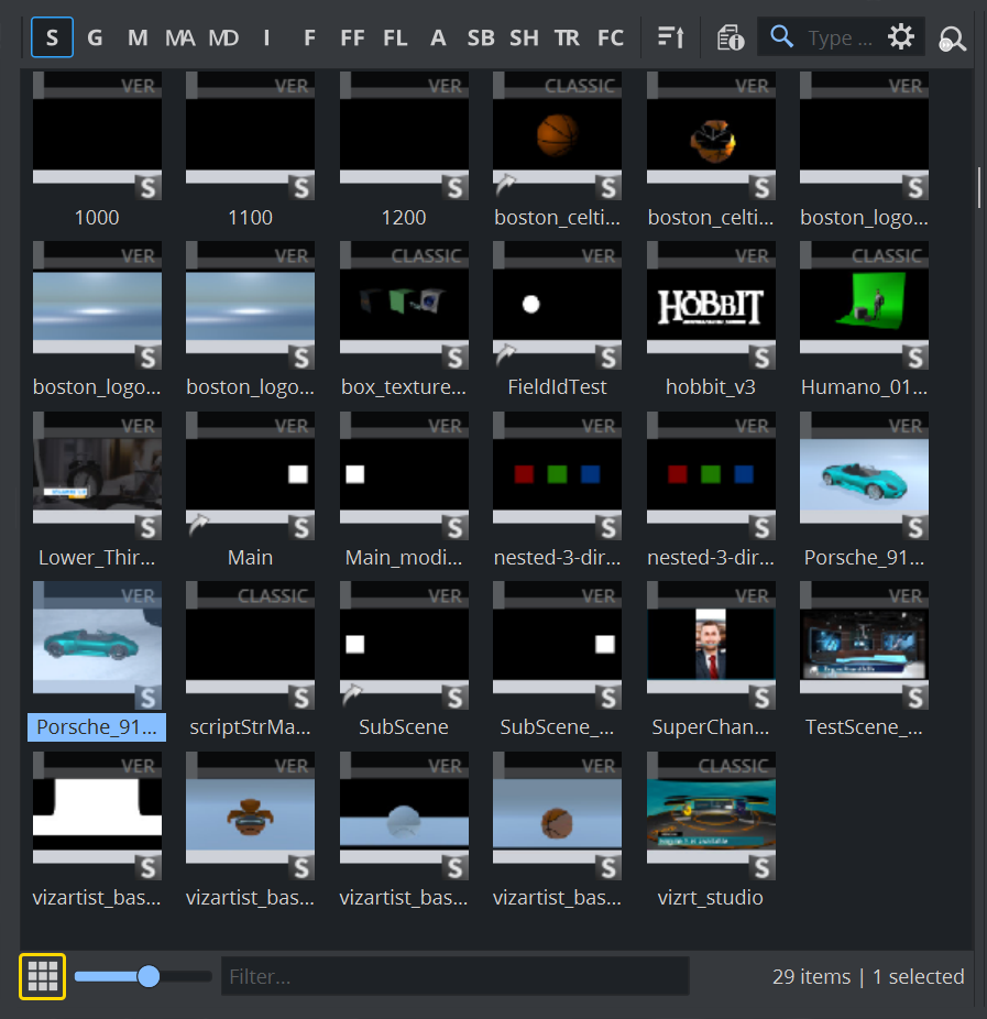

Content Switcher
Folders can contain various types of items. To view only a selected type of items, contained in a folder, click an item type tab from the Content Switcher. This also allows multi-selection while holding the CTRL key while clicking on it. If you want to see all of your items, click on any previous selected item, so no one is selected. This replaces the old All tab.
Media Types which are currently not available in the selected Render Pipeline will be disabled.
Content Switch to Show only Scenes in the Viz Engine Render Pipeline
Content Switch to Show All Material Types in Classic Render Pipeline
Content Switch to Show All Types in Classic and Viz Engine Render Pipelines

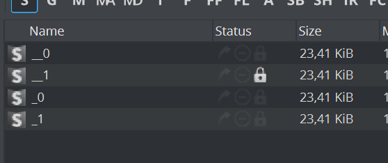

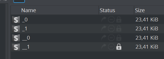

Locked Item
If a user connected to the database opens an item, the item is locked for all other users and marked with the locker icon. A locked item means that the item can be opened and viewed by all users, but only modified or saved by the user that has locked it. The item is unlocked when the user closes the item or disconnects from the database.
Checked out Item
If a user connected to the database checks out an item, the item is locked for all other users and marked with the stop icon. A checked out item means that the item can be opened and viewed by all users, but only modified and saved by the user that has checked it out. To cancel the check out, the item must be checked in.
Any item can be checked out within Viz Artist by using the context menu and selecting Check out or Check in.
The item remains checked out (locked) even if the user closes the item or disconnects from the database.
Locked and Checked out Item
For a locked and checked out item, the icon represents a combined keyhole and stop sign.
It can be opened read-only but not modified unless unlocked and checked in again.

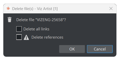

  • Items can be deleted by either selecting Delete... on the context menu or by hitting the DELETE key. In addition, you can drag any item to the trash bin to delete it.
If you perform a delete operation on an referenced item, an additional option With all references is available. This removes all references of this file from Graphic Hub. A regular delete operation only deletes the reference within the current folder.
The Delete all links option also removes all Folder links of this object.
Note: Referenced items are deleted if they are referenced to ONLY the selected item. If they are also referenced to others, then they are not deleted. File Collections are ALWAYS deleted with all references. As the operation to resolve a lot of references takes some time, please be aware that deleting File Collections can require a lot of time!

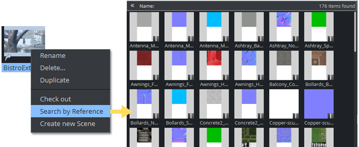

To search for references item, please see Searching for References.

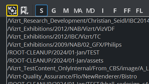

Location History
Asset view keeps a history of each location where a certain type has been used. This can be shown by CTRL+ right clicking on one of the tabs. For example, if you CTRL + right-click on the S tab, a history of the last 20 locations where an item of type Scene has been modified are shown.
To remove this browsing history, click on the small trash can next to the entry.

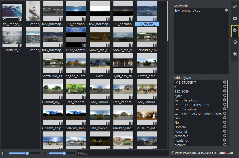

Hot folders are a kind of history items, but bound to a certain type of item. For example a folder with all your environment maps (images) can be set as Hot Folder. This allows to quickly jump to this folder and set the view to Image. To do so, right click on the folder you want to remember and the type of your item and choose Add as Hot Folder.
You can then quickly jump to your Environment maps by right clicking on I and select your Hot Folder location.
To remove Hot Folders, click on the small trash can next to the entry.

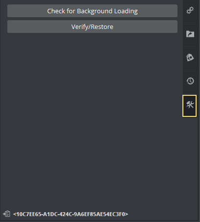

Properties

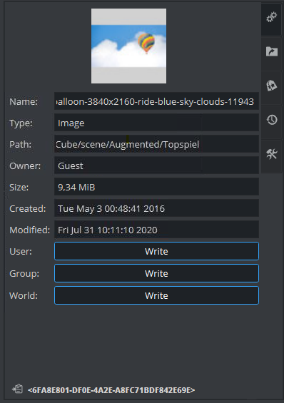

The Asset view offers a side panel which shows detailed information about an item. Click on the image-20240917-125840.png button to show or hide the panel.
General
The general tab shows basic item properties. On top a large preview icon is shown.
  • Name: Shown underneath it, you can copy the name, but you can not modify it here. To rename an item, see Renaming an Item.
  • Type: Shows what kind of asset you selected.
  • Path: Shown underneath. The location of the item. Please keep in mind, that a linked item can appear in multiple locations. The path shown here is the currently selected one on Graphic Hub. If an asset from the Search result is selected, then it is the first folder link, otherwise the exact path of it.
  • Owner: Shows the active user that owns this item. For more information about user and group management, see User and Group Management in the Database Management section of the Graphic Hub Administrator Guide.
  • Size: Shows the actual size of the selected item in Graphic Hub. Items on Graphic Hub have different sizes than for example the same file on your hard drive (images on Graphic Hub contain additional data like mipmap levels, preview icons, etc.).
The two date items shows when an item has been created and when it was last modified. Since Viz Artist version 4.4, the time is also shown. Permissions can be changed on User, Group and World level.
  • User: User may overwrite their files and create files.
  • Group rights: User can overwrite files which belong to the group they are a member of.
  • World rights: User may overwrite files which belong to anyone.
On the bottom, the UUID of the item is shown and be copied to the clipboard with the small clipboard icon.
Tip: The UUID of any selected item can also be copied to the Clipboard by using the CTRL + U shortcut.

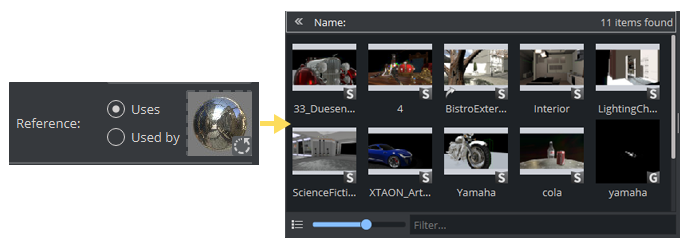

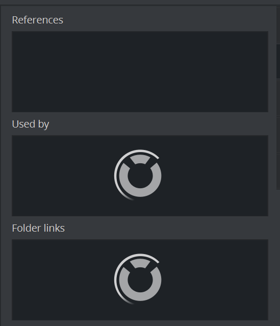

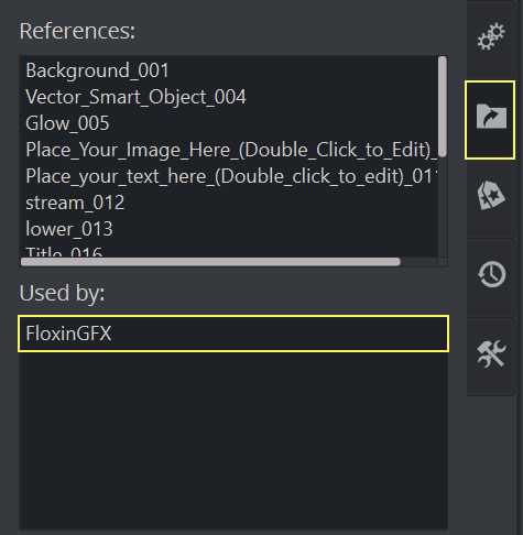

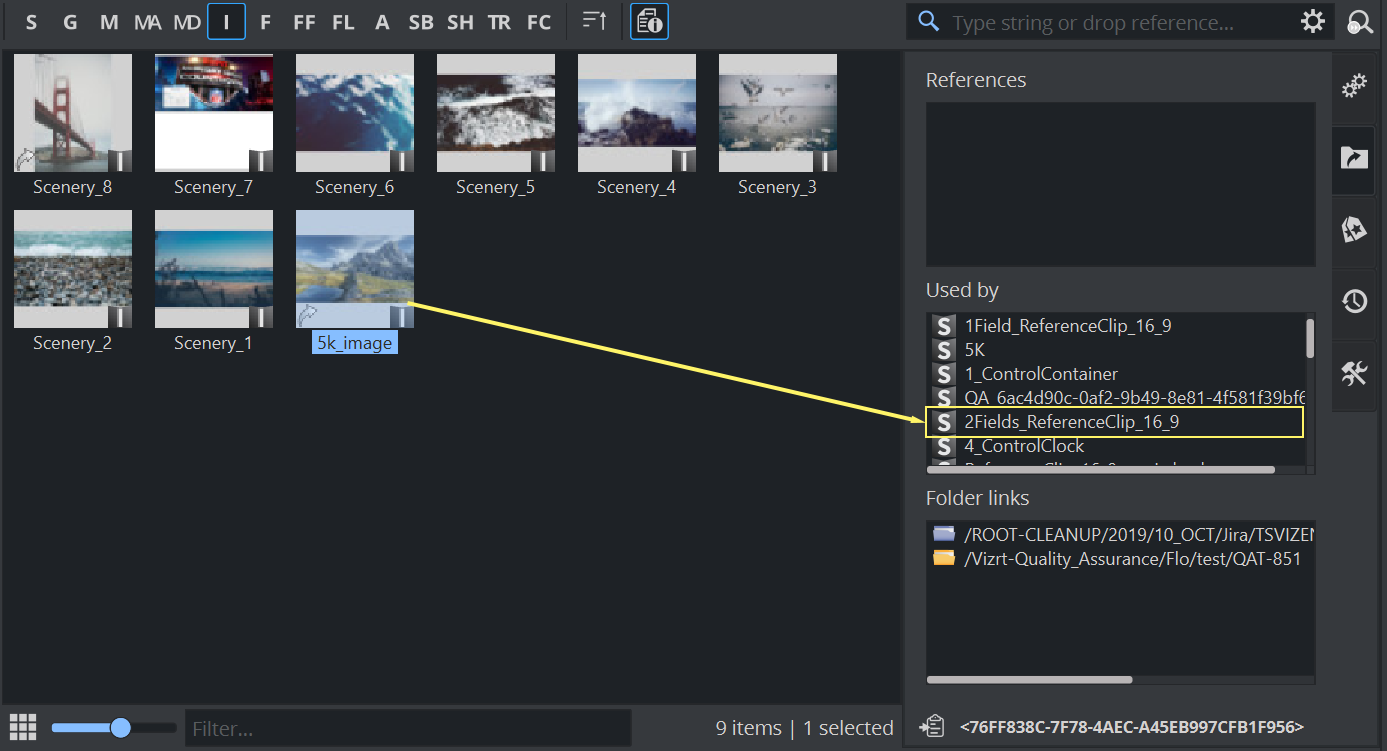

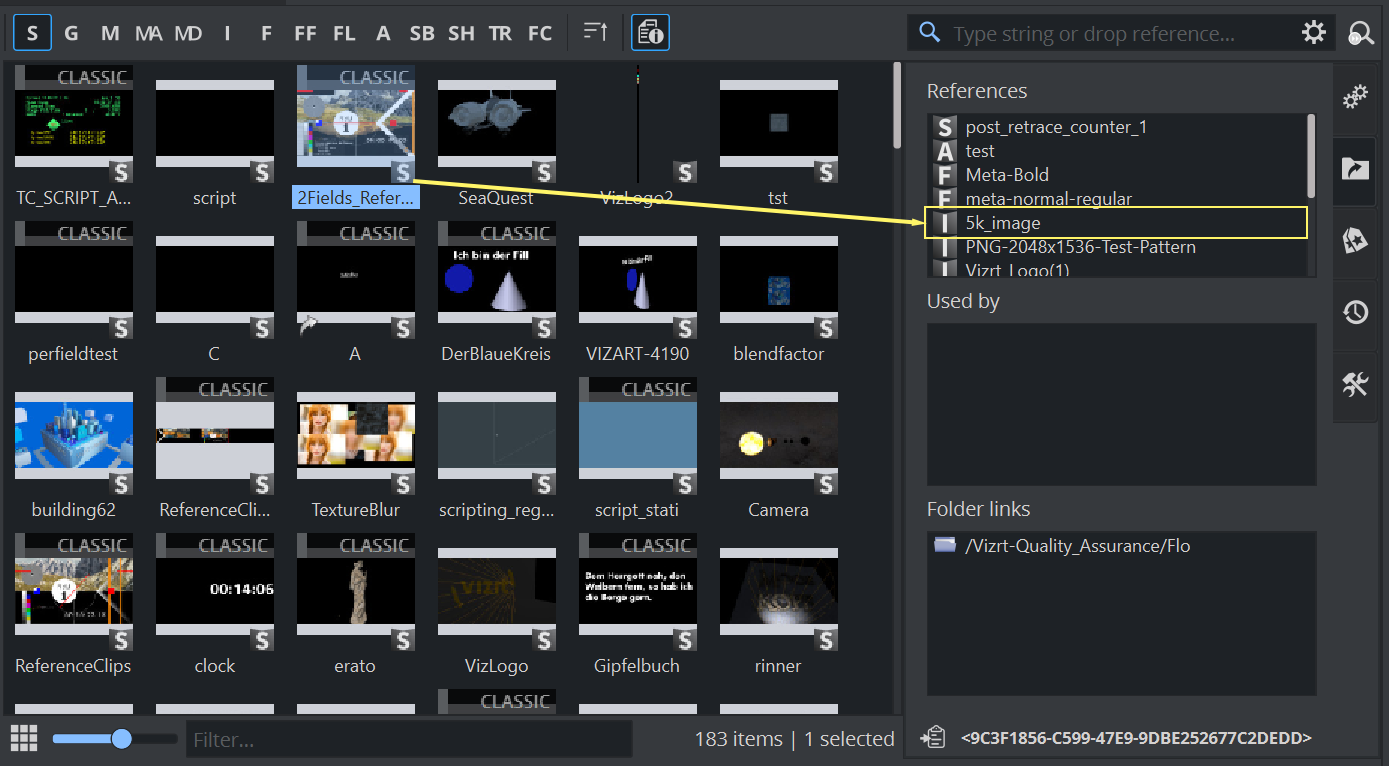

The Links tab shows the links that are assigned to the selected item. There are two different types of links. References and File links.
  • References: Contains all items an item consists of. For example, a scene contains of various Images, Fonts and Geometries. All of these belong to that scene are references.
  • Used by: Represent the location the item is being used. This can be for example a scene, a merged geometry etc.
  • Folder Links: Represent all locations this item is placed on the Graphic Hub.
Information: Some files can have quite a lot of References or File/Folder links. While retrieving this information, a spinner is shown:

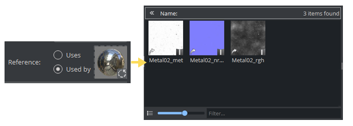

Example: The selected 2Fields_ReferenceClip_16_9 scene has various references. One of them is an image called 5K_image. If you select the 5K_image entry in the reference list, the asset view jumps to first location (if the image is linked) and shows the file links this image has also be used.
This shows shows all other objects that use this image. One of these File links is the scene ReferenceClip16_9. If you click on ReferenceClip16_9 in the File Links list, the asset view would jump back to the location this scene is stored in or as in this example back to the first explanation image. A detailed explanation on how to search for reference can be found chapter Searching for References.

Keywords
Keywords can be assigned to all types of items. They can be useful for example to categorize or label your items. Keywords can also be used as a search criteria.
To assign a keyword to your selected item, either double-click on the keyword you want to assign or click the small + sign. To remove it, do the opposite.
Tip: Use Graphic Hub Manager to create and manage your keywords.

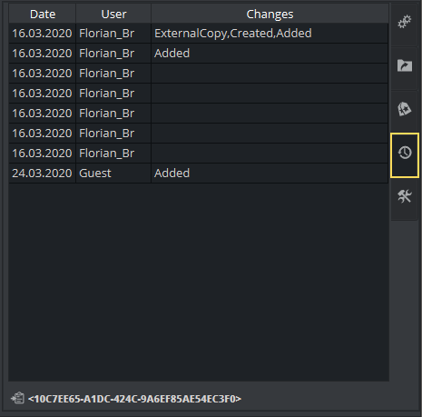

History
Graphic Hub stores a simple history of what has happened with your items. When a assets has been created or imported, modified etc. This is useful if you need to know who modified or imported something.

Special tools can be found in the Advanced section.
  • Check for Background Loading: Checks if the selected item is suitable for Background Loading. A message box opens and shows if the item is suitable, or shows why the item is not suitable.
  • Verify/Restore: Locates, verifies and attempts to correct a corrupted item.

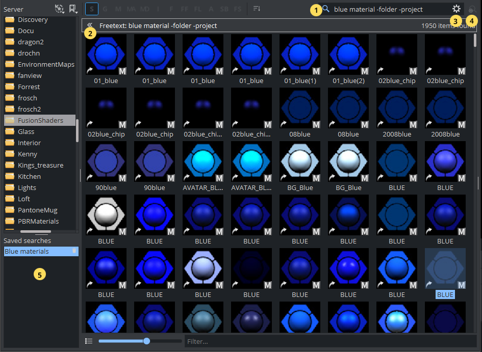

Searching for items has been unified in Version 4.3. There is no longer a split between normal search and the freetext search and the options have been reduced to a minimum.
The following widgets are important for finding items on Graphic Hub
  • Search Field (1): Defines the search term.
  • Result Bar (2): Shows what query has been executed and the number of search results.
  • Advanced Properties (3): Displays additional options for more precise queries.
  • Show last search results (4): Allows to quickly jump to the result so your last search.
  • Saved searches (5): Shows a list of saved search queries.
Search results are shown inside the Items View. On top of the view is the results Bar. This shows what search result is being displayed. For example Freetext: or Name: followed by the search term. On the right side, the number of search results is shown.
To switch back to the basic Items view, click the button on the left side.
To switch back to the search result.
Search results can be saved, so it is easy to quickly recall them. They are listed in the Saved searches Panel. If not needed, the panel can be moved to the bottom.
To save your search, open the advanced panel and click on the image2021-6-2_14-8-49.png button. Items can be removed again by clicking on the trash bin icons.
Information: Search queries are stored on a per user level on Graphic Hub. If multiple users use the same login (for example, Guest) they will be mixed up.

Advanced Search
If the simple search is not fulfilling your needs, you can use the Advanced Search. It allows you to specify more search criteria in detail.
The default Search Type is Freetext, which means, your search criteria matches on:
  • The name
  • The owner
  • The type
  • The keywords.
Graphic Hub Add-ons are also included by default. Search by Name uses only the item's name as matching criteria. To limit the search to a single folder or product including its subprojects/folders, switch the Search Scope from Global to Selected folder. This is for the currently selected folder only. Types specifics which item types to search for. This is more or less the same as for example doing a blue material to find all blue materials, but lets define your type more gradually. By specifying Keywords, your search also includes these in the search query. If you need to find an item by a specific owner, the dropdown list lets you to choose a certain user.

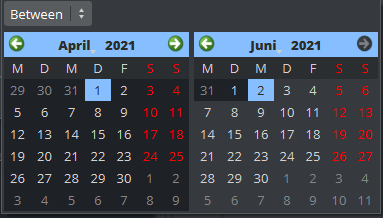

To search for a certain time an item has been modified, for example all scenes that have been changes last week, the modified property can be used. It can be:
  • Any time: Uses default value with no range specified.
  • From: Uses a start date until now.
  • Until: Shows any item modified before the specified date.
  • Between: Shows if an item has been modified between two dates.
Reference Search
There are two different ways to search for references:
Reference Search on an Item
Right click on an item (or CTRL + R) gives one the possibility to search for its references.
  • Scenes automatically show the items that refer to this scene.
  • Fontfiles show their related Fontface.
  • Other items (like images, etc.) show the File links instead.
Material Definitions for example can have textures as file links, but also be referenced by scenes. By default, the Reference search on a Material Definition shows the scenes it has been used by. If you need to know the textures a Material Definition is using, you need to use the Advanced Settings.
Note: It is not possible to perform a reference search for classic materials, as materials are not referenced. Material information is held inside the Scene.
A Reference Search is indicated by a small icon in the search bar:
Advanced Reference Search
The advanced search panel allows you to specify your request even further. Drag an item to the drop area or directly into the search field. You can then specify if you want to search for References (Used by) or for File links (Uses).
  • Uses: Searches for all objects that use this object, in our example all scenes that use the Material Definition:
  • Used by: Searches for all items, that are being used by this object. In our example, the textures for our PBR Material Definition.
