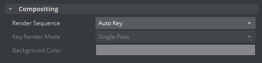

  3. Select Arena Image-Based as Render Sequence in the Global Settings Panel.

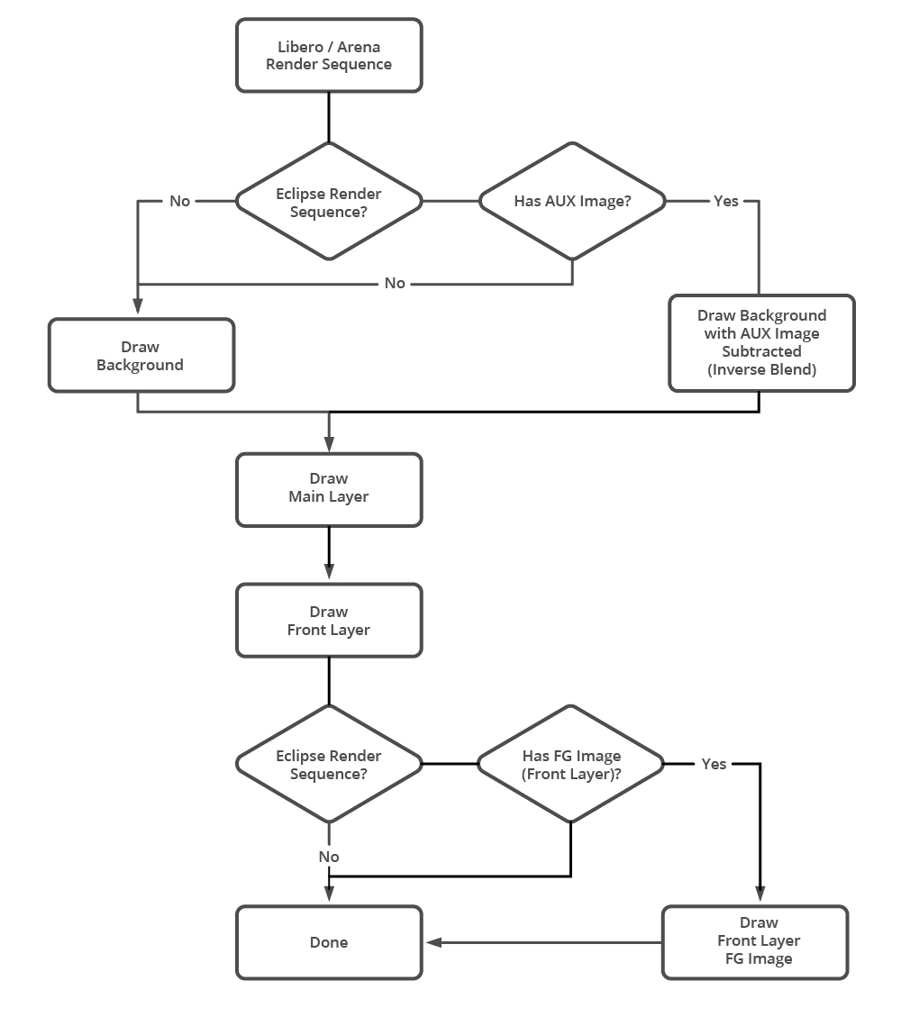

Eclipse Render Sequence (based on the Arena Image-Based Render Sequence)
This render sequence's logic is equal to that of Arena Image-Based (formerly known as Arena/Libero) Render sequence, except for the changes depicted below.
