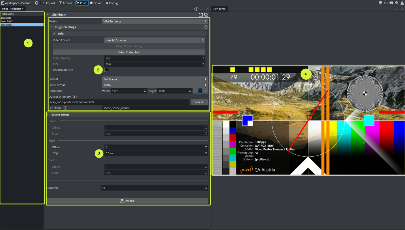

Post Render Screen
The post render panel consists of:
  • Templates (1) (see Post Render Templates).
  • Output Settings (2) (see Post Rendering Plug-ins): Used to configure the output format and the destination of your post project
  • Post rendering setup (3): The configuration for your scenes to be rendered (In the Classic Render Pipeline you can render Front, Main and Backlayer) and set various offsets and stop points. Offsets can be used for the Main, Front and Back Layer, so they start at different times.
    Stop points in post are usually lost, therefore the Stop points can be changed to a pause duration.
Note: Layers need to be set before switching to the post renderer.
  • Output preview (4)
To Post Render a Scene
  • Open the Scene to be post rendered.
  • Assign (if needed ) Front and Backlayer.
  • Click Post. The Scene is loaded Main Layer target area.
  • Select a Template to load all settings or choose your output module. Output modules are integrated as plug-ins. These can be one of the following:

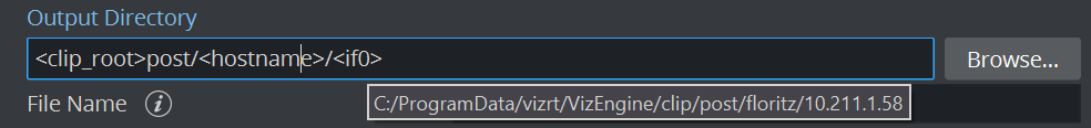

  • Output Destination: The destination is specified by the Output directory, the filename defines the naming convention. You can use the following placeholders:
Note: First Field top is only used for NTSC format, Standard is First field bottom.
Variable
Definition
<absolute_scene_name>
Expands to the complete path of the loaded scene.
<base_scene_name>
Expands to the scene name.
<clip_root>
Expands to the clip_root.
<hostname>
Expands to the host name.
<if0>
Expands to the IPV4 network address of the first network interface.
<if1>
Expands to the IPV4 network address of the second network interface.
<if2>
Expands to the IPV4 network address of the third network interface.
Example Usage
<clip_root>post/<hostname>/<if0>/<base_scene_name>
Tip: Hover over the setting to see how those placeholders will be applied on your system:
If Scenes are post rendered often, with the same settings, create a Post Render Template. To use a saved template double-click it in the Template panel.
Note: Post rendering templates are saved in the Graphic Hub and not on the local machine.
Important: If pools are cleaned up using POOLS CLEANUP or the Graphic Hub is changed, the list of post render templates is deleted and reloaded when opening the post render screen again.

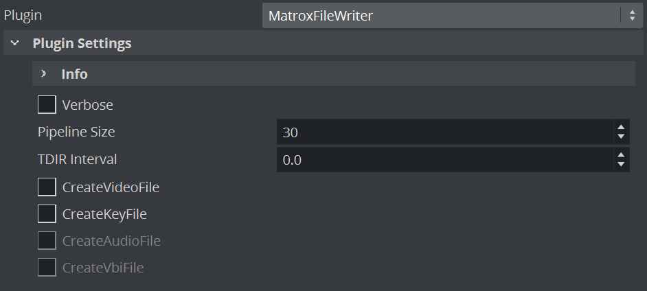

Matrox File Writer
The Matrox File writer is only available, if a Matrox board is present. This can be a native board with Codec upgrade or a DSX.Core virtual license.
These additional settings for the Matrox File Writer plug-in:
  • Pipeline Size: Defines the number of internal buffers in frames for the Matrox framework to operate. For SD+720p+1080i should be around one second (~25-30). It is recommended that you leave the default values.
  • TDIR Interval: Sets the interval time, in seconds, to update the video file while it is recorded. The value must be 1 or more (less than one does not activate the TDIR feature).
Note: TDIR is only supported on .avi, .p2.mxf, xdcam.mxf, xdcam_422.mxf, .mov, and .wav containers. The MATROX_MOV .mov containers write a separate file (<basename>.Ref<.extension>) that is updated to read the .mov file. This reference file needs to be used while the file is growing. The QT_MOV containers update the .mov file directly.
  • CreateVideoFile: Creates a fill clip when set to On.
  • CreateKeyFile: Creates a key file when set to On.
  • CreateAudioFile: Not in use.
  • CreateVbiFile: Not in use.
  • CreateProxyFile: Specifies a custom resolution copy of the clip when set to On. These settings behave in a similar manner to the video file options and show when this is set to On.
  • Video Resolution: Shows clip resolution information.
Important: Only broadcast resolutions are supported. If a non-broadcast resolution is configured, the plug-in initialization fails with a Hardware not supported message.
