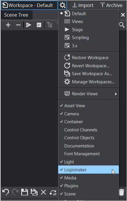

Logicmaker is a tool for creating and simulating Transition Logic scenes. Launch by selecting the Logicmaker dock under the list of available Docks. This starts Logicmaker in a floating dock.

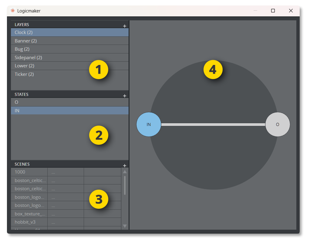

User Interface

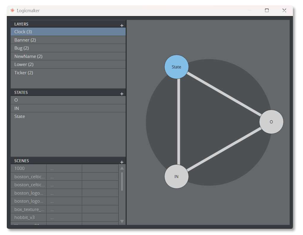

The interface consists of four main areas:
  1. The Layers List, located at the top left corner of the side panel.
  2. The States List, located in the middle of the side panel.
  3. The Scenes List, located at the bottom of the side panel.
  4. The State Graph containing the State Nodes, located to the right of the side panel.

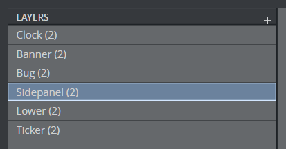

The Layers List
The Layers List shows the transition toggle layers associated with a scene in the Viz Artist editor.
Note: Toggle Layers are placeholders in Viz Artist containing toggle plugins that are used to load scene content in the form of geometry objects or subscene.

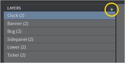

To Add a Layer
To add a transition toggle layer to the current scene in the Viz Artist editor interface implement the step below. This makes the scene a transition logic master scene if it is not already one.
  1. Click the plus sign (+) in the top right corner of the Layers List panel.

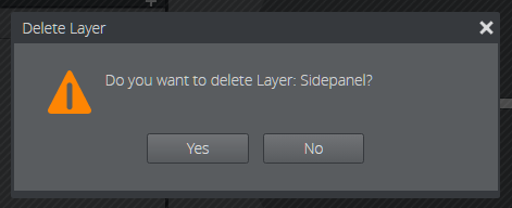

To Delete a Layer
Remove a transition toggle layer from the current scene in the Viz Artist editor. If the last transition toggle layer is removed from a scene, the scene is no longer a transition logic master scene.
  1. Select a layer from Layers List.
  2. Press DELETE.
  3. Click Yes to confirm the deletion.

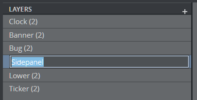

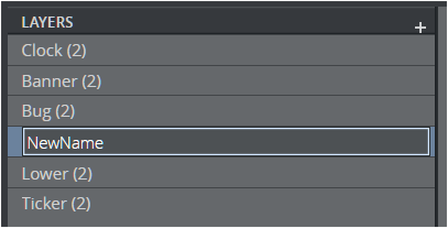

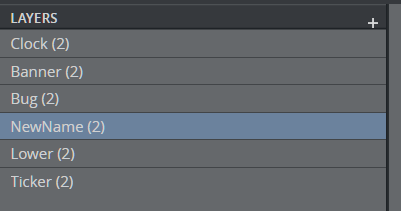

To Rename a Layer
Rename a transition toggle layer.
  1. Double-click a layer from the Layers List.
  2. Type in the new layer name.
  3. Press RETURN.

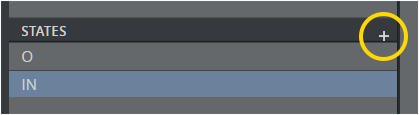

To Add a State
Add a state to the set of states supported by a transition toggle layer.
  1. Select a layer in the Layers List.
  2. Click the plus sign (+) in the States List (or use the context menu or the INSERT key).

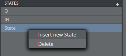

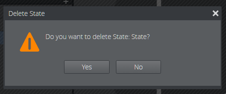

To Delete a State
To Delete a Layer State
  2. Select a state in the States List.
  3. Press DELETE.
  4. Click Yes to confirm the deletion.
Note: Click No to cancel the deletion of a state.

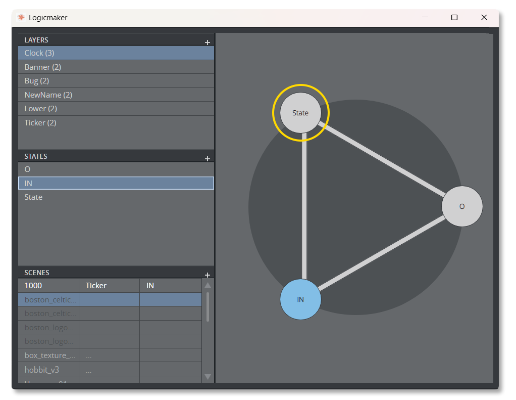

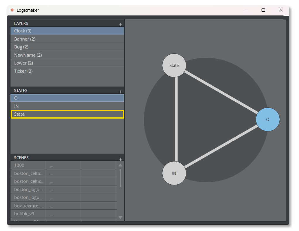

To Jump to a State
There are two ways to jump to a state: in the States List or the State Graph. This shows a specific state in the Viz Artist render output. Each method also has the option to animate the state jump, as explained below.
To Jump to a State in the State List
  1. Click the desired state in the State List.
Tip: To animate the state jump, hold down SHIFT and click the left mouse button when pointing to a new state in the State List.
To Animate a State Jump in the State Graph
  1. Click the desired state in the State Graph to animate the state jump.
Tip: To jump to a new state without animation, hold down SHIFT and click the left mouse button when pointing to a new state in the State Graph.

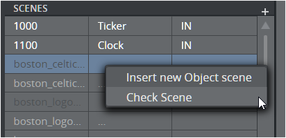

The Scenes List displays a list of all scenes within the same folder as your master scene. It shows the scene name, the layer and the state this scene is attached to.
Click on a scene to load it and check if it can be used as an object scene inside your master template. To only check the scene, right click on it and select Check Scene.

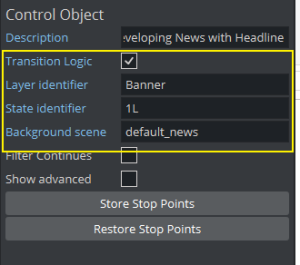

A valid scene has a control object plug-in assigned, Transition logic enabled, a valid Layer identifier, a valid state identifier and a Master or Background scene.

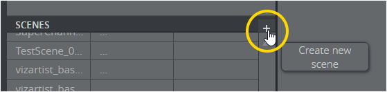

To Add an Object Scene
Create a new object scene targeting a specific layer and state.
  3. Click the plus sign (+) in the Scenes List.

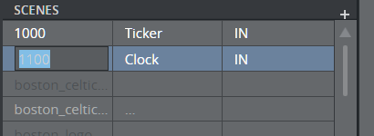

To Rename an Object Scene
  1. Double-click a object scene in the Scenes List.
  2. Enter the new name of the scene.
  3. Press RETURN.
