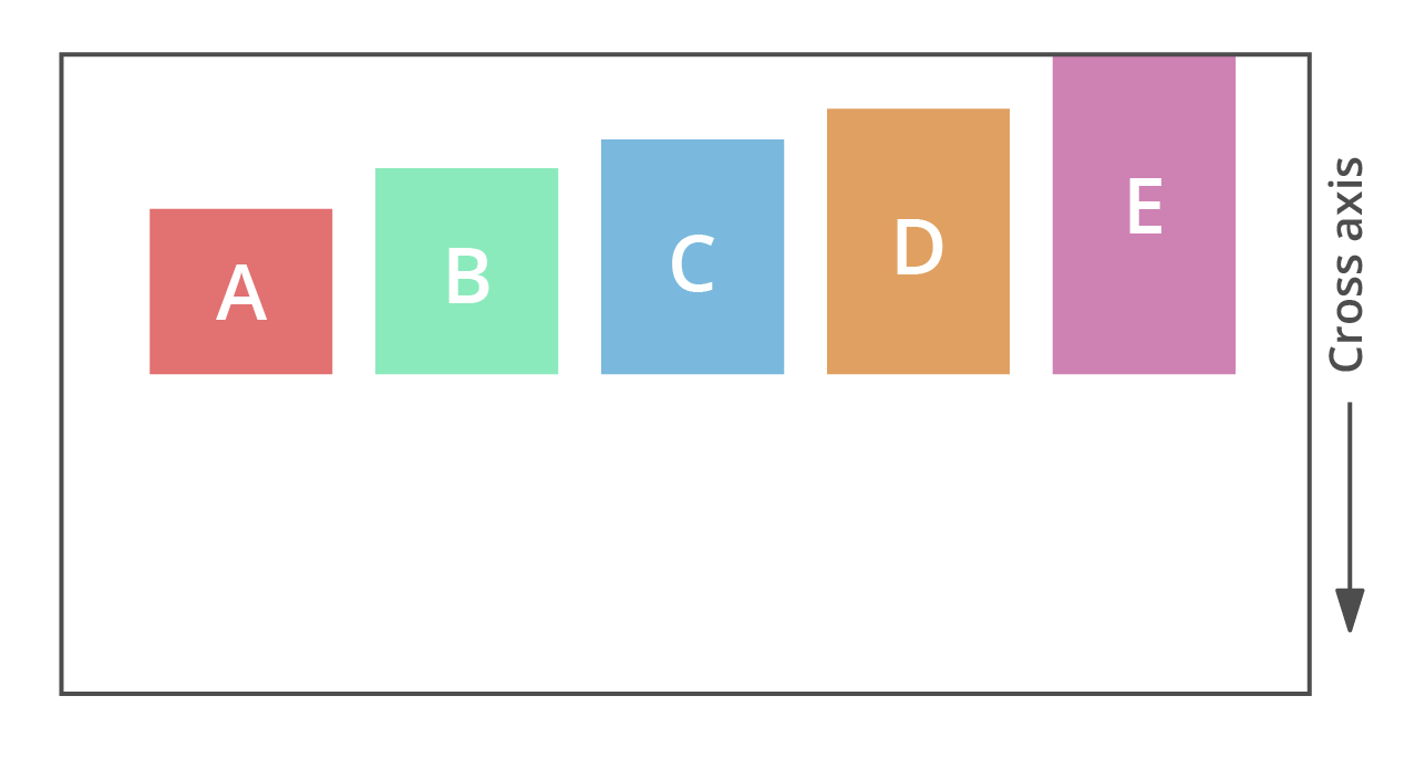

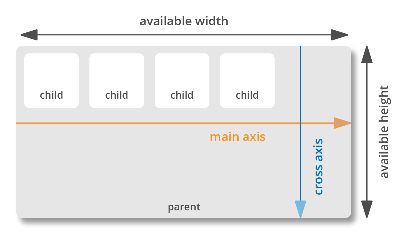

Layout in Flexbox uses two axes, the main axis and the cross axis. The alignment of any child items along those two axes depends on the available height and width

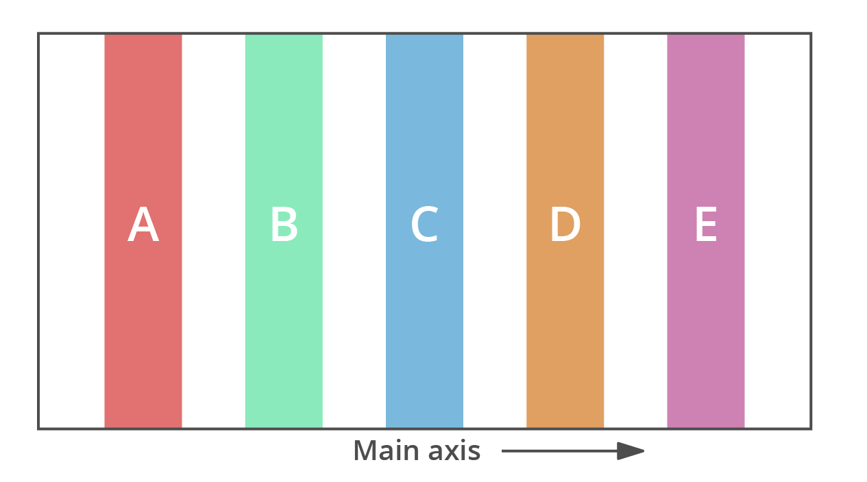

The Main Axis is defined by the direction property. If the direction is set to row, the Main Axis is horizontal. If set to column, the Main Axis is vertical.
Justification defines how items are aligned along the Main axis. Alignment defines how items are aligned along the Cross axis.

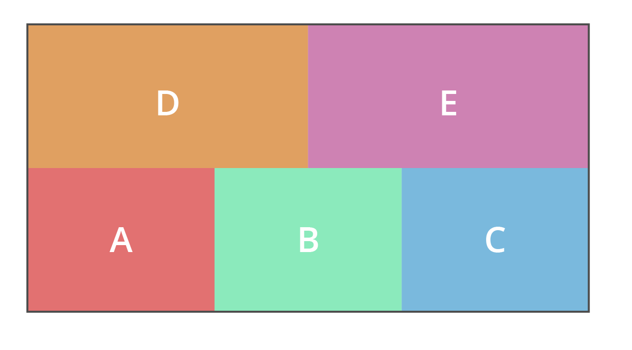

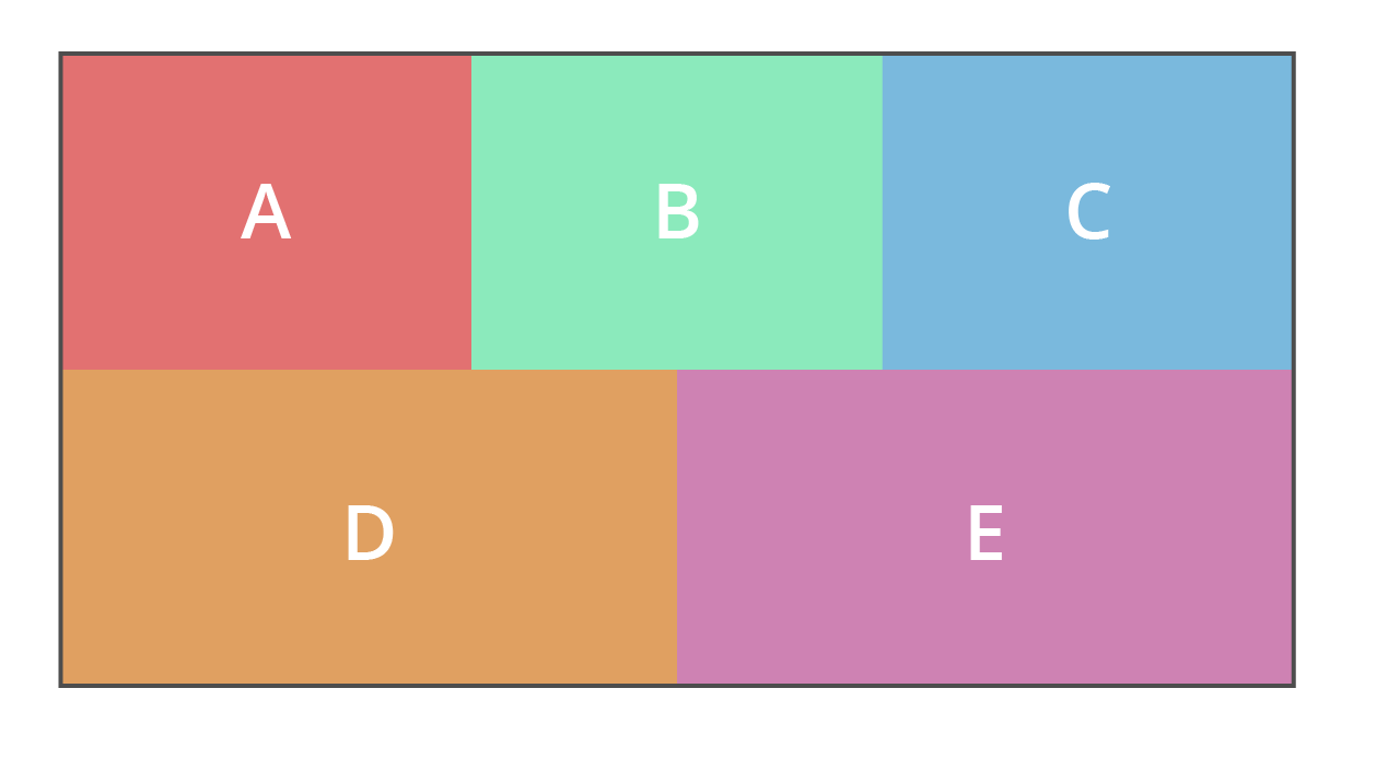

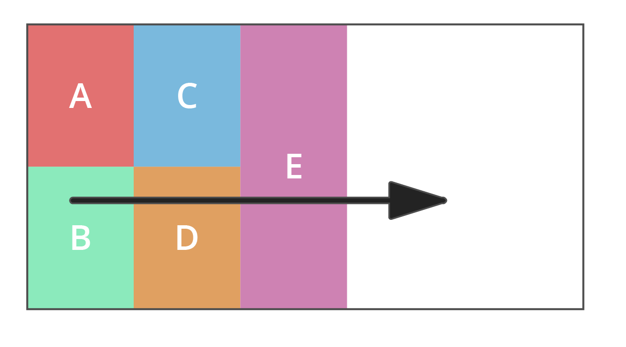

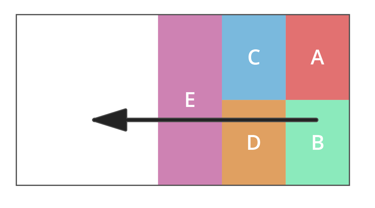

Wrap and Wrap Reverse
If wrapping is turned on, the boxes are scaled down until they reach their minimum size and are then wrapped to fill the space.
Wrapping enabled - Parent 50%
Wrapping Reverse enabled - Parent 50%

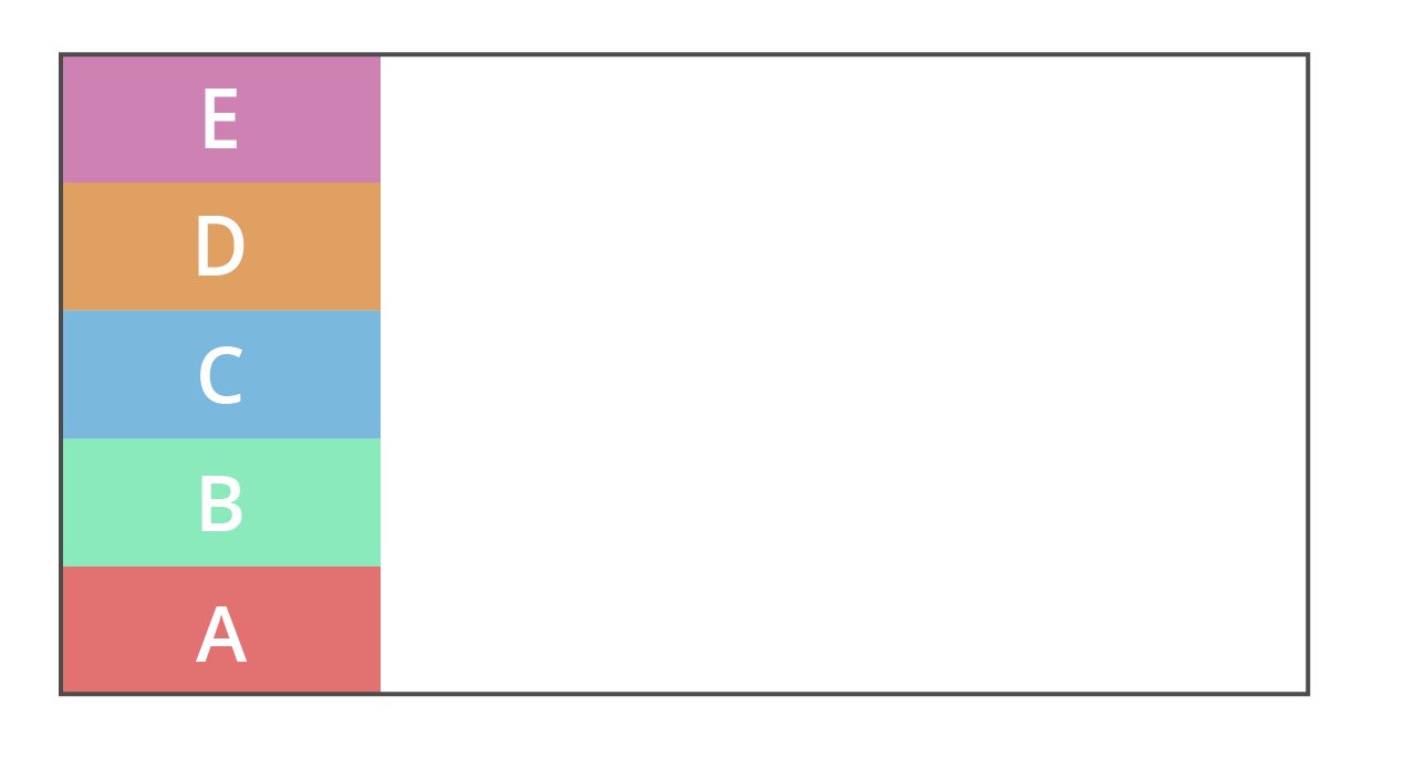

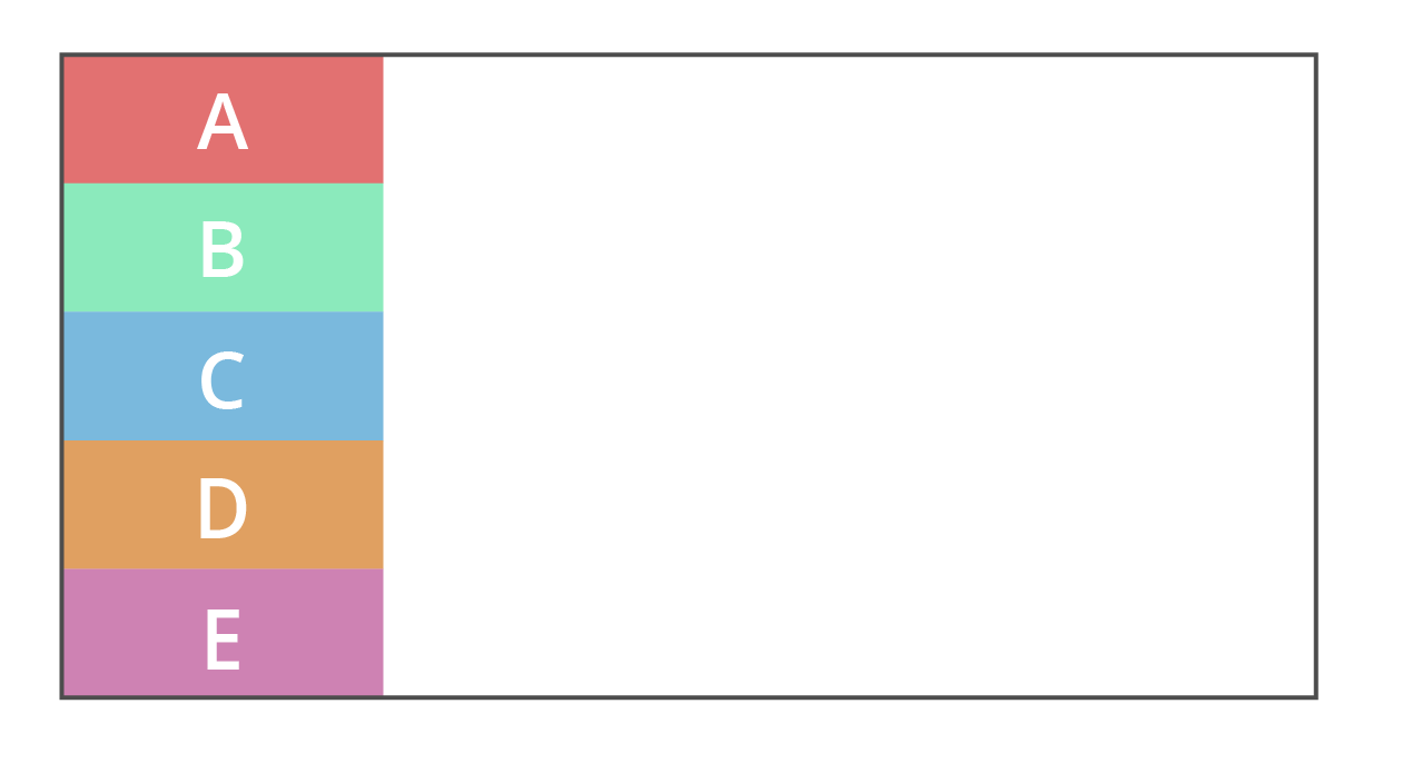

Flex Direction
Defines the Main Axis direction. Layouts can be based on Rows or Columns for all child boxes. This means that all children are placed within a row or within a column. The Flex Direction defines the main axis and defines the direction of all children placed underneath the flexbox container.
Column
Column Reverse

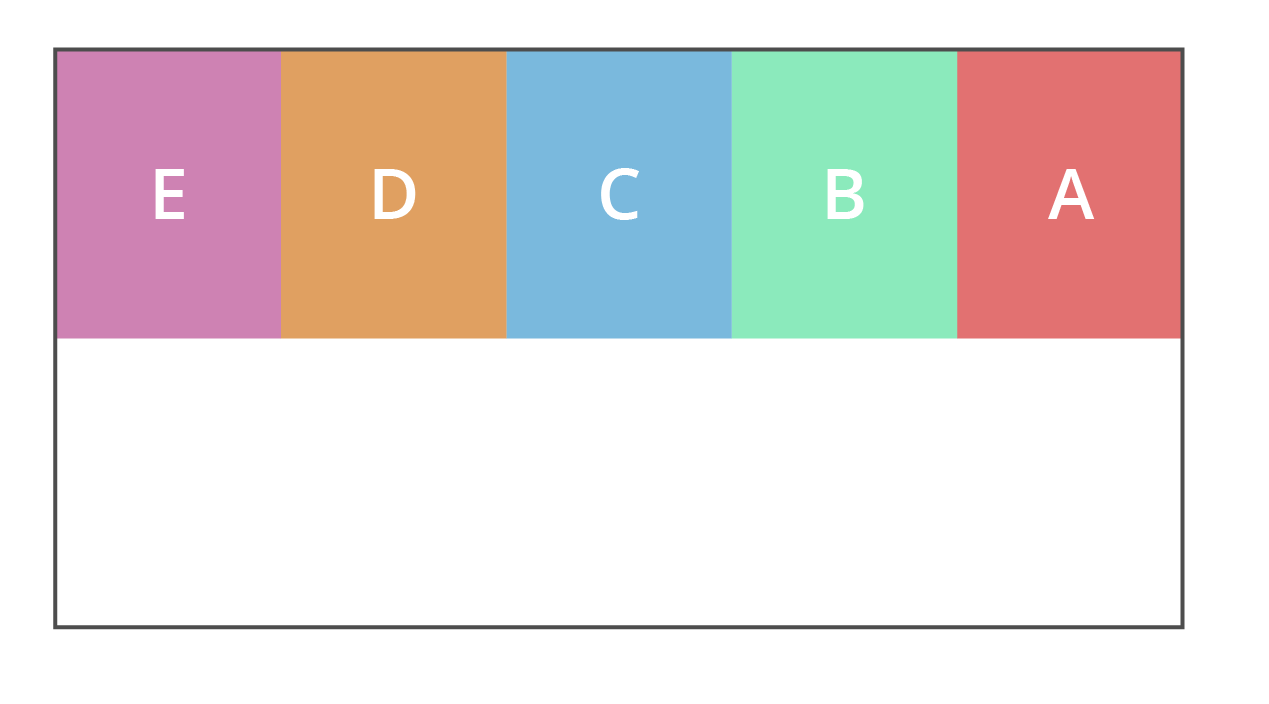

Row
Row Reverse

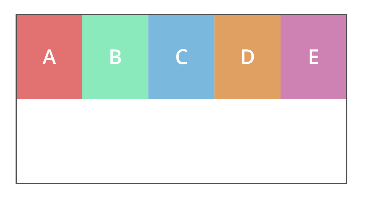

Direction
The direction property defines the main axis. Your children can be aligned starting from the left or from the right side. By default it inherits the setting of the parent flex container.
In Column mode this is being flipped and the main axis is going top to down or reverse.
Left to Right
Right to Left

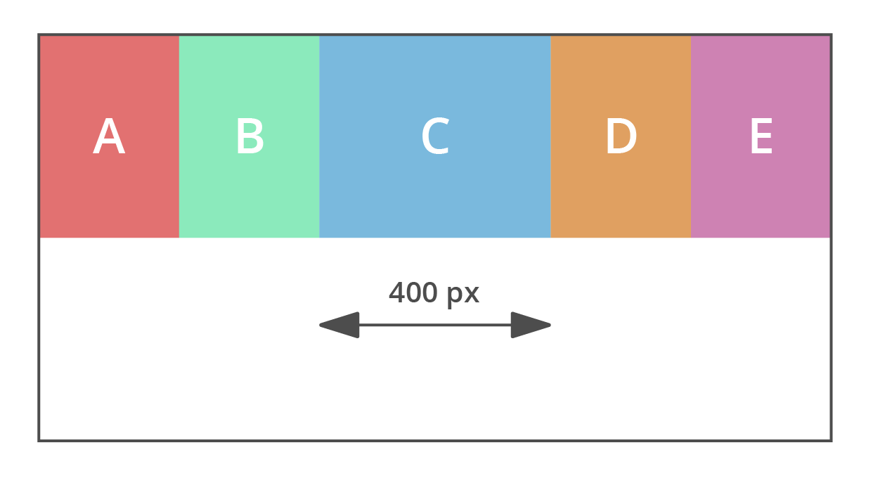

Parent container on 100 %
No wrapping
Container C has growing = 0 and Shrinking = 0, size is set to 400 px

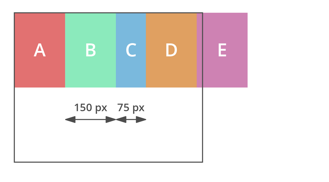

Parent container on 60 %
No wrapping
Scaling of container C stays, whereas all other containers shrink to fit into
parent dimensions.

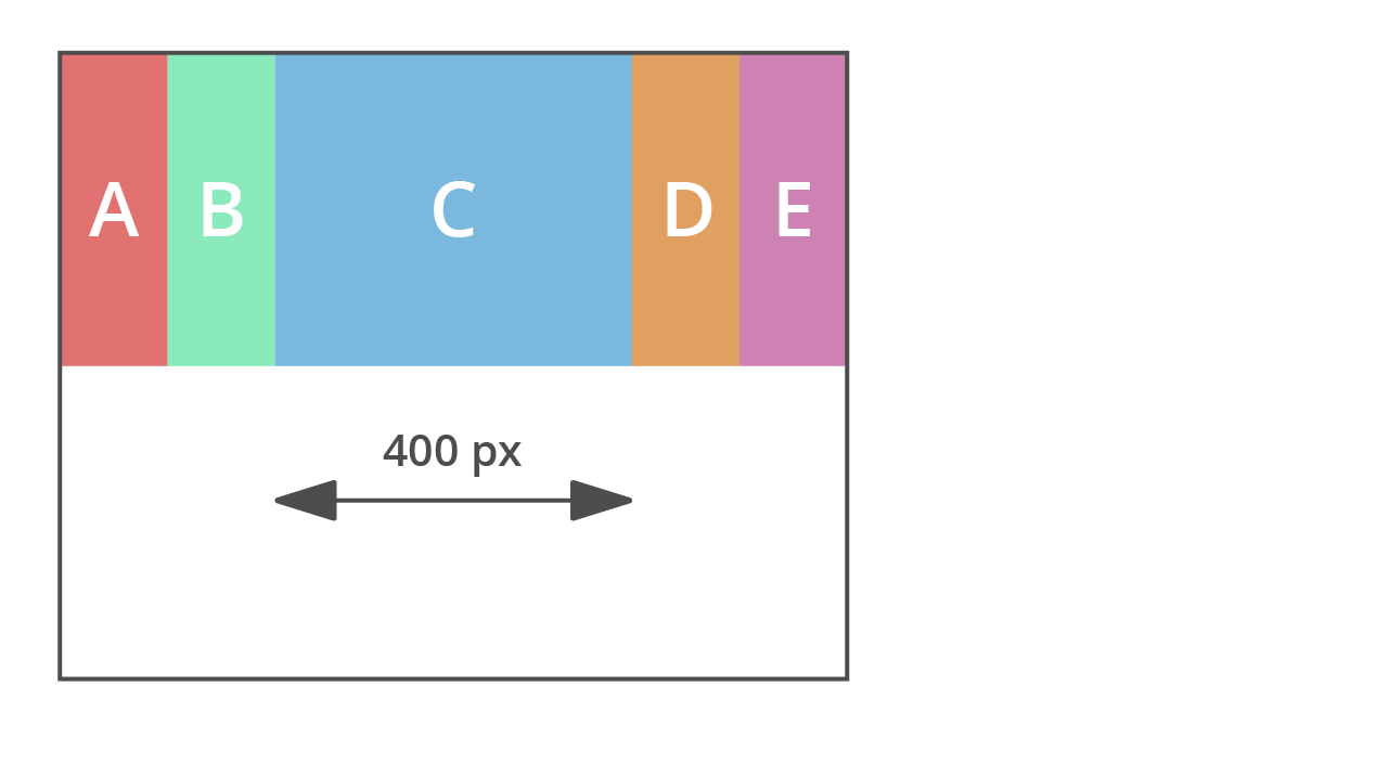

No wrapping
Container C has growing = 0 and Shrinking = 2.0, size is set to 400 px
Container C is scaled down twice as all other containers (shrink = 2.0)

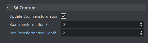

Handling of 3D Objects
Since Viz Artist version 5.1, FlexBox can control the Box Transformation depth and z values. If the Update Box Transformation flag is enabled, the values of Box Transformation are overridden by FlexBox in each field. This flag does not affect the width/height and x/y values of Box Transformation being overridden by the FlexBox plug-in.

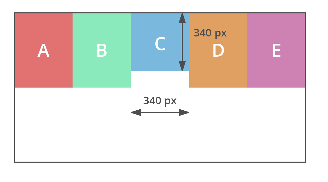

Aspect Ratio
Defines how a flexbox is being scaled. If it is on auto, the width and height taken as it is. If a value is used, it defines the ratio between width and height. For example: An aspect of 2.0 means the width is twice the value of the height.
Aspect ratio = 1
Width and height are the same.
Aspect Ratio = 2

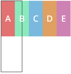

Aspect Radio = 0.5
Auto

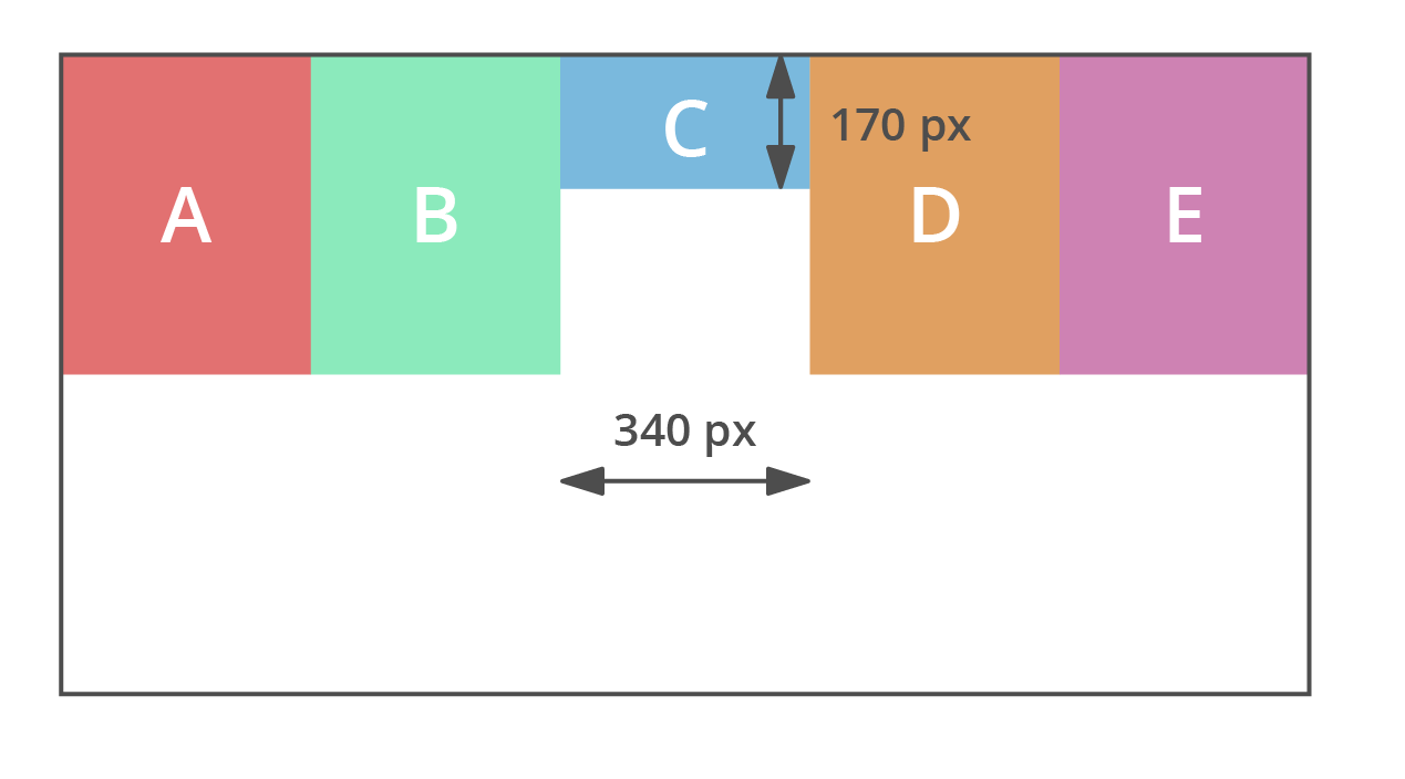

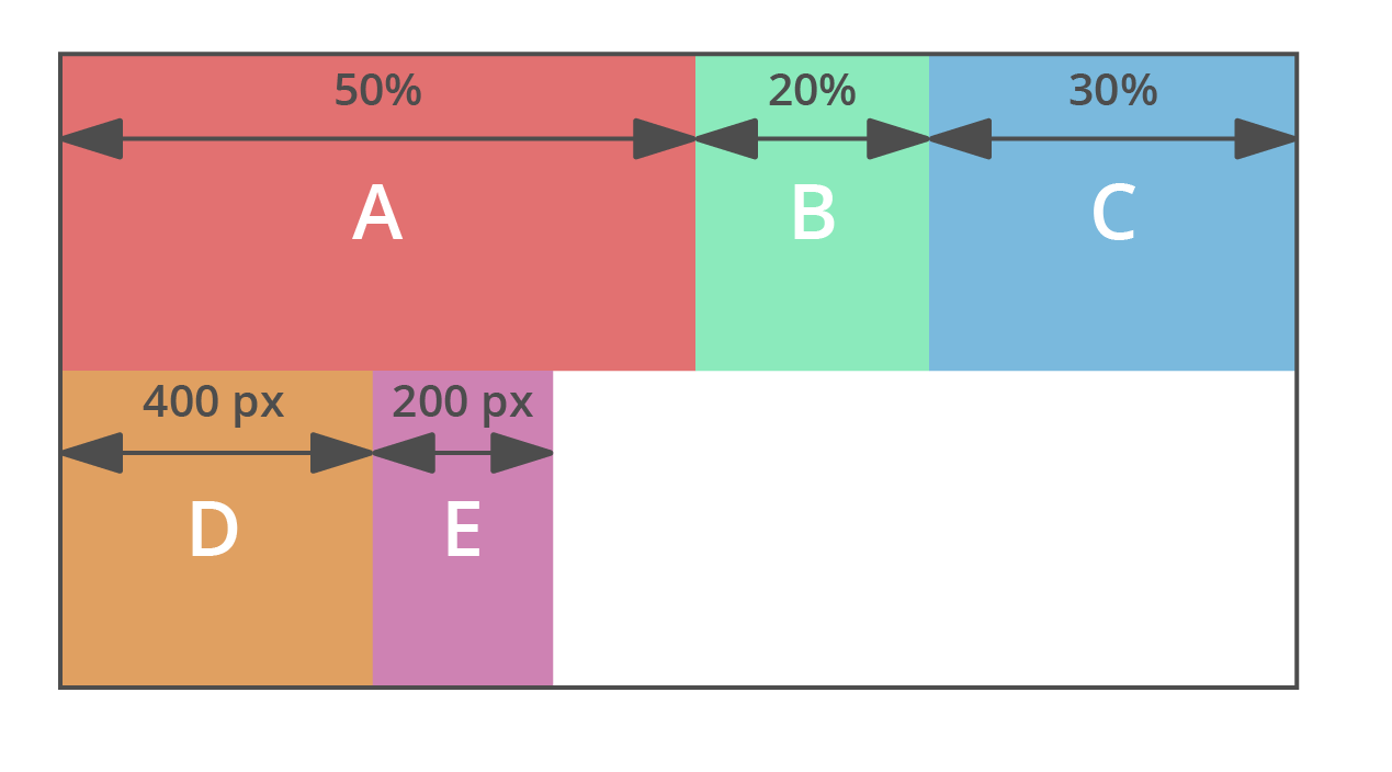

Width, Height and Limits
The sizes for width, height, minimum width and height as well as the maximum width and height can be set to be either auto, in percentage values or in pixel sizes.
  • Auto: The size for the box is being calculated automatically based on grow and shrink values, the content as well as the aspect ratio.
  • Pixels: Defines the width/height in pixels.
Note: This dimension can be influenced by other properties.
  • Percentage: Same as pixels, but based on percentage values.
The minimum and maximum values size set the upper and lower size constraints of a container. These properties have higher priority than all other properties and are always respected.

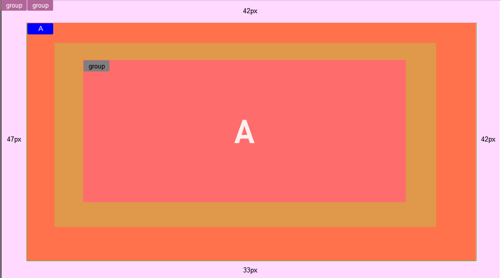

Margins, Padding and Borders
Each container can have some offsets by adding either a margin, padding or border.
  • Margin: Adds an offset to the outside of the element. It offsets itself and all children from the calculated position. It adds to the total size for the element. it can be set to auto, pixels or percentage values. Negative numbers are allowed too.
  • Padding: Affects the size of the container it is applied to. It does not add to the total size of an element if it has an explicit size set. It can be set in pixels or percentage, but can not be negative.
  • Border: Does more or less the same as padding. It can only be set in pixels. The main purpose of having an additional border is to keep compatibility with the original flexbox implementation.

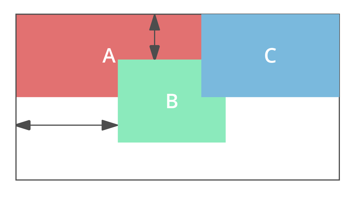

Positioning

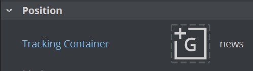

Tracking
To bind one container to another, Flexbox supports tracking. You can specify a reference container and your container follows this position. All other properties are disabled, but offsets can still be applied.
Adding an offset to a container shifts the whole container and its content based on the calculated position by the given values. This offset can be either relative or absolute.
Relative offset
Offsets can be set as auto (calculated automatically when using certain content alignments) or as value in pixels or percentage.
Absolute offset
Takes out the container from the calculation and sets the position to the given values. It can be set as pixels or percentage (auto is available, but is ignored).
When using absolute positioning, all other properties that influence the position are no longer effective.

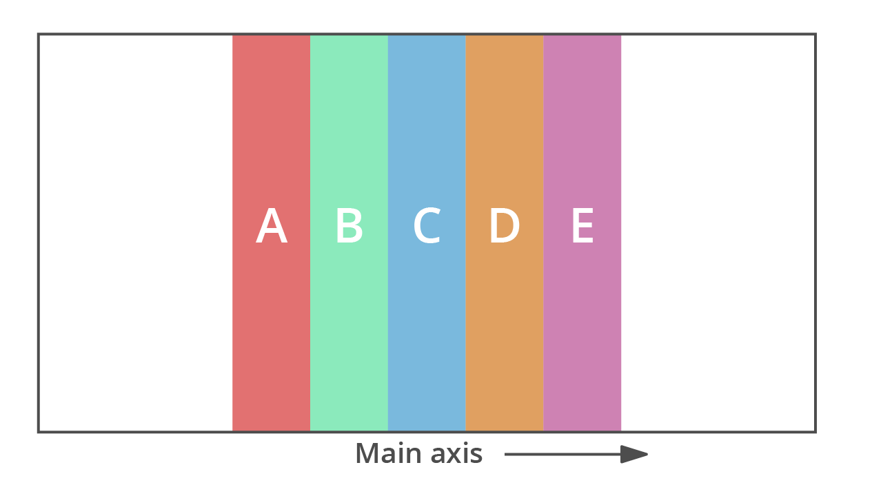

Justify Content
This setting describes how child containers align along the Main Axis. This can be used to automatically center items for example. The samples below show five child containers with a width of 10% and a height of 100%. The following settings are available:

Center
Aligns child containers to the center of the main axis.

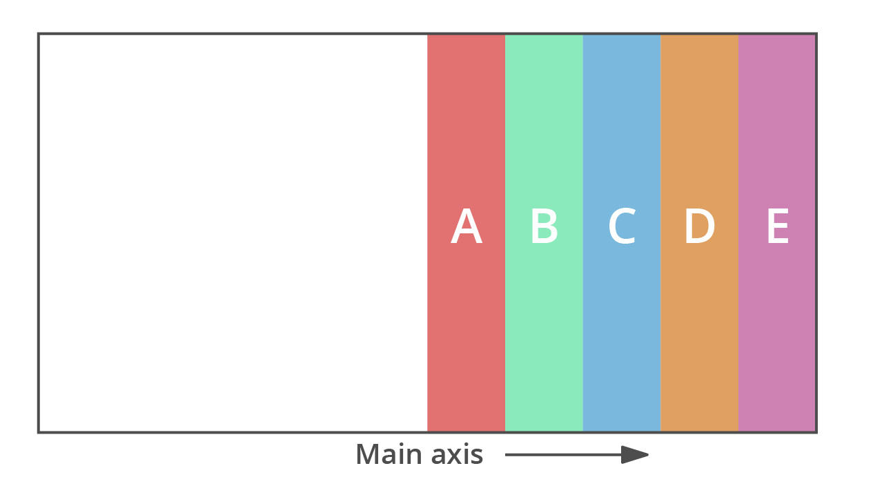

Flex End
Aligns child containers to the end of the main axis.

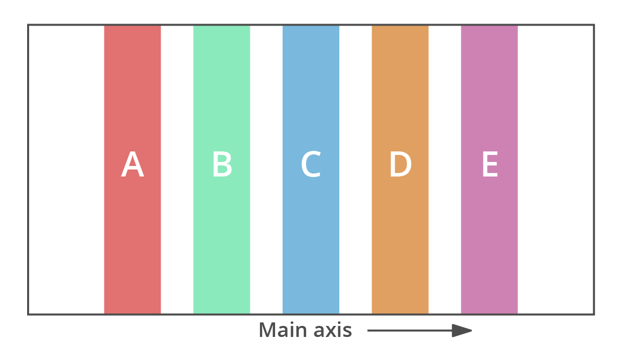

Space around
Distributes the remaining space between all child containers, including start and end as one element

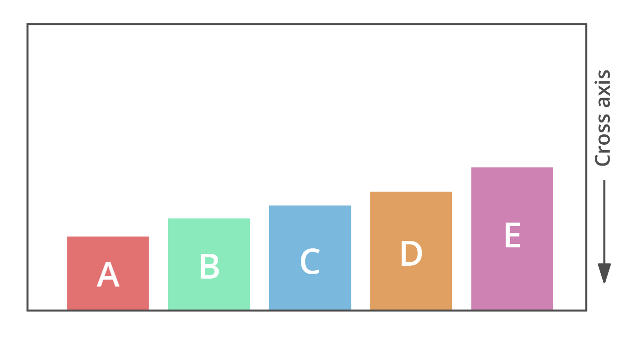

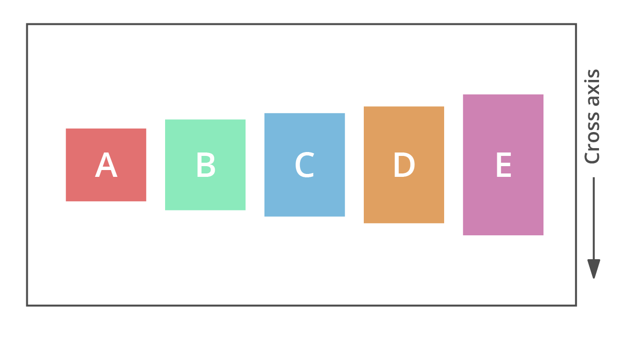

Align Items
This setting describes how child containers align along the cross axis. It sets the default alignment for all child containers, however it can be overwritten by a children using the Align-Self property. The samples below show five child container with a width of 10% and a height of 25%, 30%, 35%, 40% and 45%, Justify content is set to space around. The following settings are available:
Auto
Uses the align item of the parent container.
Flex Start
Aligns child containers to the start of the cross axis.
Center
Aligns child containers to the center of the cross axis.
Flex End
Aligns child containers to the end of the cross axis.

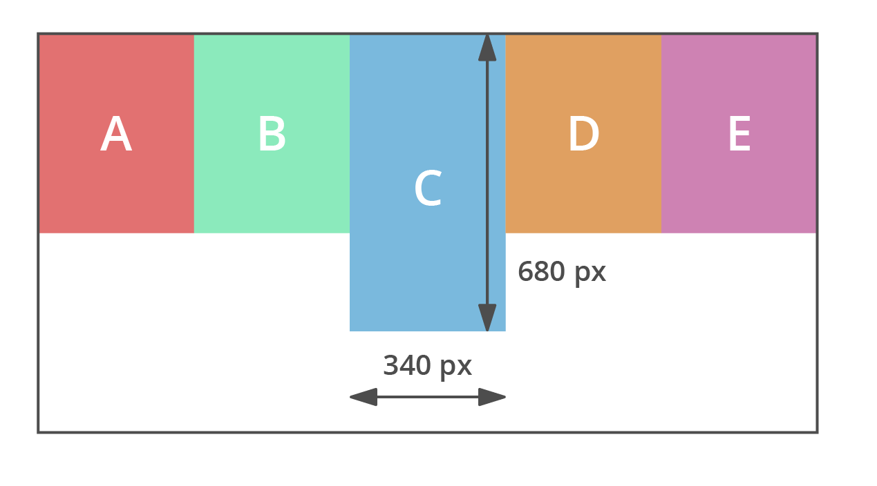

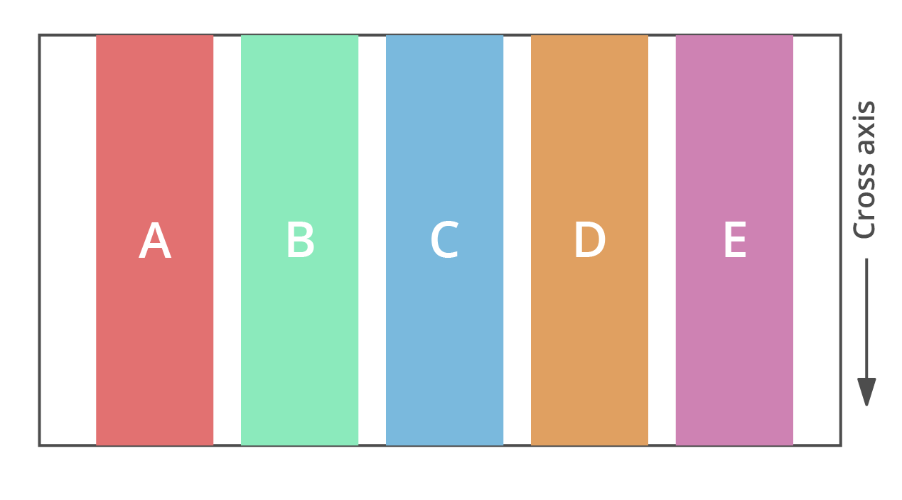

Stretch
The items are stretched to fill the cross axis. Therefore the cross axis setting (in our case the height) must be set to be auto to allow the parent to overwrite the value
Baseline
Aligns all containers in a way such that their baselines align. The highest one starts on the top.

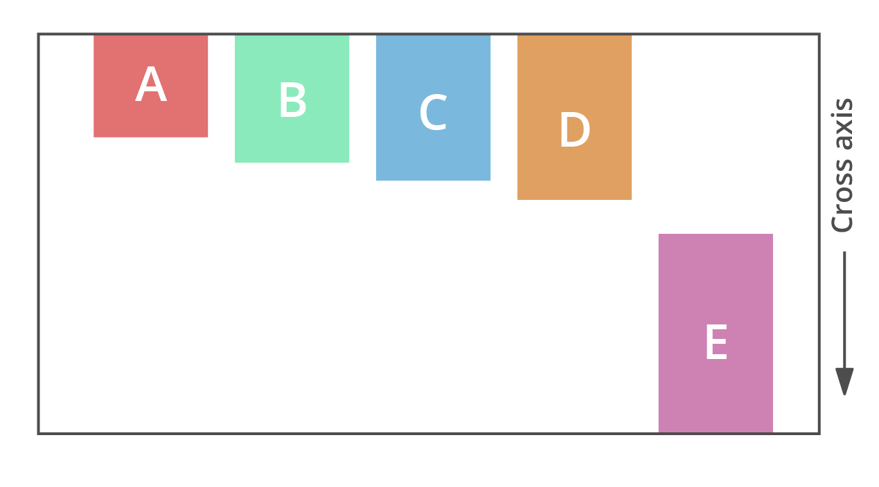

Align Self
Align self is used to overwrite the Align Items property given by the parent container to is own. In the example below, the parent container is set to be Align Items: Start, but container E has an Align-Self set to be Flex-End. This takes it out of the computed position of the top (parent is set to Flex Start) and overwrite it with its own property Flex-End:

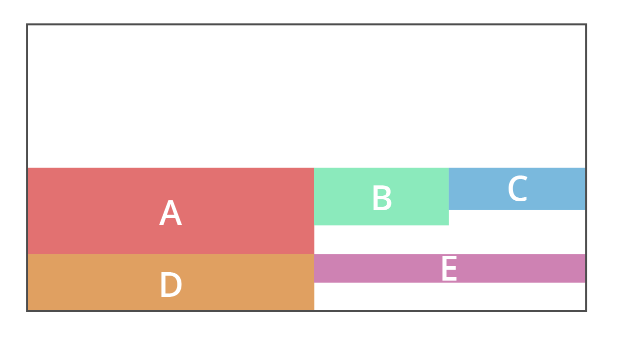

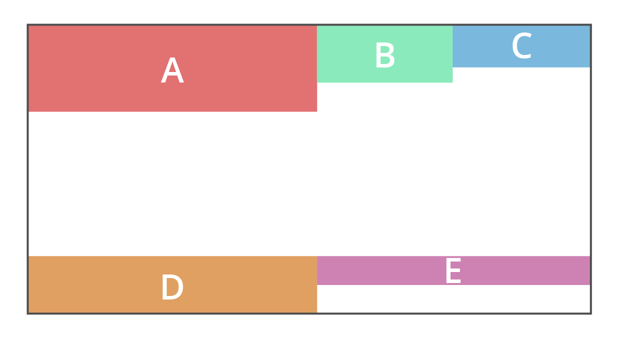

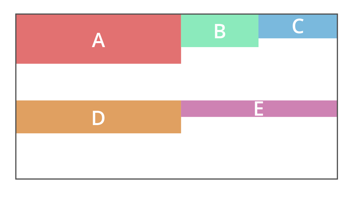

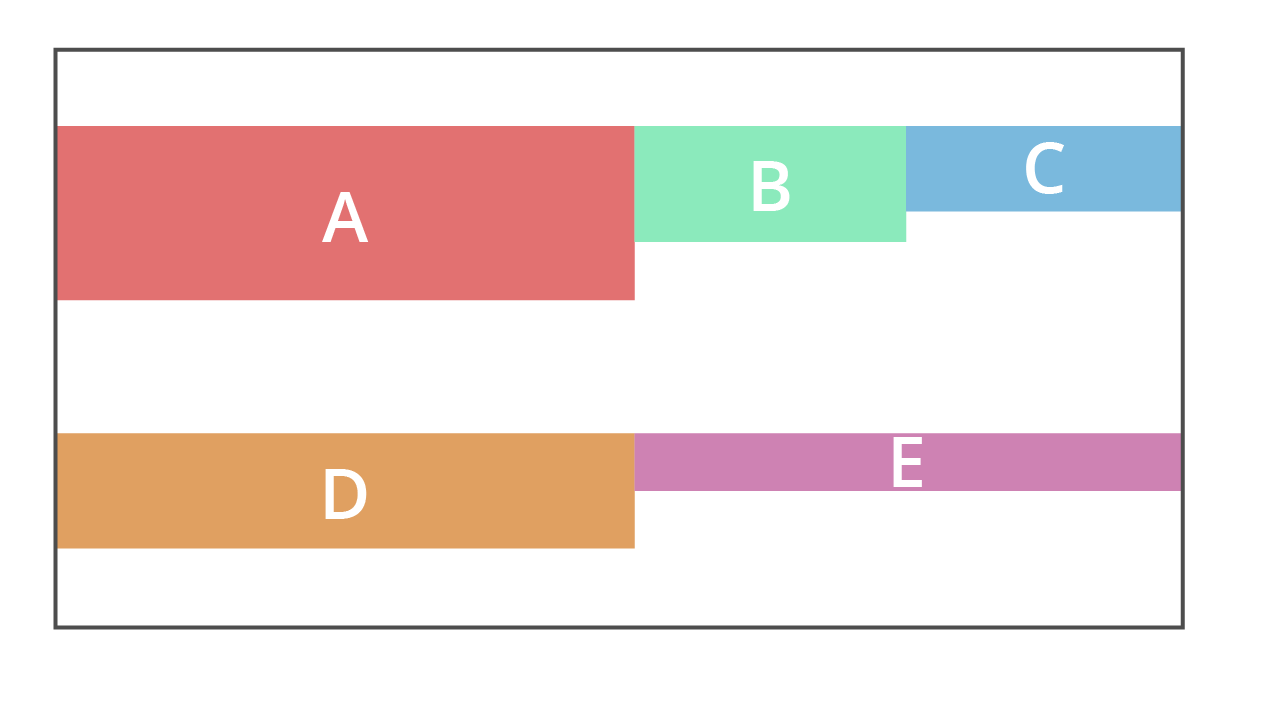

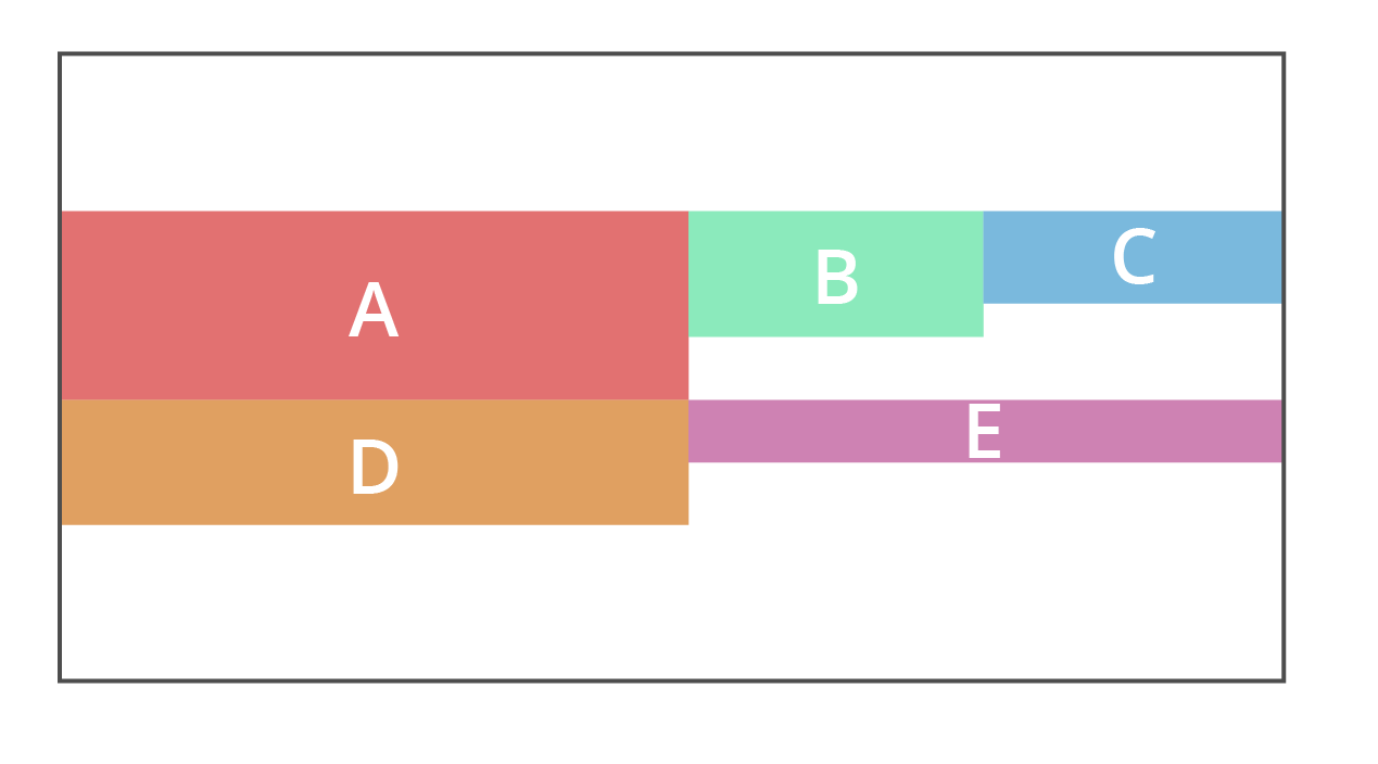

Align Content
Defines how containers are aligned, if the wrap mode forces elements to be distributed in more than on row or column. It has no effect if no wrapping happens.
Auto
Flex Start
Aligns wrapping child containers to the start of the cross axis.
Center
Aligns wrapping child containers to the center of the cross axis.
Flex End
Stretch
Stretches the space between the elements to reach the parent containers cross axis.
Baseline
Space between
Distributes the remaining space between all lines to match the parent containers cross axis.
Space around
Like space between, but also distributes space including top and bottom.
