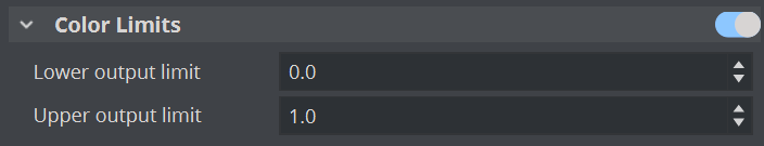

Color Limits (Gamma Correction) can be used to control the overall brightness of your output if it is either bleached out or too dark. Output to SDI usually does not require any further gamma correction. These signals already incorporate a gamma compression matching a typical CRT and these values are fixed and defined by analog video standard.
However, output to other devices or broadcast over stream based channels like NDI might require some adaption to the final output signal.
If enabled, your output is normalized in between the lower and the output limit.

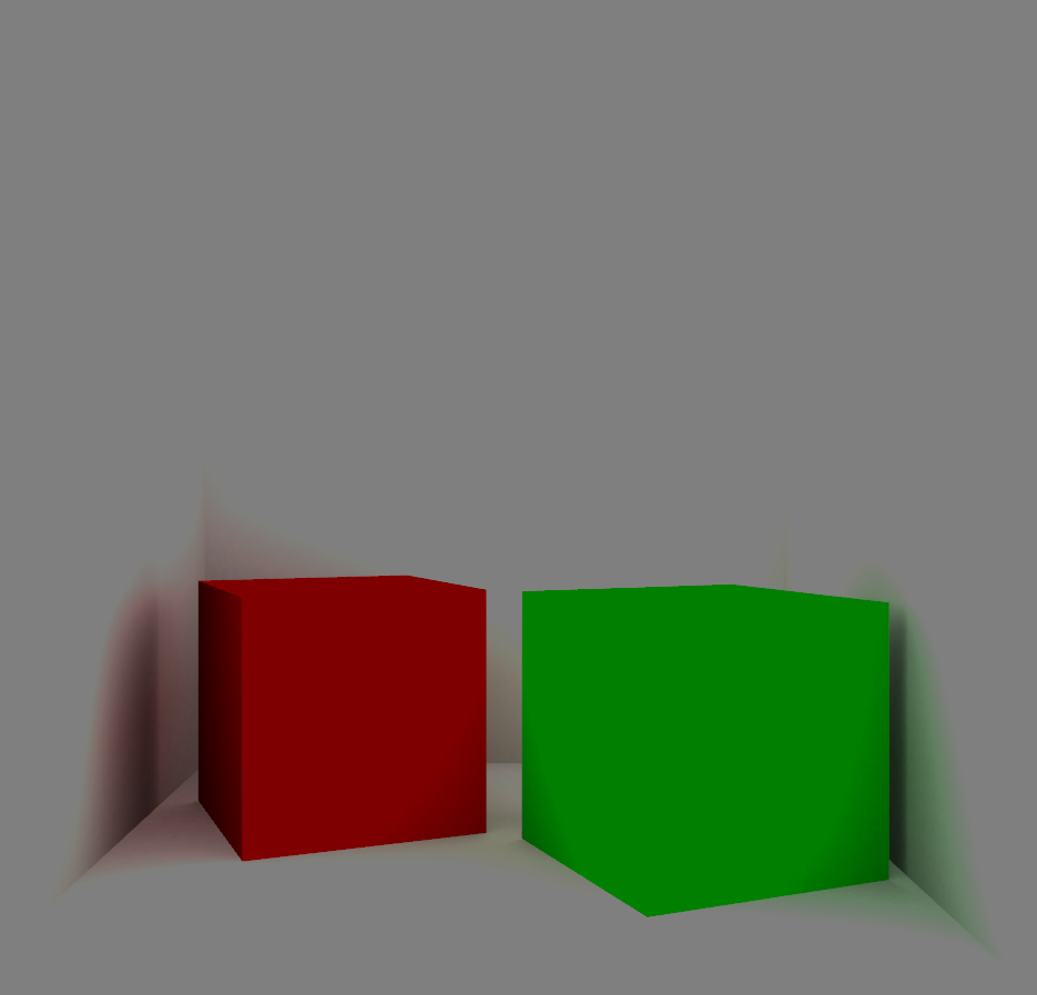

Upper and Lower limit turned off.

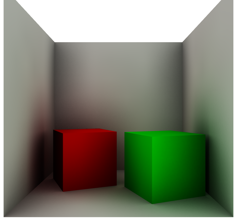

Lower output limit: 0.0
Upper output limit: 1.0

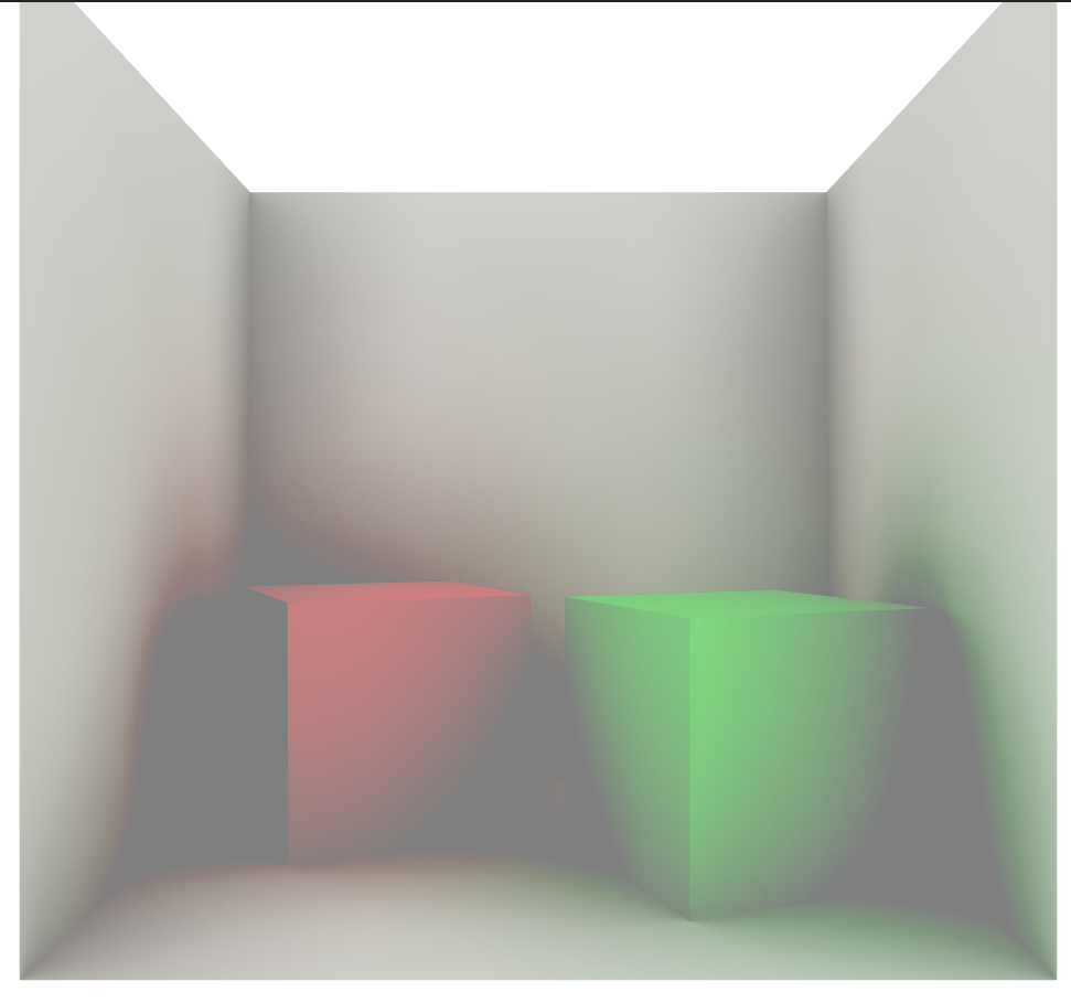

Lower output limit: -1.0
Upper output limit: 0.5

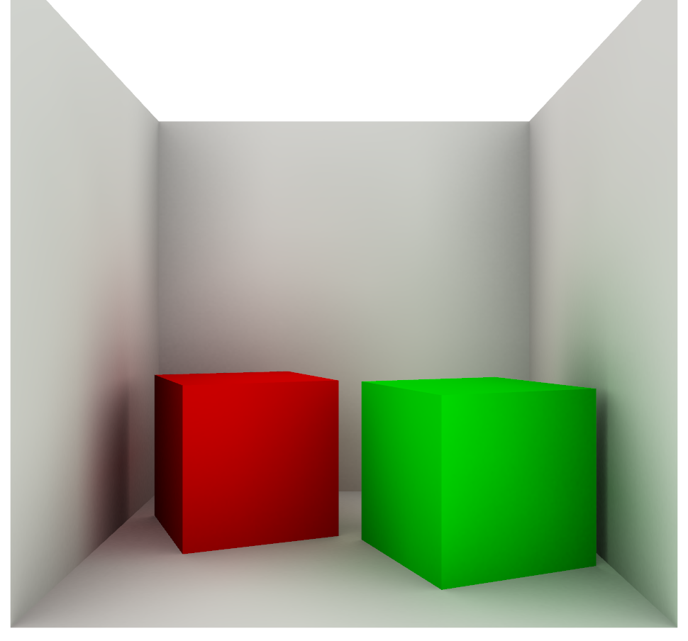

Lower output limit: 0.5
