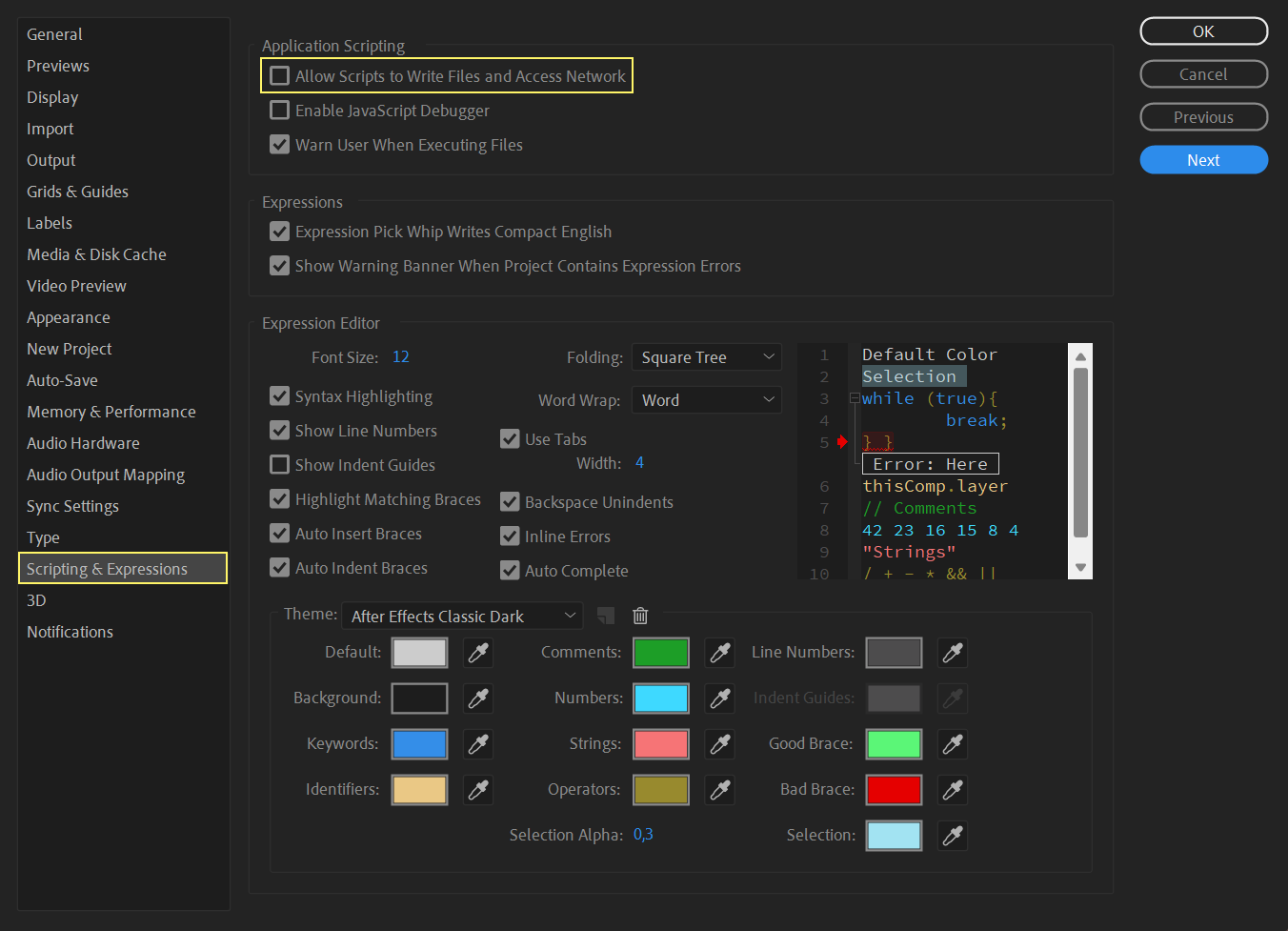

Note: Newer versions of After Effects require to allow the execution of scripts:

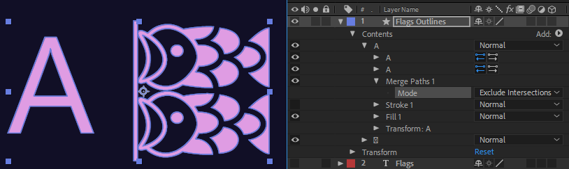

    5. Converted shape from text, each character of it contains multiple paths. The shape of each character merge all paths in a special mode (be decided by After Effects among Add, Subtract, Intersect and Exclude Intersections depends on the overlapping and direction of each path) that we not support it even most of character works with our simple merging method Exclude Intersections, manually change Merge Paths mode of all characters to "Exclude Intersections" can make this layer be import into Polygon object instead of video.
      1. Use Horizontal or Vertical Type Tool to create a text layer.
      2. Right click on the text layer and select Create Shapes from Text.
      3. Expand Merge Path and change Mode to Exclude Intersections.

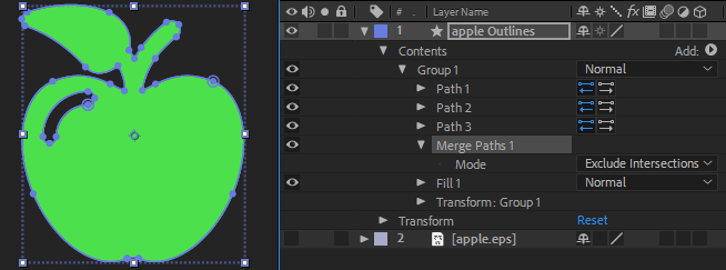

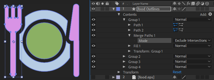

    6. Convert shape from imported external vector graphic file such as .eps. This is similar to the converted text but it might have many groups of paths. To import an .eps file to After Effects and make it be able to imported as as Polygon object in Viz Artist:
      1. Press CTRL + I and select a vector file.
      2. Right click on the vector layer of automatically created composition and select Create Shapes from Vector Layer.
      3. Expand Contents and every groups inside, each group is the same as character of converted text.
      4. Expand Merge Path and change Mode to Exclude Intersections.

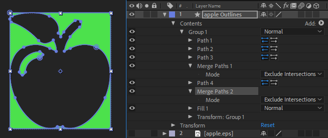

      Some converted vector shapes have multiple group of merged paths and not work with Exclude Intersections merging and mostly one group with single path is used as boundary.
      In this case, that group (Merge Paths and its above Path) can be deleted and other groups can use Exclude Intersections creates correct result.

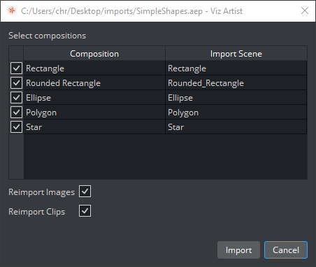

  • Make sure your setup has a Matrox board or DSX Core enabled.
  • Start Viz Artist.
  • Choose Import and switch the type to Scene.
  • Locate your .aep file and drag it to your location in Asset View.
  • Select the compositions you want to import.
  • Select if images or clips need to be re-imported.
  • If a warning shows up about last supported Adobe After Effects version, click OK.
