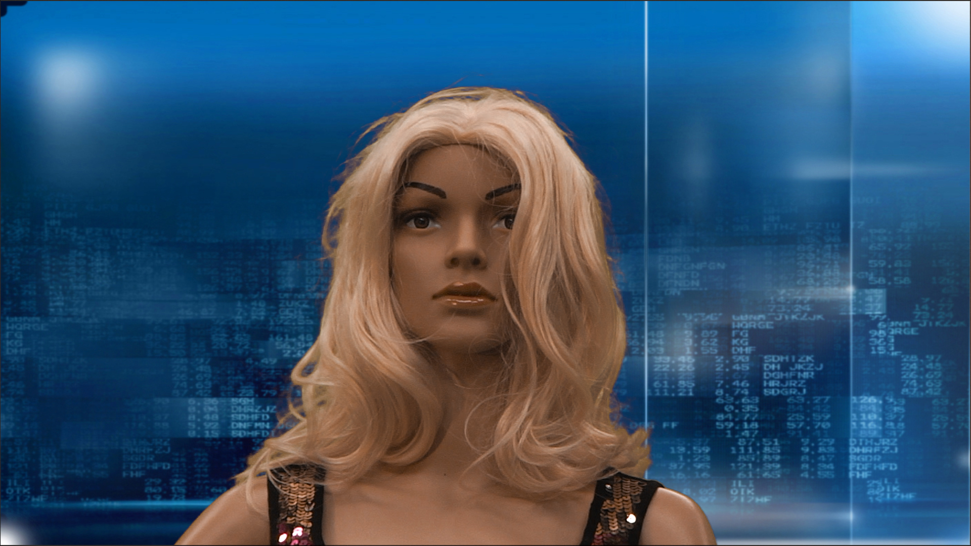

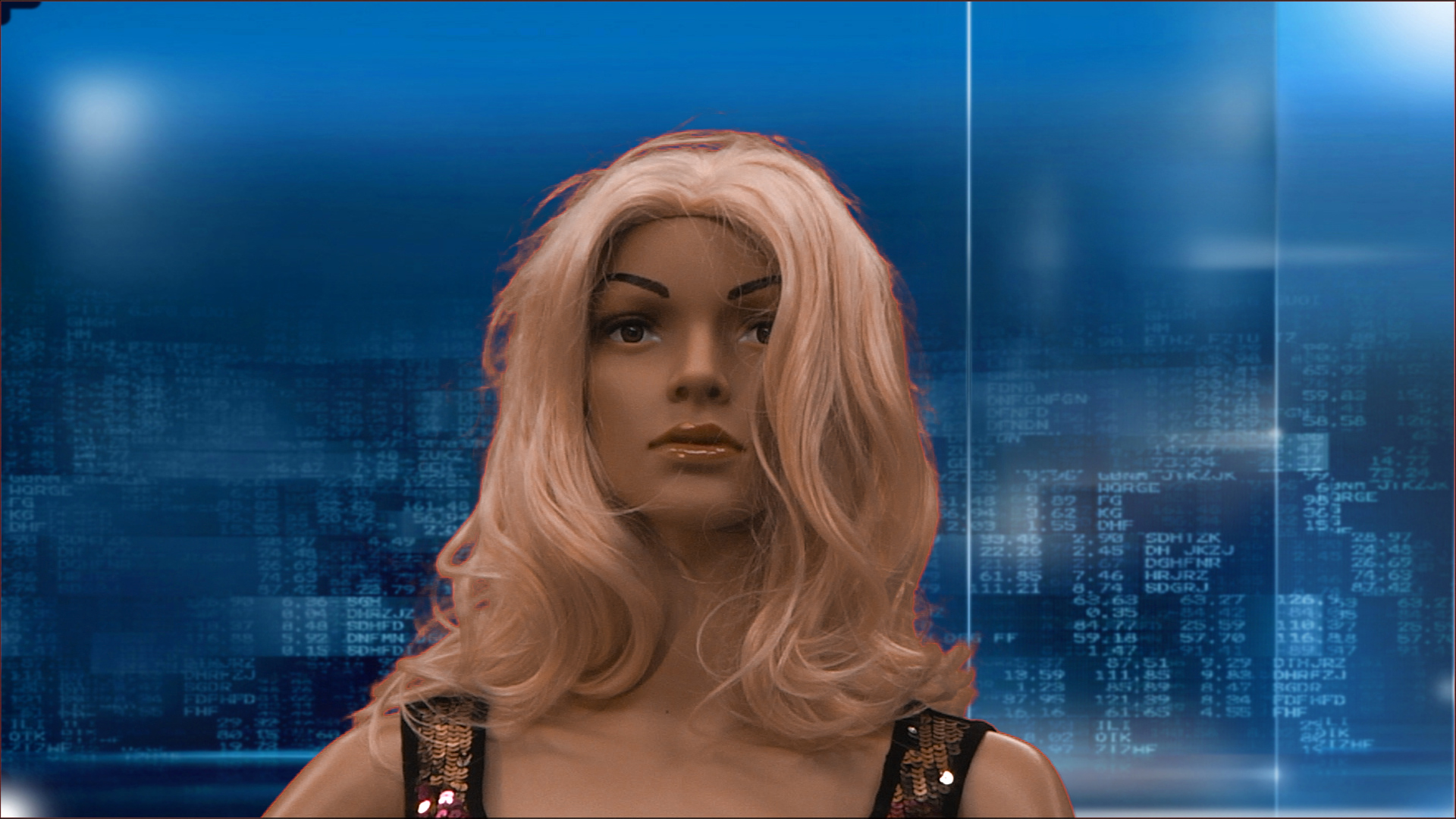

Due to the despilling process, which removes greenish/blueish parts of the skin, it can happen that the color tone is modified too much. Use the CMY gain adjustment to bring Cyan, Magenta or Yellow back as necessary.
There are two versions of lightness restoration available. DARK slightly darkens values in despilled areas, while LIGHT preserves the lightness and leads to more bright edges.
Before CMY Adjustment |
After CMY Adjustment |
