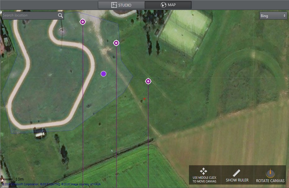

Map
Map items can retrieve map data from Bing.
Bing Map |
Map is used to set up an external environment. You can search for a place in the search bar and place elements directly info the map area. Map uses XYZ positions OR geolocation and transforms them into Viz Units. The map menu lets you:
Zoom in/out with the mouse wheel.
Move the map with the center mouse button.
Left-click on an element to move it.
Right-click on an element to remove it.
Right-click on a map:
Set up a Height Area to intercept the height of the object
Clear All elements in map (except for the Zero Point)
By selecting a Map item, you can choose to send your current map to the main layer or back layer:

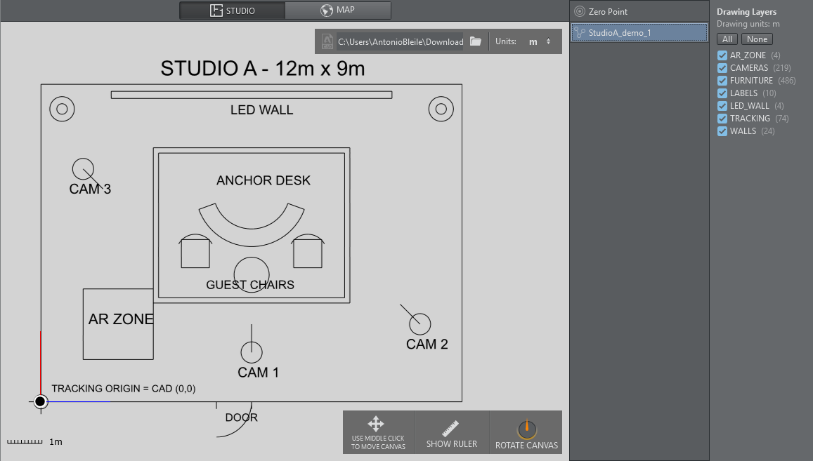

Studio
It's possible to import an AutoCAD project (.dxf or .dwg) and set up cameras and objects directly into your custom studio using STUDIO.
Studio is used to set up an internal environment. You can import your Studio map project using the Browse icon () and place elements directly into the plan area. Studio uses Viz Units only.
When using the DGW format that might contain multiple layers, you can switch those layers on and off, the file unit is also matched with the internal unit stored in the CAD file.

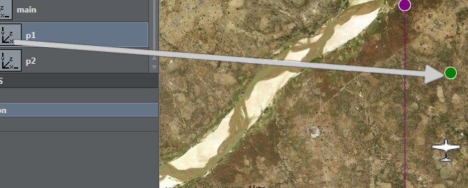

To Position an AR Element
Drag and drop the desired container’s plugin (only position or transformation control channel) into the map area. | |
The green icon appears on the map. | |
The same elements action that was just created can also be found in the action pane in the main window. | |

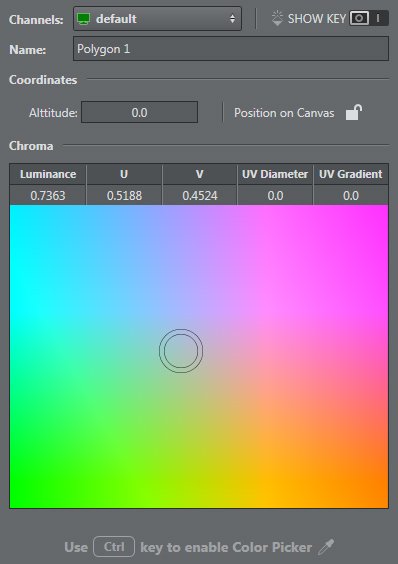

To Draw a Polygon
Right-click on the map OR in the studio area and select Polygon… in the context menu. | |
The cursor transforms into a pen and you can start to draw the polygon on the map. Mark as many vertices as you need. | |
The item is also added to the element list on the right of the map/studio area. | |
Selecting an icon or element in the list makes the corresponding config section appear on the right side of the SET window. | |
It’s possible to lock or unlock a camera position on the map canvas using this command. |

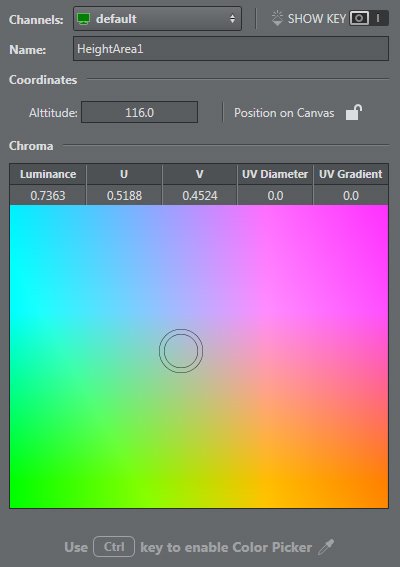

To Set up a Height Area
Right-click on the map OR in the studio area and select Height Area… in the context menu. | |
Click once to set a point and click again to set the height. This icon appears on the map. | |
It’s also possible to lock or unlock the height area position on the map canvas. |

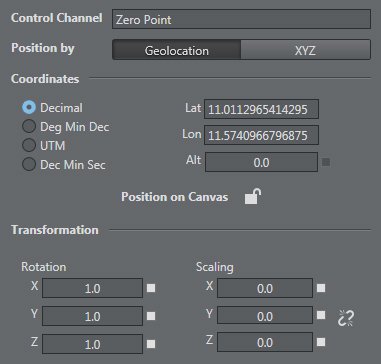

To Set a Zero Point
Right-click on the map OR in the studio area and select Set Zero Here in the context menu. | |
It’s also possible to lock or unlock a zero point position on the map canvas. |

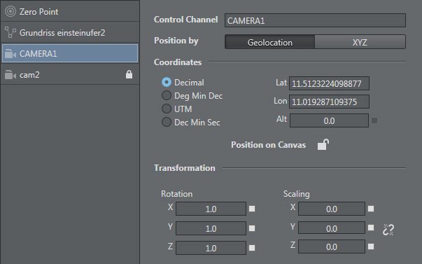

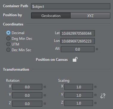

Once an element (like a camera) has been added, it's possible to edit the parameters:
Position – choose between
geolocalization: latitude, longitude, altitude, and type: Decimal, Deg Min Dec, UTM , Dec Min Sec
XYZ
Rotation
Scaling
You can toggle show ruler to make small adjustments to element positions on the map. Rotate canvas by holding down the left cursor button to the desired map position.

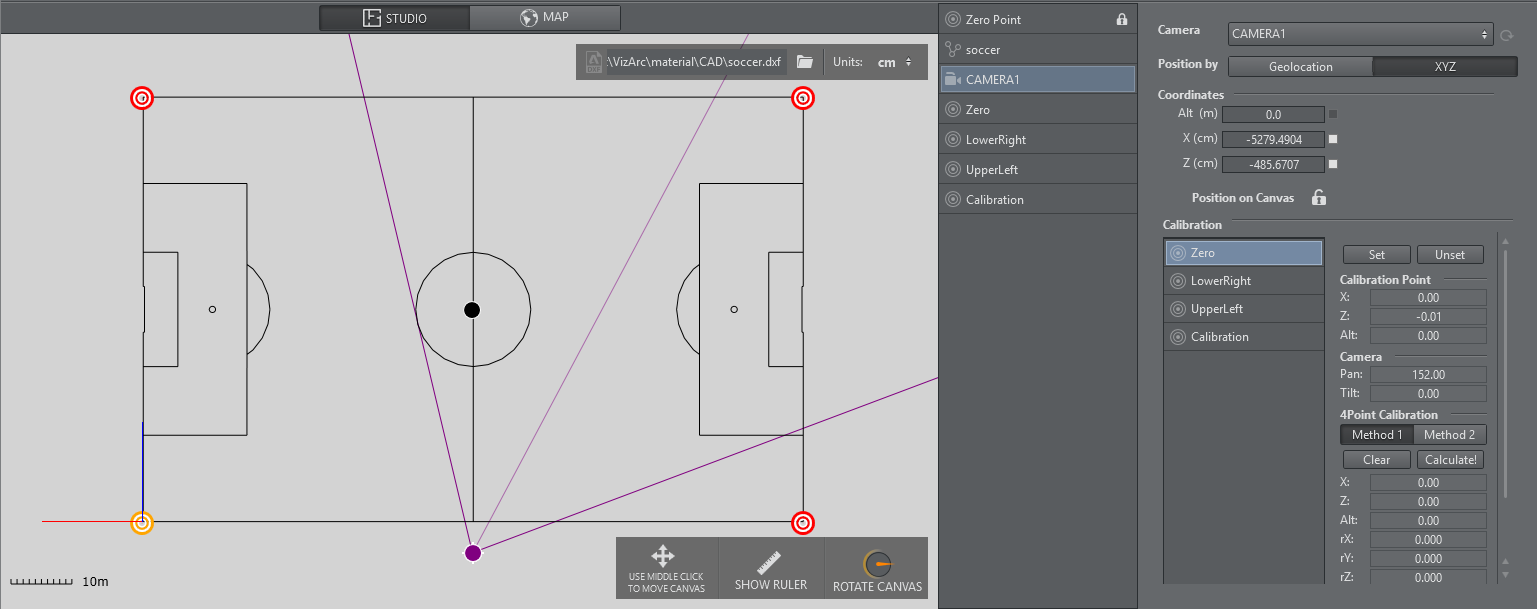

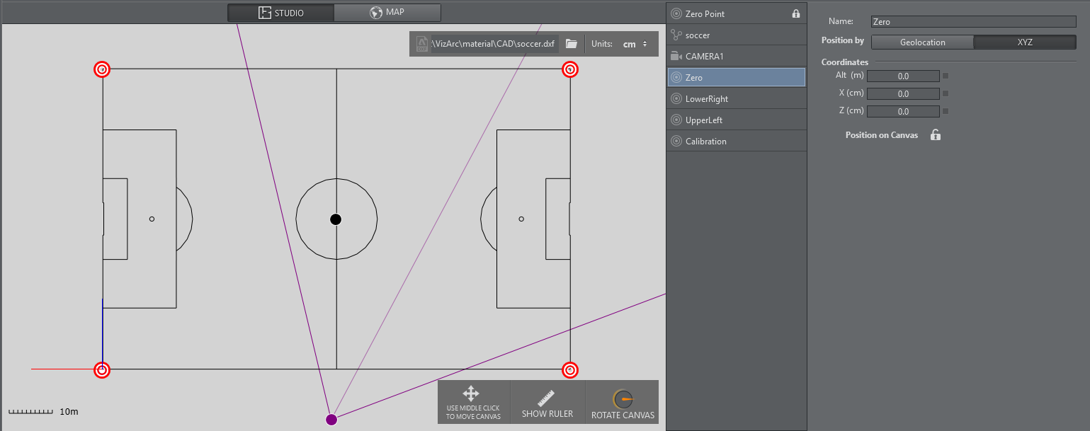

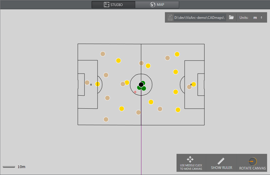

4 Point Calibration
4 Point Calibration can be used to calculate the position and orientation of a (typically mechanically) tracked camera. Using this type of calibration requires knowledge of at least four physical points in the domain (for example, the corners of a soccer pitch or well-known points on a horse race track).
Map View showing a soccer pitch and four calibration points.

Adding Calibration Points
Add calibration points from the map's context menu:

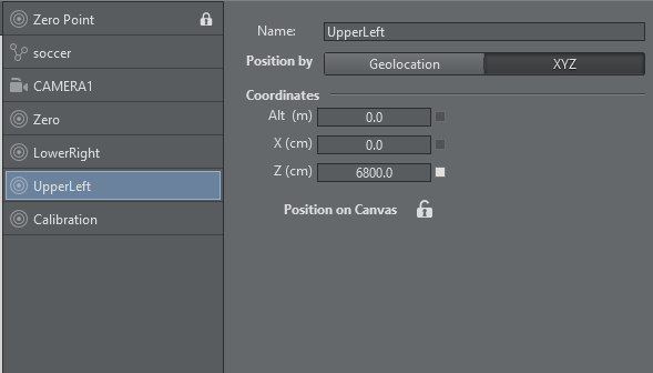

Select the calibration point you just added and move it on the map, or enter its coordinates manually:
Once all calibration points have been added and positioned, the actual calibration process may start.

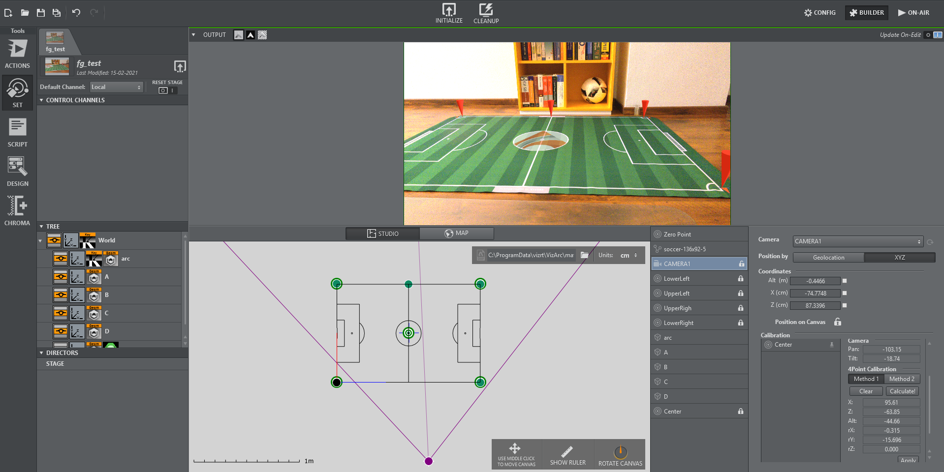

Calibration

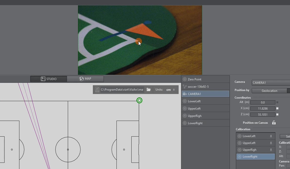

Select the camera to be calibrated.
On the camera user interface select the marker towards which you want to point the camera. The calibration point is colored yellow on the map canvas.
The physical camera should now fully zoom into the marker and try to center it as best as possible.
Once the marker is centered, click the Set button. If your preview has been set up so that the camera is visible and you have a valid lens calibration, you can also click the position in the view instead of using the Set button.
Continue this procedure for all or at least 4 calibration points.

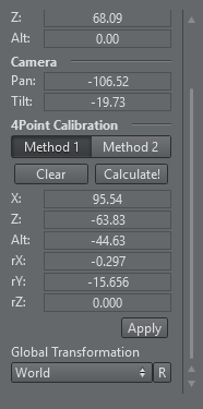

Applying Calibration
Once at least four points have been set, click the Calculate! button to calculate the presumed position and orientation of the camera. You can choose between Method 1 and Method 2, hit Calculate! after switching algorithm. Generally, Method 2 is more accurate but needs more and more accurate calibration points. Try both and pick the one that gives you better visual results.

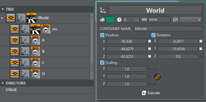

Under the Global Transformation dropdown, select the transformation action holding the world transformation of the main scene (typically the root node of the AR/VR scene).
Click Apply to apply the calculated transformation and rotation.
Use the R button to refresh the list of available transformation actions.
Typically the transformation to be used is the root node of the scene.
Once calibrated you should be able to position AR graphics on your pitch.
