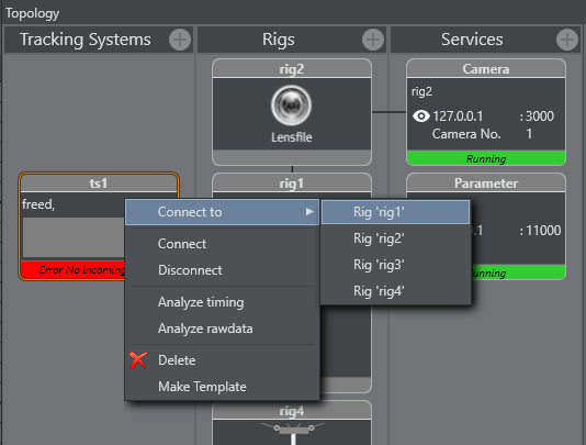

Tracking Systems
The Tracking System panel represents the tracking software in the studio. Click on a tracking system icon to view its properties (see Parameter Panel). A line from the tracking system represents a connection to a Rig.
images/download/attachments/95394696/setup_tracking_panel.png

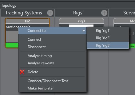

Right-click Menu:
images/download/attachments/95394696/image2020-2-14_12-48-31.png
  • Connect to: Connects to a Rig.
  • Connect/Disconnect: Connects to or disconnects from the tracking system.
  • Analyze timing: Shows time analysis.
  • Analyze rawdata: Enables or disables the collection of raw data for analytical purposes.
  • Delete: Removes the Tracking System.

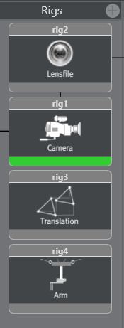

Rigs
images/download/attachments/95394696/image2020-2-14_12-49-8.png
A Rig is the interface between the Tracking System and Viz Engine. Click on any Rig icon to view its properties (see Parameter Panel). A line from a Rig on the left represents a connection to a tracking system (see Tracking Systems). A line from a Rig on the right represents a connection to a Service (see Services).

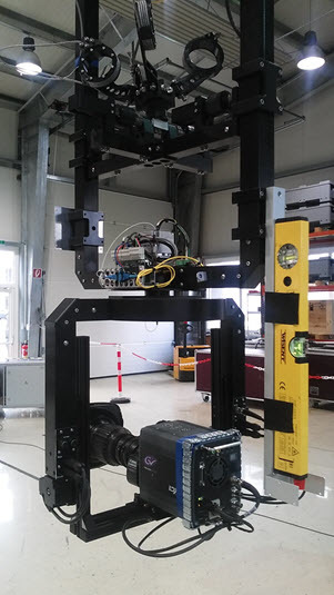

The Arm rig can be rotated in three dimensions, and starts with a swivel. It has a defined length with a defined direction, and offsets between swivel and length. Both the Translation and Arm rigs are used for camera systems such as Spidercam:
images/download/attachments/95394696/panels_20151030_143540.jpg

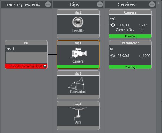

Services
A Service is the element of a Viz Engine which is connected to the Tracking System through the Rig. Click on a Service icon to view its properties (see Parameter Panel). A line from the a Service represents a connection to a Rig (see Rigs).

Topology Connection Lines

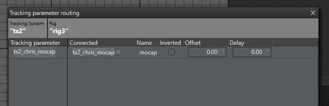

The Topology Connection Lines show the connections between each item in the Topology. Double-clicking a Topology connection line between a Tracking System and a Rig opens the Tracking parameter routing window for the connection:
images/download/attachments/95394696/setup_cross_parameters.png
Topology Colors
The colors of the icons in the Topology view show the working condition:
  • Green: Everything is OK and in regular working condition.
  • Grey: The tracker is not connected or deactivated.
  • Orange: The Service or Tracker state is in warning condition. See the log or message for more information.
  • Red: The Service or Tracker state has a serious error. See log or message for more information.

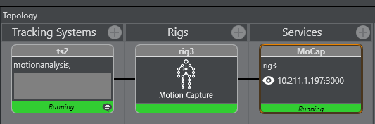

Motion Capturing with Motion Analysis
Motion Capturing is a special way of collecting and forwarding data to an Engine. This mode transmits movements of a person or people instead of camera positions. For these special procedures, there is a new rig and a new service available.
Selectable via the menu:
  • Rigs > Add MoCap
  • Services > Add MoCap service
images/download/attachments/95394696/image2020-2-14_12-51-37.png
Connect the Motion Analysis Tracking System to the MoCap Rig as usual.
images/download/attachments/95394696/image2018-7-3_13-22-41.png
In this case, there is just one axis available.
images/download/attachments/95394696/image2018-7-3_13-24-17.png
The name of the axis depends on the used name in MA's Cortex. Mocap Service can be used as other services.
