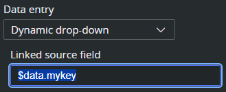

Dynamic Drop-Down Integration
You can use a key in the $data object as a source for Dynamic drop-down, for instance $data.mykey, replacing the use of a traditional model field. The source data is not stored in the payload.
vizrt.$data.mykey = "[{"label": "Tottenham Hotspur", "value": "tottenham"}, {"label": "Liverpool", "value": "liverpool"}, {"label": "Manchester City", "value": "mancity"}]"See also Dynamic Drop-Down.

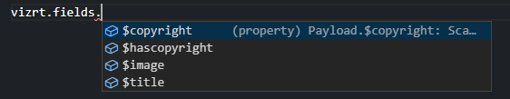

When using the scripting tool in the template, the individual fields must be accessed through the global name space vizrt.fields (for example, vizrt.fields.$singleline.value).
Note: Writing $singleline.value instead of vizrt.fields.$singleline.value does not work, and gives a Compile Error.
The script executes when a graphic element is opened or created with the scripted template in Viz Pilot Edge.
In Template Builder, the script is also re-loaded and restarted when there are changes made to it.

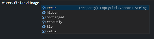

By typing vizrt.fields, the editor's autocomplete shows you the available fields to choose from.
You can read and write field values, as well as react to value changes from outside the script, and access the properties error, hidden, readOnly and tip of the vizrt fields.

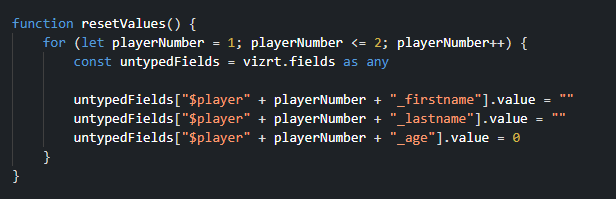

Typescript lets you access fields using known names (for example, vizrt.fields["$field_2"]), but does not allow expressing the field names using variables (for example, vizrt.fields["$field_" + num]), as it is unable to determine whether the field name is valid and what type the field is.
This must be used, for instance, when addressing the layers in a Transition Logic combo template, such as: vizrt.fields["$-vizlayer-TL_FS"].
To overcome this, the type checking associated with vizrt.fields can be locally ignored by using the any type. You may do so inline using for example (vizrt.fields as any)["$field_" + num], or storing it as a new variable, as shown in the example below.
Note: Be aware that when using an object cast to any, the script editor isn't able to help you catch errors like setting a boolean value to a string field, or even trying to access a field that does not exist..

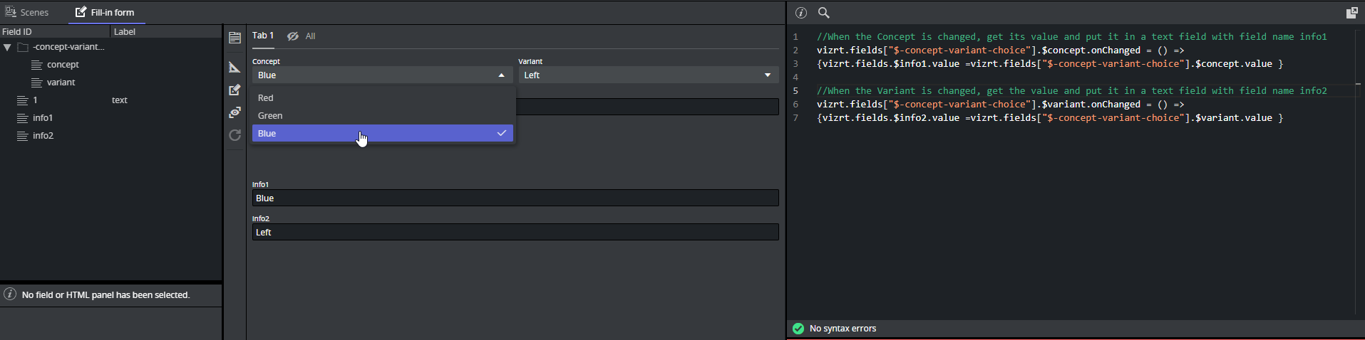

Accessing Concepts & Variants from Scripting
To access the information from concept and variants fields, because they contain dashes, you must use square brackets, as shown in the example below.
//When the Concept is changed, get its value and put it in a text field with field name info1vizrt.fields["$-concept-variant-choice"].$concept.onChanged = () => {vizrt.fields.$info1.value = vizrt.fields["$-concept-variant-choice"].$concept.value }//When the Variant is changed, get the value and put it in a text field with field name info2vizrt.fields["$-concept-variant-choice"].$variant.onChanged = () => {vizrt.fields.$info2.value = vizrt.fields["$-concept-variant-choice"].$variant.value }External Sources
