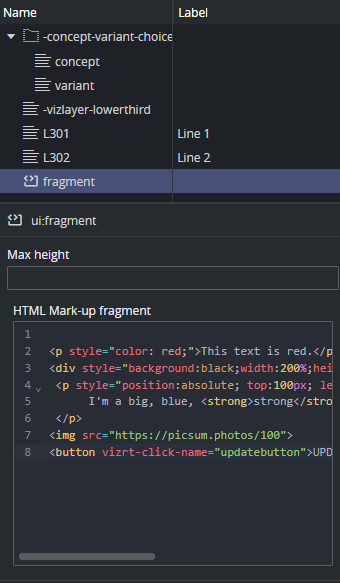

Adding an HTML Fragment to the Auto-generated All Tab
Right-click the field tree.
Select Add UI panel > HTMLfragment.
Add an ID to the new field.
The HTML fragment is now a part of the field tree for the All tab.In the field editor for HTML fragments the maximum height can be set and the actual HTML can be entered. See below for HTML tag and attribute limitations for the HTML entered into the box.

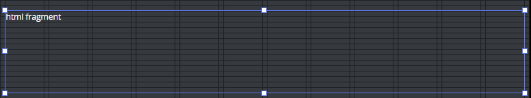

Adding an HTML Fragment to the Custom Layout Tabs
For the Custom Layout tabs, the UI components like HTML panels and HTML fragments, are not part of the field tree on the left. They float inside the custom layout tabs and can only be reached by clicking them in the UI.
To add an inline HTML fragment into a custom layout tab, follow these steps:
Create or select a custom layout tab.
In the middle toolbar, click the Add HTML fragment to current view button.
Enter an ID for the fragment.
A new HTML fragment is now added to the form.
Click the ruler to toggle edit and view mode: .

In the HTML fragment:
<button vizrt-click-name="updatebutton">UPDATE</button>The name can then be checked for internal template scripting:
vizrt.onClick = (name: string) => { if (name === "updatebutton") { // Do something }}Example

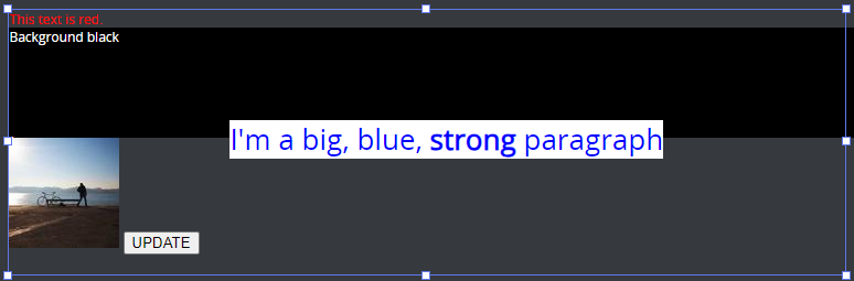

Inside the HTML fragment, you can basically use HTML tags without scripting nor links, and with inline CSS styling. This is due to security and layout reasons, but there is quite a lot of flexibility still.
<p style="color: red;">This text is red.</p><div style="background:black;width:200%;height:100px">Background black</div> <p style="position:absolute; top:100px; left:200px; background:white; color:blue;font-size:26px;"> I'm a big, blue, <strong>strong</strong> paragraph </p><img src="https://picsum.photos/100"><button vizrt-click-name="updatebutton">UPDATE</button>You then have the following panel:
