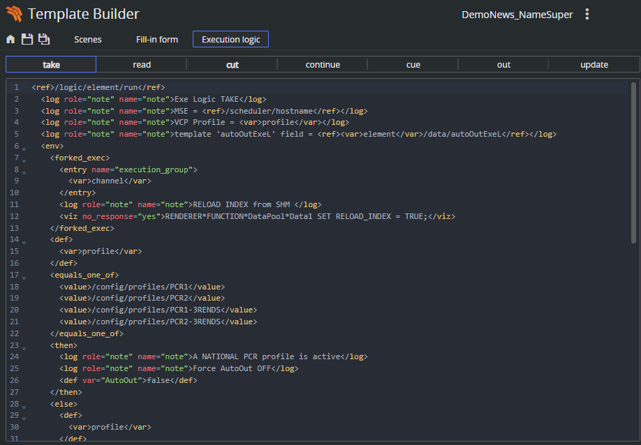

Execution Logic Editor
The Execution Logic editor consists of two parts, a list of commands and an XML editor for the MSE commands. In addition there is a status bar displaying syntax errors.
Command list: The top toolbar displays the available commands. If a command is written in bold, it has custom logic inside. It is possible to implement some commands but not all. The commands left empty behave as normal. It can also be useful to prevent some commands, then inserting a log line only logs and does not execute the default action. For instance
<log>CUE not supported.</log>Command editor: Displays the currently selected command and its execution logic. Available context menu option is Insert Default Action.
Insert default action: Inserts the default command
<ref>/logic/element/run</ref>.

In the Execution Logic Editor, select the “take” command, add the logic into the editor (right pane). This means that when a “take” is issued on a data element based on this template, Media Sequencer executes the logic.
The commands are modified to do a "take","continue" and then an "out". The timecode for each operation must be set.
<relative> <env command="take" timecode="00:00:00:00"> <ref>/logic/element/run</ref> </env> <env command="continue" timecode="00:00:05:00"> <ref>/logic/element/run</ref> </env> <env command="out" timecode="00:00:10:00"> <ref>/logic/element/run</ref> </env> </relative>Note: The running/outer context takes precedence over attributes on the “ref”. Instead of adding attributes on the “ref” node, you use an “env” node as in the example above.
