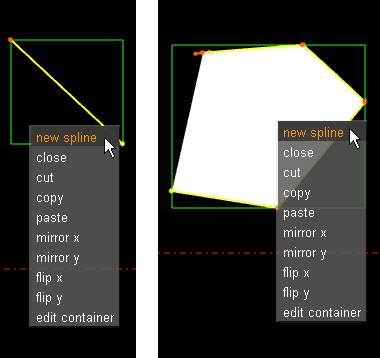

Polygon Scene Editor Context Menu
Right-click, and hold, in the polygon green bounding box, in the Scene Editor, to open the polygon context menu. To select a menu option see To Select an Option from the Context Menu.
Note: The right-click must be inside the created polygon shape box. If a click is outside the bounding box then the standard Scene Editor menu is shown.
New spline: Creates a new polygon in the same container.
Close/Open: Opens or closes a polygon.
Cut: Cuts the selected polygon or spline nodes.
Copy: Copies the selected polygon or spline nodes.
Paste: Pastes the selected polygon or spline nodes.
Mirror X/Mirror Y: Mirrors the created shape in the X or Y axis.
Flip x/Flip y: Flips the created shape in the X or Y axis.
Edit container: Opens the Container editor and exit polygon edit mode. To edit the polygon again, click on the polygon icon in the properties editor or the Scene Tree.

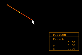

To Create a Simple Spline
Create a Container.
Add the Polygon plug-in.
Click on the Polygon icon (in the Container or the Properties editor).

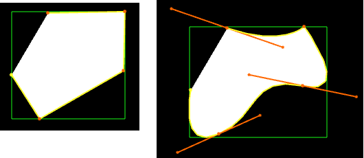

The polygon splines are created by each click in the Scene Editor:
Click in the Scene Editor to create a spline point
Click and drag in the Scene Editor to create a spline node, complete with handles (continue the drag to increase the length of the handles)
While the polygon plug-in is active, each click in the Scene Editor creates more polygon points, and creates the polygon shape.
Tip: At any time press and release DELETE to remove the last created point. Press and hold DELETE to remove more than one spline, or remove the whole polygon.
Once the spline has been created it can be modified, as required, with various shortcuts (see Polygon plug-in Editor Shortcuts in the Viz Artist User Guide). List below are some common examples:

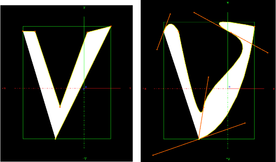

To Create or Delete a Spline Point Handle
Press SHIFT:
Create: Click on a spline point and drag.
Delete: Click on a spline point with a handle.
To Resize a Spline Point Left or Right Handle
Press SHIFT.
Click on a spline point handle and drag. Only the selected handle moves.
To Resize a Spline Point Handle
Press CTRL.
Click on a spline point handle and drag. The left and right handles move as one handle.
Note: The handle clicked on can be lengthened as required. The other handle remains the same length.
Note: If either the left or right handle has been moved individually, this sets the two handles together again.

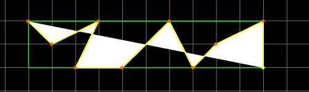

Scene Editor Grid
The Scene Editor Grid Tool-bar can be used as a great tool to help draw polygons. Together with the grid snap option polygon points can positioned, simply and accurately, in the 3D space.
Make sure that the polygon is aligned with the grid for the grid snap to work.
To Create a Spline in the Scene Editor Grid Snap
In the Scene Editor click (Grid).
Click (Plane Type).
Click (Free Grid).
Click (Snap to Grid).
Create a spline. Each spline point snaps to the nearest cross hairs on the grid.

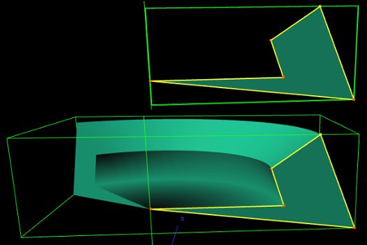

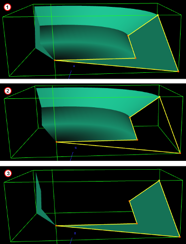

Revolve: Spline Rotation in 3D
The Spline rotation creates a 3D mesh by rotating the created spline.
Use the Polygon Revolve Properties panel to modify the Spline as required.
The Polygon Revolve properties are available after the first spline point has been added to the Scene Editor. Click on Rotate to activate.
Precision: Sets the precision of the spline calculation.
Import: Imports Adobe illustrator files. Opens a window to select a file and import. Only Adobe Illustrator AI 88 format files are supported.
Rotate: Creates the revolve mesh and activate all its settings.
Rotate in degrees box: Sets the degree of rotation.
Tessellation: Sets the degree of detail for the mesh.
Shading Angle: Defines how the shading normal are aligned on the revolve object surface.
Culling: Sets which side of the spline to view:
Back: View the back side of the spline.
Front: View the front side of the spline.
Note: To view both sides at the same time, add the Expert plug-in to the Container and active Back Face.
Revolve Around: Sets the axis to rotate the spline around.
Local Axis: Calculates the rotation around the Container axis when the Rotation angle is changed.
First to Last: Rotates around the first and last spline point (Revolve Axis is grayed out) when the Rotation angle is changed.
Revolve Axis: Sets which axis to rotate around:
Y: Rotates around the Y axis.
X: Rotates around the X axis.
Direction: Sets which direction to view the rotation:
Right-hand: View from the right hand side.
Left-hand: View from the left hand side.
Show Hull: Shows the rotated shape (1 and 2).
Show Caps: Shows the original polygon shape at the beginning and end of the rotation (1 and 3).
To Rotate a Spline
Create a spline.
Click on Rotate.
Modify the created 3D object with the Polygon Revolve Properties.
