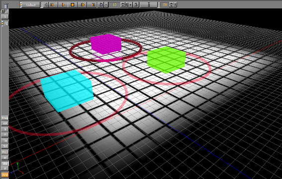

6DOF (6 Degrees of Freedom)
6DOF is a tool for artists, script writers and plug-in developers to position and orientate objects in the 3D space (three translation and three rotation axes => 6DOF).
6DOF works directly with the built in Scene-Grids (see Grid Tool-bar) and uses them to calculate the intersection of the projected user input (mouse or touchscreen position) with the current grid plane. As soon as a touch or click input is detected, it triggers the corresponding 6DOF callbacks (OnButtonDown6DOF, OnMove6DOF, etc...) and passes the calculated position and rotation.
For example: This could be used to move players on a football field interactively without doing any math at all.
Additionally, 6DOF has a distribution mechanism which can send the user input to multiple engines, at the same time. This is configured in the Global Input of the Viz Configuration (see the Viz Engine Administrator Guide)
