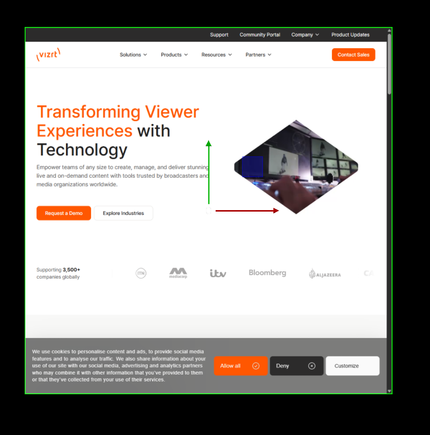

To Create a Simple Scene with Browser
  1. Add a the browser plug-in to a container
  2. A quad and a Phong material is added automatically.
  3. Open the Browser properties and enter a valid URL.
  4. Click on image-20251217-142941.png (enable the handling of interactive script/plug-in events (Scene Editor)).
  5. Use the mouse or controls to navigate the website.
