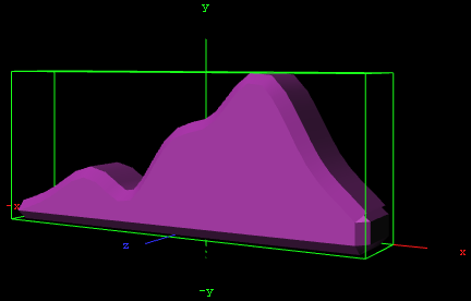

To Create a Scene with Area Chart
Create a new Container.
Add the Area Chart plug-in.
Open the Transformation Editor.
Set these parameters:Position X:
-100.0.Position Y:
-100.0.Rotation Y:
-25.0.
Add a Material and/or a Texture.
Open the Area Chart editor.
Enter these parameters:
Set DataY values:
10,20,30,20,50,60,80,45,20.Set Type to
Spline.Set Chart Width to
200.0.Set Chart Depth to
30.0.
