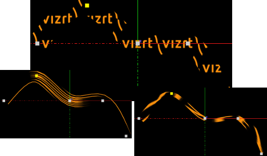

The 2D Ribbon plug-in is a curved strip. It is ideal to make customized curves to symbolize, for example, frontiers on a map or similar. The way the object is curved is easily edited in the 2D Ribbon property editor. It is possible to enable inter activity so that counterpoints of the ribbon can be dragged with the cursor.

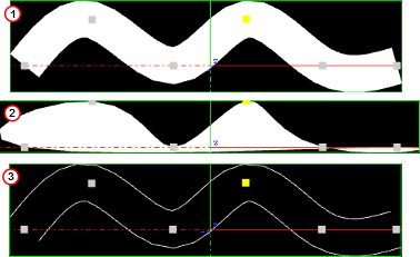

The 2D Ribbon can be used in Ribbon (1), Filled Area (2) or Double Outline (3) modes:

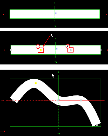

To Create a 2D Ribbon
Add the 2D Ribbon plug-in to the Scene Tree.
Set Interactive Mode to
On.Set the Number of Control Points.
Note: This number can be changed at any time. New points are distributed along the already defined ribbon (2).
Open Reset Options:
Enter (estimate) the Ribbon Length and Ribbon Width (enter a new figure and press ENTER).
Clickto activate the settings.
Toggle the Constant Width, as required.
Position the 2D Ribbon in the Scene.
Note: If the 2D Ribbon is to be on some horizontal plane, it might be easier first to edit it in the default orientation, and afterwards rotate it to the right place. There is no problem to continue work on it after the rotation has been made, but because of the perspective, it might be less straightforward.
Click the (Events) button in the Scene Editor.
Modify the 2D Ribbon shape, either:
Use the mouse cursor to modify the Control Points. Click on or near the Control Point. The selected control point shows yellow (1).
Left button: Click and drag the nearest Control Point.
Right button: Modifies the 2D Ribbon width.
or
Set Show Control Points Values to on. Modify the Control Points as required.
Note: If the Container, which contains the 2D Ribbon plug-in, is selected, and Interactive Mode is set to On, one Control Point is always active.
