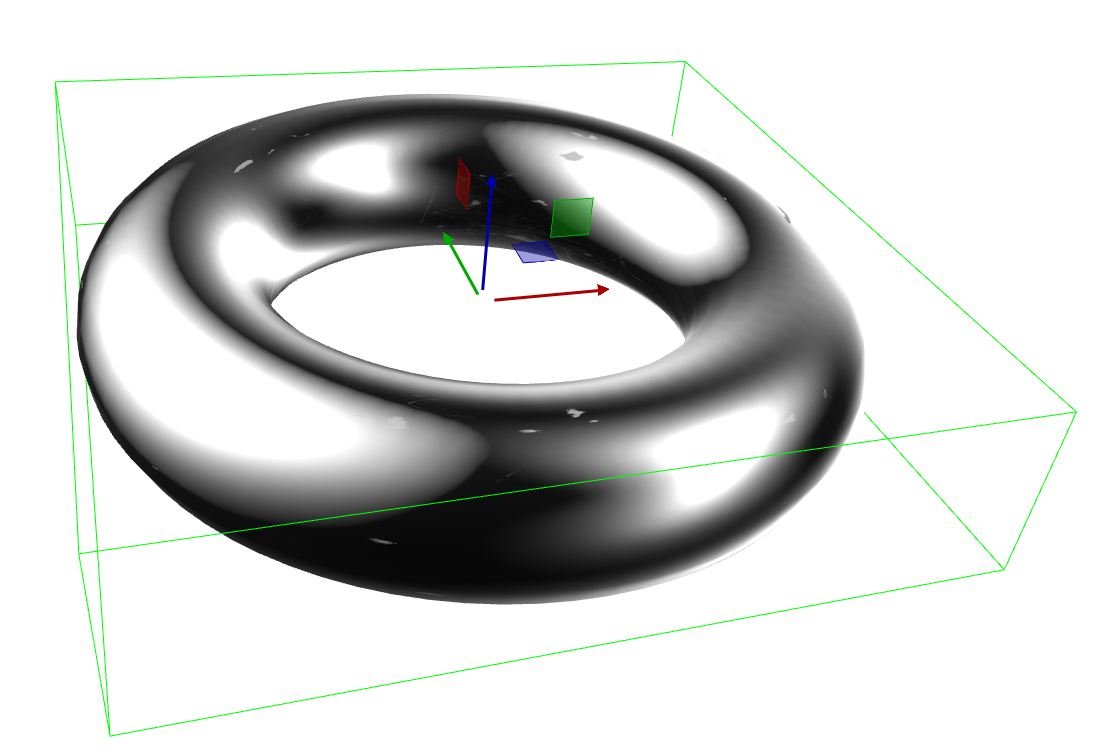

The Torus plug-in creates a torus with different attributes.
Torus Properties
Use LOD: Enables/disables dynamic level of detail.
Tesselation: Sets the degree of detail for the torus.
Corners: Sets the number of corners on the torus.
Radius: Sets the radius of the torus from its center in the middle of the hole.
Radius cross section: Sets the radius of the torus cross section or “tube”.
To Create a Torus
Create a new group and add the Torus plug-in to it.
Open the Torus editor and set the following parameters:
Set Radius to
50.0.Set Radius cross section
20.0.
Add a material and/or a texture to it.
