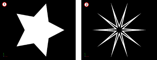

Create a new container.
Add the Star plug-in to it (1: Default Star).
Open the Star editor.
Modify the Star parameters, for example (2: Modified Star).
Corners:
10.Star Radius:
60.Star Inner Radius Factor:
6.0.Hole:
On.Hole radius:
50.Hole Inner Radius Factor:
9.0.
If required, add a material and/or a texture.
