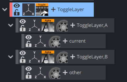

Toggle plug-in is one of the main building blocks of Transition Logic, and it is in general a relatively simple plug-in. When the Toggle plug-in is added to a container, it creates two child containers that act as placeholder containers for objects that can toggle on and off screen. In addition, it also creates some utility directors in the stage.
Toggle Placeholder Containers
The two placeholder containers correspond to an A-side and a B-side. Each of the placeholders again have a child container; one named current the other named other. The current is typically the visible container, while the other is not visible. At the time of a switch, these containers switch names. This means that at any given time it is not possible to know if the current parent is the A side or the B side. It is the responsibility of the Toggle plug-in to keep track of this.

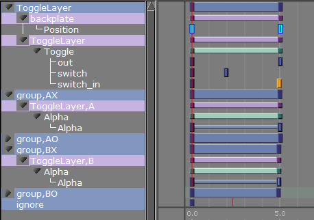

Toggle Directors and Key Frames
The Toggle plug-in creates two directors each containing a default one second cross fade animation. These animations are placed in the AX and BX directors. AX can be interpreted as the A-side cross fade. The animations can be modified to show any kind of transition, but it is important that the AX and BX are the same.
In addition to the cross fade directors the Toggle plug-in also creates placeholder directors for the object animations. Merged objects that are loaded into these placeholder containers during playback may contain animations embedded in the geometry object. The object animations are automatically added as a sub-director to the AO or BO director depending on if the object is being loaded on the A-side or B-side.
Caution: It is NOT recommended to manually adjust the AO and BO directors.
There are two different scenarios of when the utility directors are triggered:
When there is a state change. When there is a state change, the Toggle-Layer director is animated from the current state to the required next state. In this scenario, the utility directors are triggered according to the toggle Key Frames in the stage. This means that it is the position of these Key Frames that determine the timing of when the utility directors are triggered.
No state change, only changing the current object. When there is no state change, there is no movement of the Toggle-Layer director. In this case, the Toggle switch action is triggered, which animates the utility directors at the same time; animating the current object out and the next object in at the same time.
