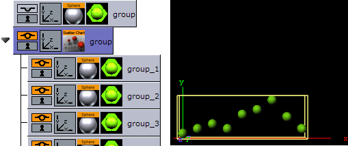

To Create a Scatter Chart
Create a group and add the Sphere plug-in to it.
Open the transformation editor and set the Scaling (locked) to
0.2.Add a material and/or a texture to the sphere.
Set the group with the sphere to hidden.
Create a new group and add the Scatter Chart plug-in to it.
Open the Transformation Editor and set Position X and Y to
-100.0.Open the Scatter Chart editor and set the following parameters:
Set the following DataY values:
10,20,30,20,50,60,80,45,20.Set Width to
250.0.Drag and drop the container with the Sphere to the Container placeholder.
