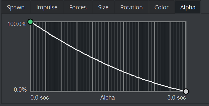

Alpha
In the Alpha panel set the alpha values of the particles throughout their life cycle. The alpha editor contains a curve with points that can be moved, in both X and Y directions, to change the form of the curve. The X axis is the life time of the particles and the Y axis is the alpha value.
To select a point, or create a new one, left-click on the graph and drag the point to the required X and Y position. To delete a point, select it and press DELETE on the keyboard.
