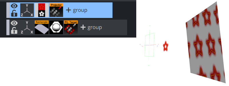

To Project a Texture onto an Object
Add a group container to the scene tree, add the Projector and Alpha to it, an image/texture, and name it
Source.Open the Alpha editor and set the alpha value to
50.0%.Open the transformation editor for the Source container and set Rotation Y to
135.0.Add another group to the scene tree, and name it
Target.Open the transformation editor for the Target container, and set Position X to
130.0.Add a Sphere geometry, material, image/texture and the Projector Target plug-in to the Target container.
Optional: Animate the sphere.
Open the Projector editor and disable the Show property.
