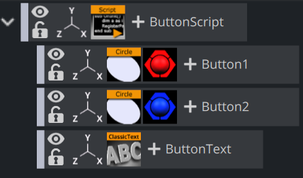

To Create a Simple Scene with the MtButton Plug-in
Note: If a touch screen is not available, set Multi Touch input to Mouse in the Communication section of Viz Configuration (see the Viz Engine Administrator Guide ).
Create a new Scene.
Add a new group Container.
Name the group Container ButtonScript.
Add Script to the ButtonScript Container (Container plug-ins > Global).
Open the Script Editor and type this script:
sub OnTap(HitContainer as String, Id as String, HitPoint as Vertex, Taps as Integer, plug-inContainer as String, FirstChildContainer as String)dim bt as Containerdim text as Stringbt = FindSubContainer("ButtonText")text ="OnTap(\n HitContainer = "& HitContainertext &="\n Id = "& Idtext &="\n HitPoint = "& HitPointtext &="\n Taps = "& Tapstext &="\n plug-inContainer = "& plug-inContainertext &="\n FirstChildContainer = "& FirstChildContainer &"\n)"bt.Geometry.Text = textend subClick Compile and Run.
Add three Sub-containers. Name them, in order:
Button1
Button2
ButtonText
Add a Circle Geometry to the Button1 and Button2 Containers.
Use the Circle Geometry Transformation editors to move the two circles so that both can be seen.
Right-click the Button1 and Button2 Containers, in turn, and select Add Material… from the context-menu. Open the Material Editor and define a color for both Containers.
Add MtButton to the Button1 and Button2 Containers.
In the MtButton editor:
Type
myButton1in the Button1 Id fieldType
myButton2in the Button2 Id fieldIn Trigger Type field click On Tap for both containers

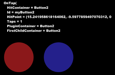

Add a Font to the ButtonText Container.
Open the Scene in On Air.
Click on each button, in turn, and see the text change with each selection.
Use the MtButton editor to modify the button’s actions, as required.
