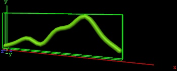

To Create a Line Chart
Create a new group and add the Line Chart plug-in to it.
Open the Transformation Editor and set Position X and Y to
-100.0and Rotation Y to-25.0.Add a material and/or a texture to it.
Open the Line Chart editor and set the following parameters:
Set Shared Mem. to Inactive
Set the following DataY values:
10,20,30,20,50,60,80,45,20.Set Line Type to Spline.
Set Chart Width to
250.0.Set Depth to
10.0.Enable Bevel, Bevel Start, Bevel Stop.
Set Bevel Size% to
100.0.Set Bevel Steps to
10.0.|
