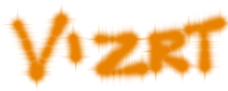

The Graffiti Texture plug-in gives the ability to draw freehand on top of flat containers, such as rectangles. The freehand draw is created with a brush shape, used with a mouse, 6DOF device, or multi touch device. The plug-in can also recognize some rendered shapes, such as circles, ellipses, crosses, and arrows, and replaces the hand-drawn item with the recognized shape.
6DOF (6 Degrees of Freedom) events are triggered for all layers, but the Main Layer (see Layer Manager) has priority over the Front and Back Layers. This means that if the Front Layer scene grid is to be used for 6DOF, then the grid in the Front Layer must be set to active, and the grid in the Main Layer must to be set to inactive. If there is no grid defined in any of the three Layers, an orthogonal XY 2D grid is used (see Grid Tool-bar).
The plug-in can either work in combination with Viz Engine’s multi-texturing technology or can add a standalone texture.

To Create a Container Level Graffiti Effect
First, add the plug-in to the container and set the plug-in properties.
Then set Viz Artist in On Air Mode, and start drawing.
