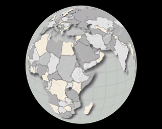

The Globe plug-in enables geographic referencing options over a globe, used as a base object with maps.
The globe object geographically references the map at the correct location over the globe.
