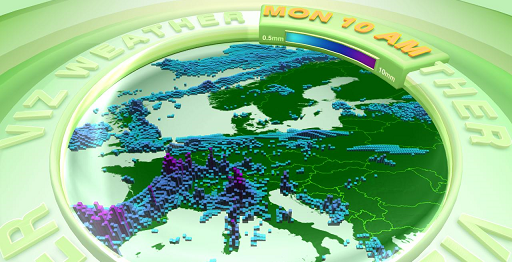

Weather precipitation data. | |
Weather precipitation data clipped to a region. | |

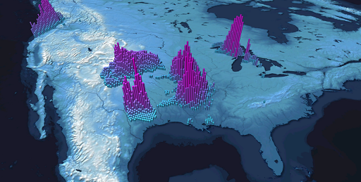

Social TV scene showing population of a particular word in Twitter. | |

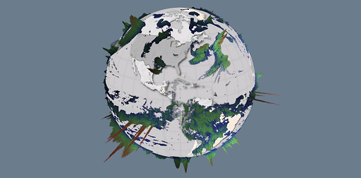

Weather precipitation data on the globe. | |

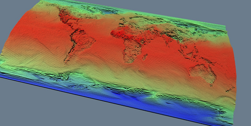

World temperature values. |
