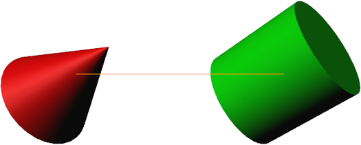

To Connect Two Objects
Create a new group and add the Connector plug-in to it.
Create two new group containers and add a geometry object (for example, Cylinder and Cone) to each group.
Open each container’s transformation editor and move the objects a part.
Add a material and/or an image to the geometry objects.
Open the connector plug-in editor and drag and drop the two containers to the Container 1 and Container 2 placeholders, respectively.
Adjust the color line.
Open the Connector plug-in editor and play with the settings.
Add more objects to Container 2 and animate it.
