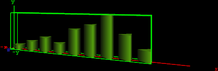

To Create a Bar Chart
Create a new group and add the Bar Chart plug-in to it.
Open the Transformation Editor and set Position X and Y to
-100.0and Rotation Y to-25.0.Add a material and/or a texture to it.
Open the Bar Chart editor and set the following parameters:
Set the following DataY values:
10,20,30,20,50,60,80,45,20.Set Corners to
3.Set Bar Width to
20.0.Set Bar Gap Ratio[%] to
10.0.
