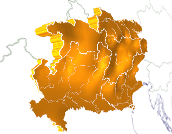

The 3D Region plug-in applies a graphic design to selected regions of the map.
The designs are defined in the scene and linked in CWMClient to create the regions received from the maps server.

Fill: Adds a region object to the map, and if fill is applied, how regions are built on the map (either flat on the map (no width) or extruded).
None: Does not add a region object to the map.
Extrude: Adds and extrudes regions over the map. When extrude is used, additional parameters are enabled.
Flat: Adds a flat object (Extrude=
0).
Include Bottom: Builds the bottom of the region when extruded.
Center Z: Sets the Z axis location of the region object, with relation to the map: bottom, center or top.
Type: Defines how the Height parameter is calculated.
Absolute Height: Defines the regions extrusion height value as Viz units.
Relative Height: Defines the regions extrusion height value as a percentage of the regions size.
Show Terrain: Enables 3D Region to take into account any terrain data for a selected region. Adjust the Terrain Height Scale parameter. For this to work you need to enable the Fetch Terrain Data option in CWMClient.
Terrain Height Scale: Adjusts the terrain height.
