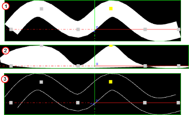

The 2D Ribbon can be used in Ribbon (1), Filled Area (2) or Double Outline (3) modes:

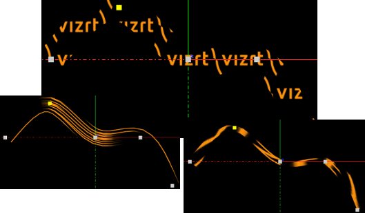

Texture Options: Enables 2D Ribbon Texture options when set to
On
:Texture Direction: Shows the texture in different directions. For example, if a pointer right-shows used as texture, the pointer shows to the right side if the Horizontal option is activated. Otherwise, to the left side if the
-Horizontal option is set. Same for the Vertical and -Vertical option. The rendered pointer shows to the top or to the bottom side.Texture Head Location: Moves the texture either to top or bottom direction.
Texture Length: Stretches the texture.
Use Texture Factor: Enables the texture factor parameter when set to
On
Rotate Around X Axis: Rotates the created 2D Ribbon around the X axis when set to
On
.Show Spline: Shows the spline of the 2D Ribbon when set to
On
.Use Progressive Visualization: When set to
On
the activated parameters affect the rendering:Progress Mode: Slices the curve in the x-direction by length or by the control point index. Select from two options, By Length and By Control Points.
Path Position: Limits the workspace so there are less control points to prepare.
Render Bumps: The curves are top-barbed which is useful for weather broadcasting.
Warm: Gives a rounded edge to the bumps.
Cold: Gives a sharper edge to the bumps.
Occluded: Gives alternating warm and cold bumps.

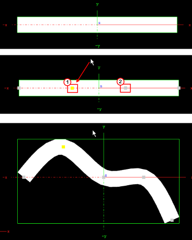

To Create a 2D Ribbon
Add the 2D Ribbon plug-in to the Scene Tree.
Set Interactive Mode to
On
.Set the Number of Control Points.
Note: This number can be changed at any time. New points are distributed along the already defined ribbon (2).
Open Reset Options:
Enter (estimate) the Ribbon Length and Ribbon Width (enter a new figure and press ENTER).
Click
to activate the settings.
Toggle the Constant Width, as required.
Position the 2D Ribbon in the Scene.
Note: If the 2D Ribbon is to be on some horizontal plane, it might be easier first to edit it in the default orientation, and afterwards rotate it to the right place. There is no problem to continue work on it after the rotation has been made, but because of the perspective, it might be less straightforward.
Click the
(Events) button in the Scene Editor.Modify the 2D Ribbon shape, either:
Use the mouse cursor to modify the Control Points. Click on or near the Control Point. The selected control point shows yellow (1).
Left button: Click and drag the nearest Control Point.
Right button: Modifies the 2D Ribbon width.
