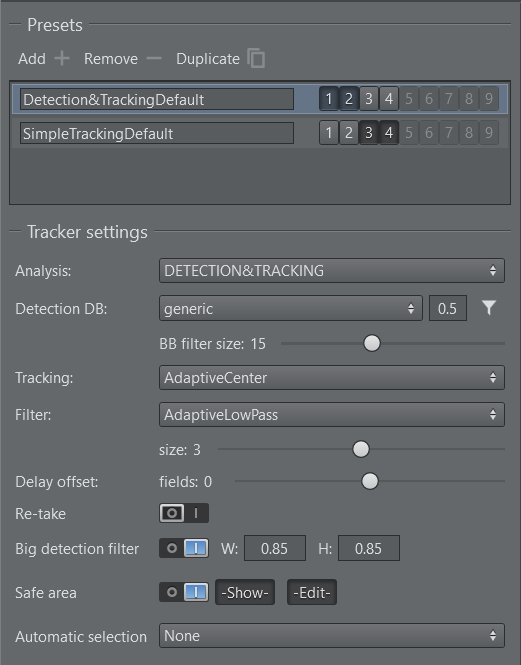

Presets
It is possible to create multiple presets where you can select which tracking algorithm to use and which neural network to work with for the AI tracker. Each algorithm has specific settings which are exposed in the Tracker Settings. One or more Tracking ID(s) can be assigned to a preset. All active presets (the ones that have at least one tracking ID assigned) run altogether and the Object Tracker switches algorithms seamlessly according with the current tracking ID.
Tracker Settings

Detection and Tracking
This option selects the AI tracker based on a neural network.
Detection DB
The network to be used can be selected under Detection Types.
The generic network is always available and offers a couple of standard objects that it recognizes (for example, people, cars, etc.).
The number besides the dropdown represents a threshold in the range of 0.0 to 1.0. It represents a factor of confidence of how well an object has been detected. The higher the value, the higher the probability the detection is correct. Object with a low confidence score can be ignored by using this threshold value. Depending on the quality of the images and the neural network, this value can be adjusted to improve the overall tracking.

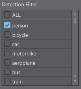

The list of available objects is shown if the button Detection Filter is pressed. This is the list of objects that are recognized by the neural network.
Detection Filter
Select which objects of you want to detect. In most cases, you would like to select one or two kind of objects in a video stream.
BB (Bounding Box) Filter Size
The bounding boxes undergo a different filtering than the actual tracking point as it is more noisy and is subject to more extreme and sudden changes over time (for example, a person walking). You can configure a filter size for smoothing the bounding boxes for the tracking output. It is particularly useful when graphics need to be aligned to the bounding box. If you're using the Simple Tracking, the bounding box size slider is disable since there are no bounding boxes.
Tracking
The Tracking Types dropdown lets you choose what kind refined tracking to use inside of the detected bounding box. The button next to the drop down sends the new settings to the Object Tracker without having to use the global initialize button.
  • AdaptiveCenter: Extracts color/luminance features around the center of the bounding box. A gravity force re-centers the tracking point toward the center of the bounding box over time to avoid drifting.
  • AdaptiveTop: Extracts color/luminance features towards the top area of the bounding box. This is typically used when tracking persons as the arms and legs might move too much for a stable tracking, while the area of the chest and head are more stable and yield better tracking results. As for the tracker above, a gravity force re-centers the tracking point toward the center of the bounding box over time to avoid drifting.
  • MagneticCenter: Works as AdaptiveCenter but when the object is not detected it uses the same algorithm of the Simple Tracking - Adaptive to try to follow the object; the downside is that the tracking is never lost, the operator has to manually turn off the tracking.
  • MagneticTop: Works as AdaptiveTop but when the object is not detected it uses the same algorithm of the Simple Tracking - Adaptive to try to follow the object; the downside is that the tracking is never lost, the operator has to manually turn off the tracking.
  • TrackerCenter: Extracts features around the center of the bounding box. A gravity force re-centers the tracking point toward the center of the bounding box over time to avoid drifting.
  • TrackerTop: Extracts features towards the top area of the bounding box. A gravity force re-centers the tracking point toward the center of the bounding box over time to avoid drifting.
  • Simple: Uses the center of the detected bounding box as tracked reference.
Filter
Filter Types
The filter types allow you to filter the tracked point over time. Several are available. The button next to the drop down sends the new settings to the Object Tracker without having to use the global initialize button.
  • AdaptiveLowPass: Minimizes jitter and lag using a low pass filter.
  • MovingAverage: Calculates the average of the last points.
  • ExponentialMovingAverage: Gives more weight to the most recent points. Similar to MovingAverage.
Size
Increasing the size of the filter helps to smooth noisy results.
Warning: Be very careful when using filters. In most cases, they lead to undesired lags especially for rapid and sudden changes in direction of the tracked object. The larger the size of the filter, the larger is the lag. However, the filters might be very beneficial on smooth and slow movements of objects.
Re-take
When enabled, if a tracked object is lost and later detected again with the same ID, it automatically resumes tracking. However, if the safe area is enabled, the object is only re-tracked once it is inside the defined safe area.
Big Detection Filter
When enabled, it filters out any detections whose size exceeds the specified width or height limits. This can be useful for eliminating certain false positives. The threshold values are within the range of 0.0 to 1.0.
Safe Area
When enabled, if a tracked object exits the boundaries of the rectangle, it is automatically removed. Objects can still be tracked outside the safe area, but once they enter it, the safe area rules apply.
You can adjust the size of the safe area by enabling the Edit button and dragging the edges of the rectangle.
You can show or hide the safe area from the preview by clicking the Show button.
Automatic Selection
There are three different algorithms to choose from:
  • None: Disables automatic detection.
  • Score: Selects the object with the highest score.
  • Center: Selects the object closest to the center of the image.
Currently, the algorithm selects only one object and uses the first pointer configured in the preset. For example, if pointers 2 and 3 are enabled for analysis, the automatic selection uses pointer 2. If the safe area is enabled, only the detection inside the rectangle are considered. If the safe area is enabled, only detections within the rectangle are considered.

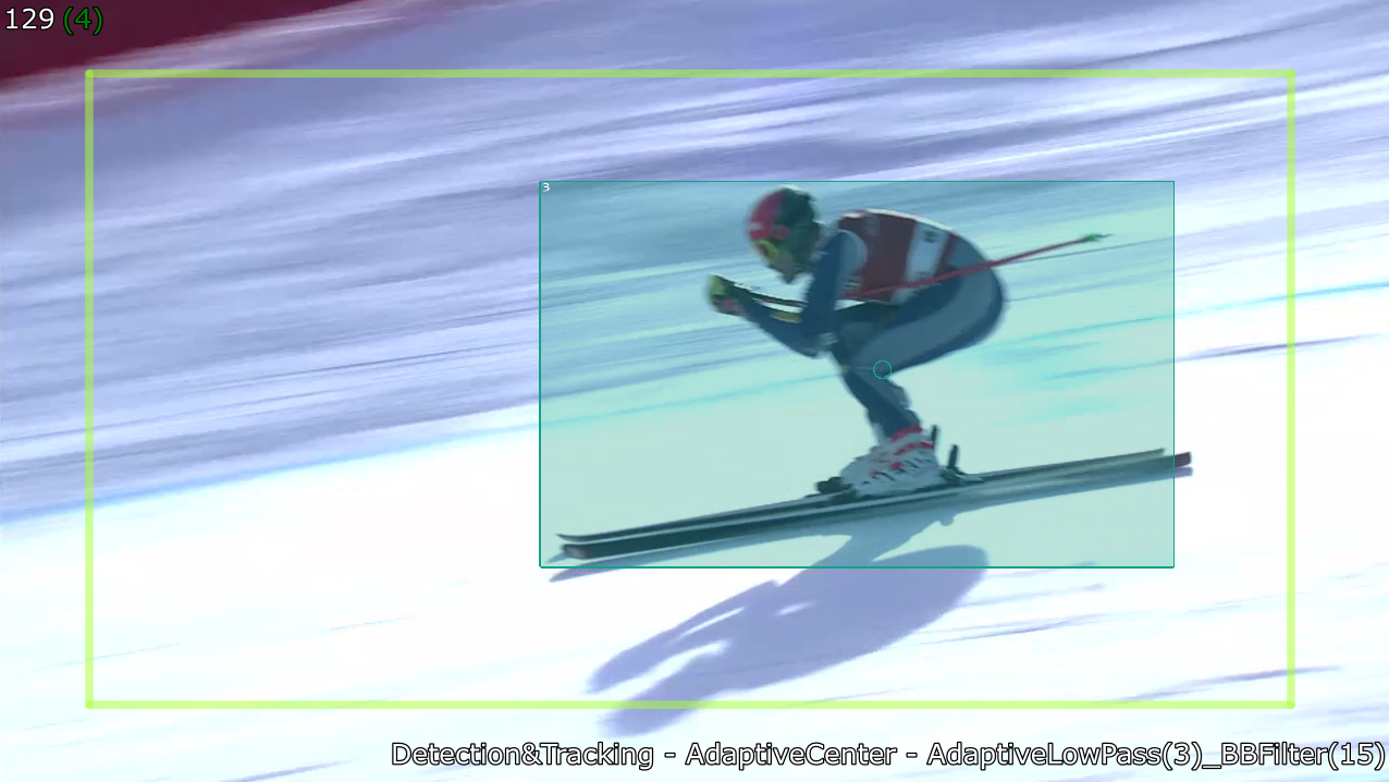

Detected object's bounding box
An example of a bounding box of a detected person object.

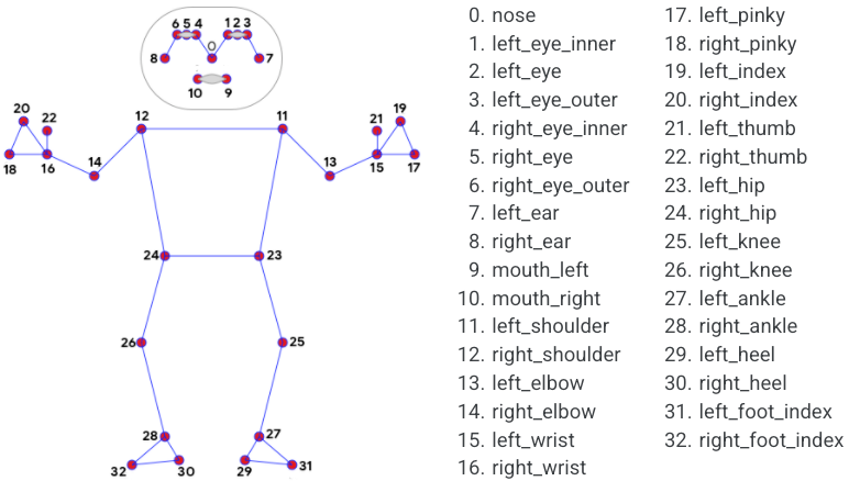

2D Pose Tracking
This mode allows you to track the pose of one person.
This is the map of the points sent to Viz Engine(s):

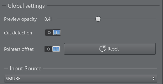

Global Settings
Preview Opacity
The preview output that has been configured in Viz Arc can be rendered on top of the NDI stream coming from the Object Tracker. This allows the operator to preview the graphics on screen. The opacity of this preview can be adjusted here.
The preview is intended to verify the editorial graphics content and not the accuracy of the tracking.
Information: For performance reasons, the composed on-screen preview might not look the same as on the actual program output. Make sure the fill channel of the preview is black where it is supposed to be transparent. The timing between the underlying NDI stream and preview is not guaranteed to be correct. The tracking and the preview graphics might not match.
Cut Detection
If enabled, when a video hard cut is detected all current trackers are lost.
Pointers Offset
It resets the pointers offset of each tracking input.
Input Source
Select SMURF to select the Engine's input running where the Object Tracker has been installed. When installing Viz Arc locally, you are also able to select a file. This workflow is intended for testing only as it is not guaranteed to run in real-time.
