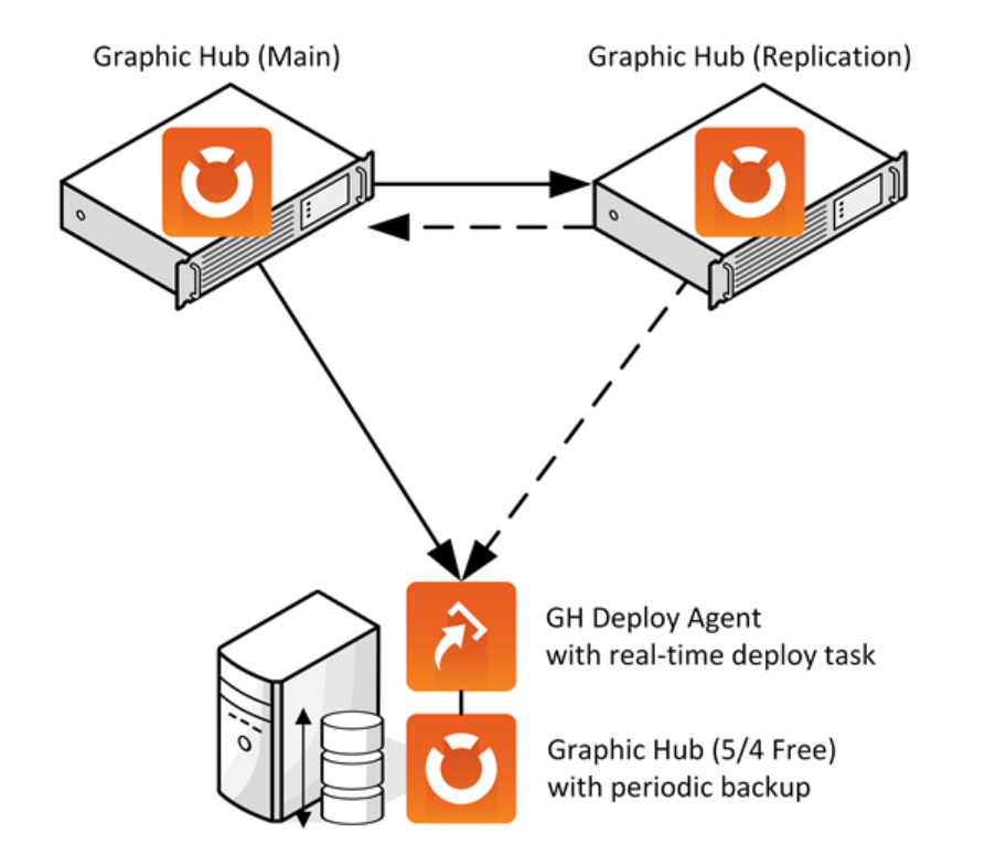

Adding a backup server adds another level of redundancy to the Graphic Hub server. This section describes how to configure and restore from a Graphic Hub backup server in running in 5/4 Free mode.

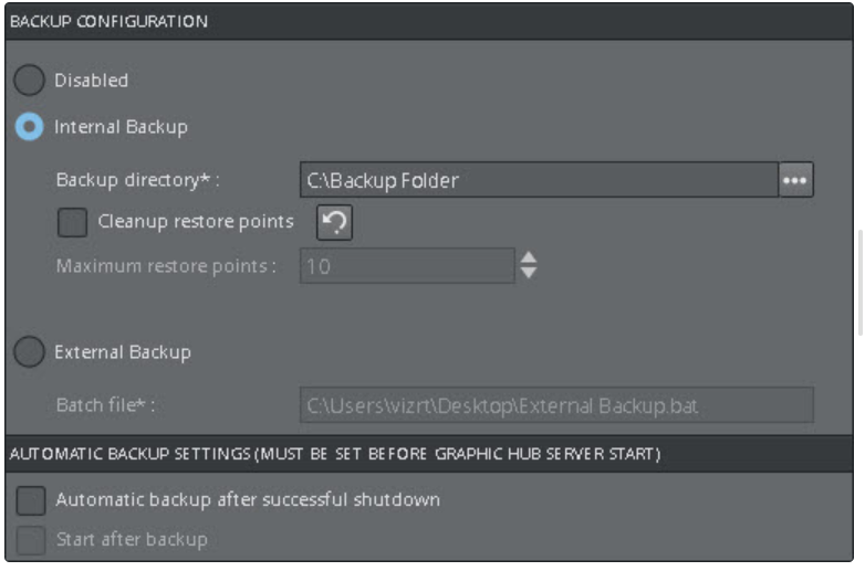

  2. Open Backup Configuration in the Graphic Hub Terminal, by clicking Backup and selecting Show configuration from the Backup and Restore menu.
  3. Configure the server To Do an Internal Backup or To Do an External Backup.
  4. Make sure to check both the Automatic backup after successful shutdown and Start after backup checkboxes.
  5. Start the backup server.
  6. Using Graphic Hub Terminal, Graphic Hub Manager or Graphic Hub REST, configure a shut down task to shutdown the Graphic Hub periodically, for example once per day or once per week, depending on the requirement.
  7. Install a Graphic Hub Deploy Agent on the failover system. If there is no failover system in place, the replication server should be used.
  8. Create a real time deploy task from the cluster towards the backup server, without emergency pausing.
Caution: Because of the resource requirements for the Deploy Agent, it is not recommended to install the Deploy Agent on a cluster’s main server.

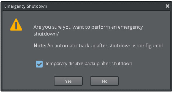

  2. Perform an emergency shut down of the backup system. Make sure to check the Temporary disable backup after shutdown checkbox:
Warning: If the backup after shutdown task is not disabled, the backup task runs and restarts the server afterwards, which can result in possible loss of data.
