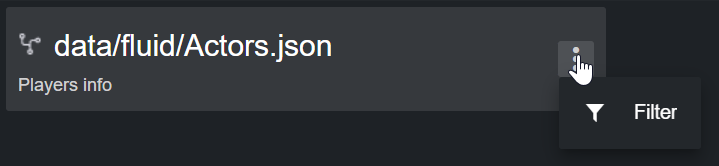

To access the filtering page, select a dataset of one of the supported providers, hover on an instance of a template and in the hamburger menu that appears, select Filter:

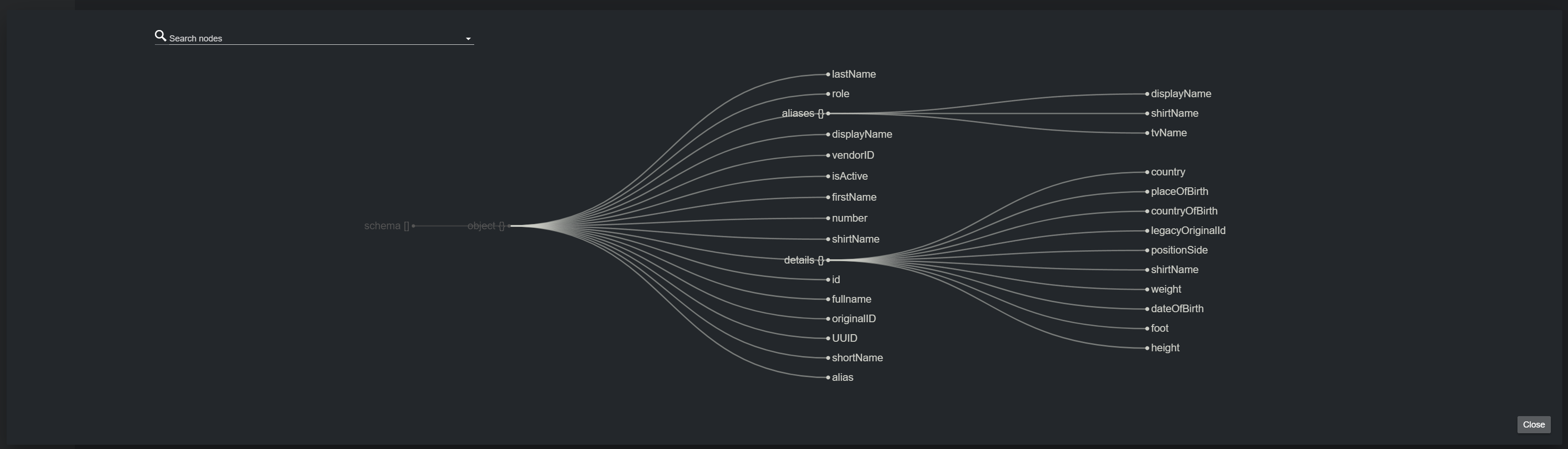

This opens a dialog, where the "schema" (an abstract representation that describes your existing data format) is shown as an interactive tree.
Interacting with the Tree: Filtering Nodes
The tree shown in the filtering dialog can be panned and zoomed: use your mouse's left-button to pan, and the mouse scroll wheel to zoom.

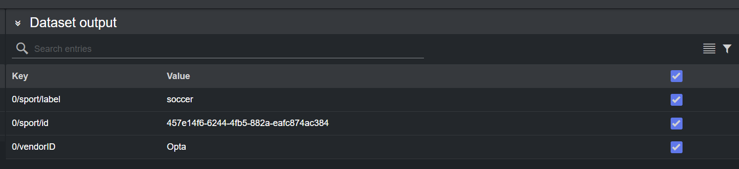

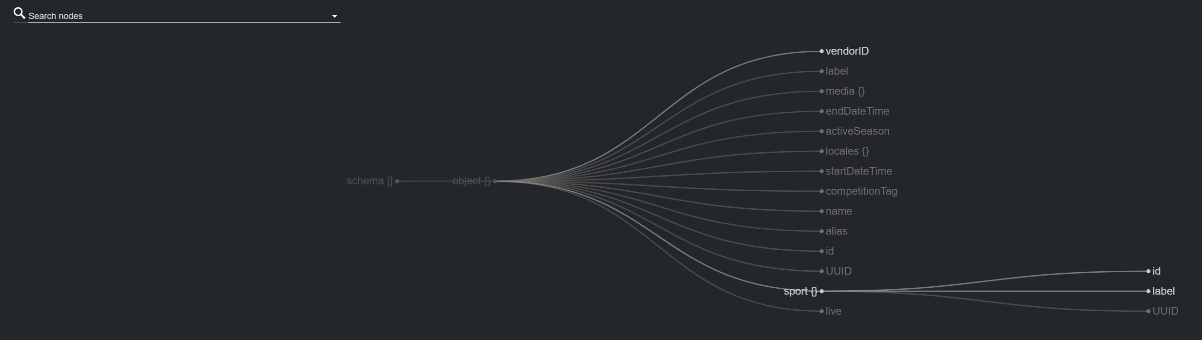

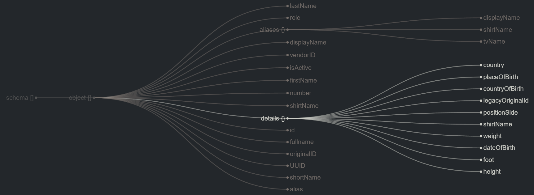

To further illustrate how filtering works, consider the following filtered tree:
This selection results in the dataset to hold the following (flattened) values.

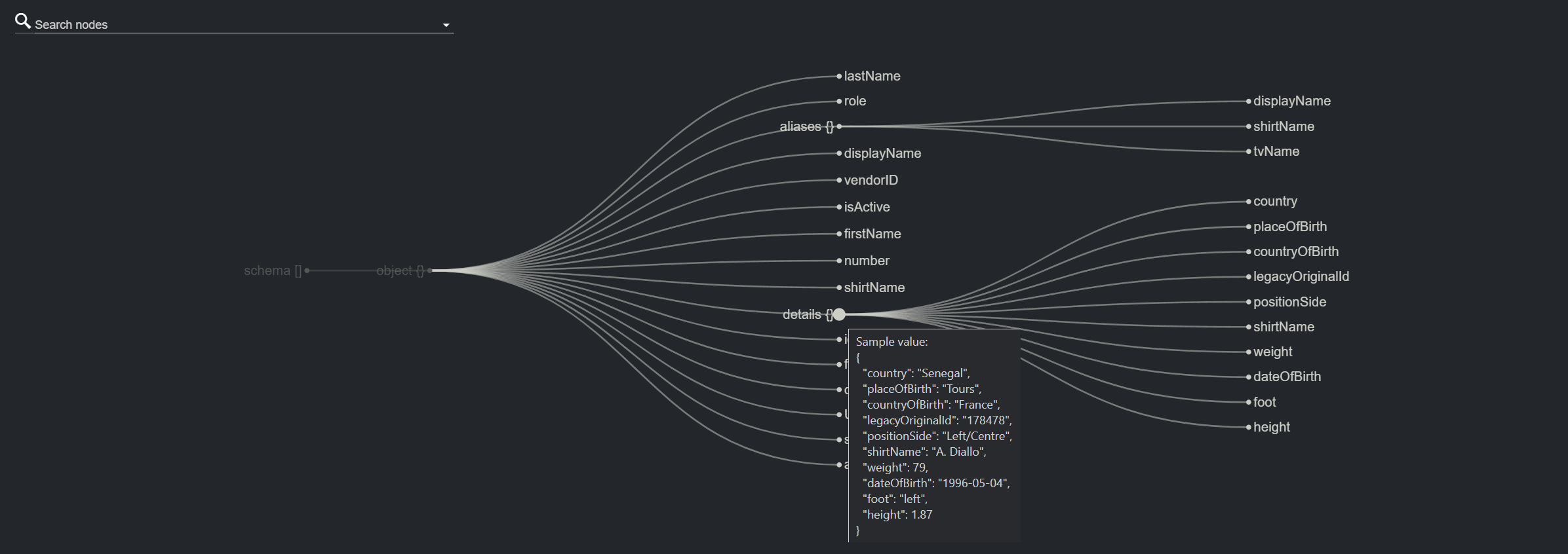

Searching Nodes and Inspecting Sample Values

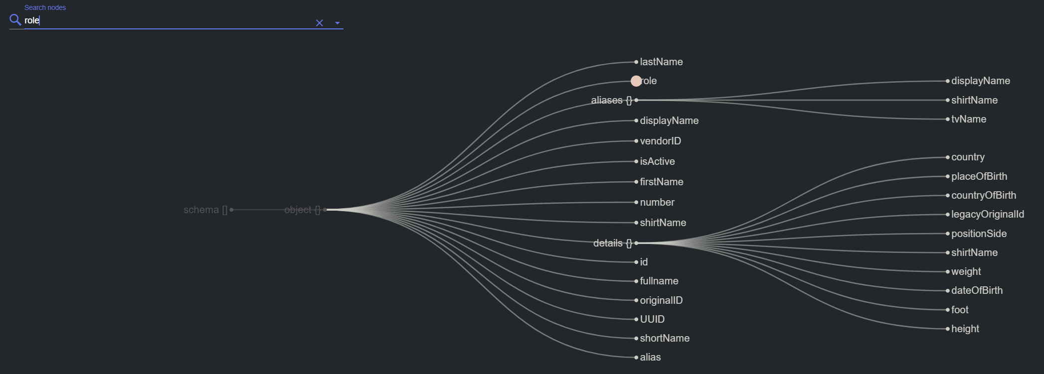

Nodes in the tree can be searched using the Search nodes field in the top-left of the dialog. Start typing a node name in the text field to see all possible matches. By selecting one of the results, the corresponding node briefly changes color and size.
Note: Searching a node triggers highlighted animations on the tree and has no effect on the final dataset. That is, selecting a node name from the search text field does not add the node to the dataset output.
To get an idea of the incoming data, sample payload can be inspected for each node in the tree. To reveal the sample content of a node, hover on its name.
