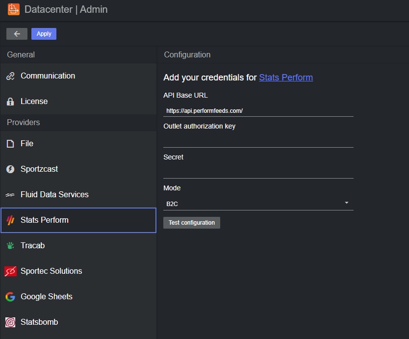

Stats Perform
Datacenter can be configured to fetch data from the Stats Perform data provider. For this integration to work, the following configurations must be performed:
  • API Base URL: The URL used to fetch data from the desired endpoints, needs to be configured to api.statsperform-hosted.com.cn when using the integration from a Chinese IP or domain.
  • Outlet authorization key: Authorization key provided by StatsPerform.
  • Secret: Secret provided by StatsPerform (if needed, depending on the account type).
  • Mode: Business-to-Business (B2B) or Business-to-Customer (B2C), depends on the account type.
  • Test configuration: Use this button to test whether the specified configuration is correct. If correct, the button turns green, otherwise it turns red. Hovering over the button reveals the error in a tooltip:

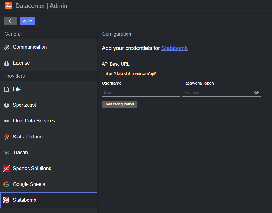

Statsbomb
Datacenter can be configured to fetch data from the Statsbomb data provider. For this integration to work, the following configurations must be performed:
  • API Base URL: The URL used to fetch data from the desired endpoints (default: https://data.statsbomb.com/api).
  • Username: Specifies the username that has access to the API, usually the email address.
  • Password/Token: Specifies the password associated with the username.

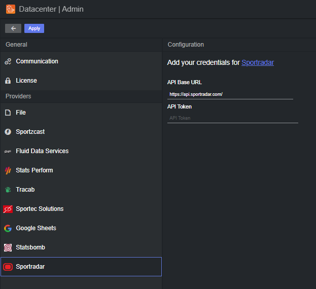

Sportradar
Datacenter can be configured to fetch data from the Sportradar data provider. For this integration to work, the following configurations must be performed:
  • API Base URL: The URL used to fetch data from the desired endpoints (default: https://api.sportradar.com/).
  • API Token: This input field is to specify the API token required to authenticate with the Sportradar backend. The token must be obtained directly from Sportradar.
