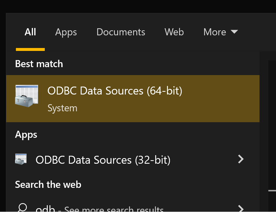

    1. Run the 64-bit version (not 32 bit!) of the ODBC Data Sources application.

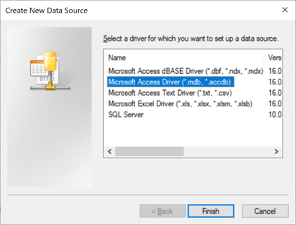

    5. In Create New Data Source select the driver that matches your database type of your database. For example Microsoft Access Driver:
    6. Click Finish.

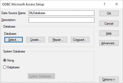

    7. In the ODBC <dBase type> Setup menu that appears provide an alias name (use a name without space characters) for your database that you will be later using in VTW template:

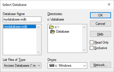

    8. Click Select, then select the database file in filesystem:
    9. Click OK.
      Your database is now registered in the system.
    10. In the ODBC Microsoft Access Setup dialog box, click OK.

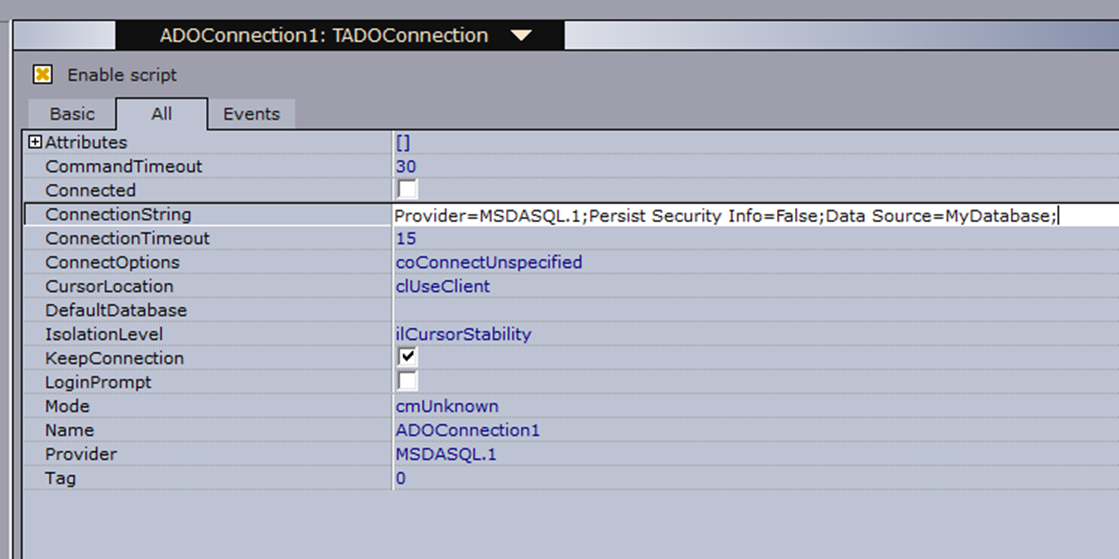

  7. Set the ConnectionString property of ADOConnection1 component to refer to the database you want to use.
    For example, assuming sample screenshots above:
    Provider=MSDASQL.1;Persist Security Info=False;Data Source=MyDatabase;

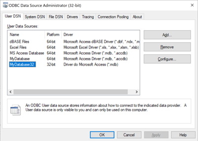

  • For this route, you follow the same upgrade steps as above, but register your database with the 32-bit version of ODBC Data Sources application instead of 64-bit one.
Important usage Notes
  • Be aware that registering database in 64-bit version of ODBC Data Sources application is crucial in regard of using the VTW template in Trio 4.x+.
  • The 64-bit version of the ODBC Data Sources application allows creating, configuring and removal of only 64-bit connections.
    The 32-bit version of the ODBC Data Sources application allows creating, configuring and removal of only 32-bit connections.
