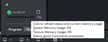

  • Channel: Displays the channel status for all channels configured for the currently selected profile.

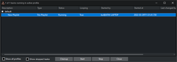

Active Tasks
Double-click the Active Tasks icon in the status bar to open the Active Tasks window.
The Active Tasks window displays show-specific playlists that are running in active profiles, showing active tasks running in other profiles as well as different show playlists within a single profile.
This window contains the following options:
  • Show all profiles: Shows all profiles with Show Playlists.
  • Show stopped tasks: Shows all stopped tasks.
  • Cleanup: Removes all information about stopped tasks.
  • Start: Starts the selected Show Playlist.
  • Stop: Stops the selected Show Playlist.
  • Close: Closes the Active Tasks window.

Checking Memory Usage
Right-click a channel and hover your cursor over one of the bars to see the total usage.
