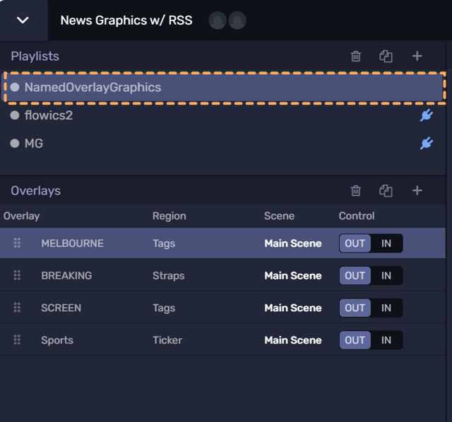

Obtaining a valid overlay graphic as a Named Overlay candidate
To obtain candidates for named overlays
  1. Forward the graphics you want to be part of named overlay as ordinary overlay graphics, by assigning them in the NRCS.
    Viz Mosart now reads these as part of overlays in a rundown.
  2. Verify that the named overlay candidates appear in Overlay Graphics Interface left panel. This is where all active overlay graphics in the rundown are displayed.
  3. Select a named overlay candidate in the Overlay Graphics Interface left panel and press the Info button beneath.
  4. An XML representation of the selected candidate is displayed.
  5. Copy this XML to the clipboard.
  6. Paste the clipboard content into the named overlay XML file, NamedOverlayGraphics.xml.
  7. (Optional) Remove not-required fields, as described in section Named Overlay Graphics.
