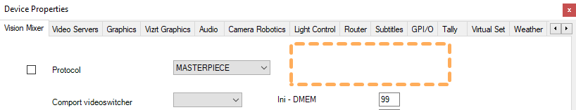

When configuring a vision mixer, the Vision Mixer tab in the Device Properties window links to any additional configuration file used by the driver.
To modify a vision mixer configuration file
  1. Open AV Automation, navigate to Device Properties > Vision Mixer tab > [Select Protocol].
  2. When a device is selected, either

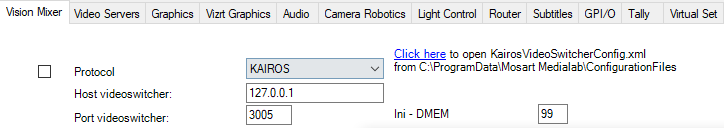

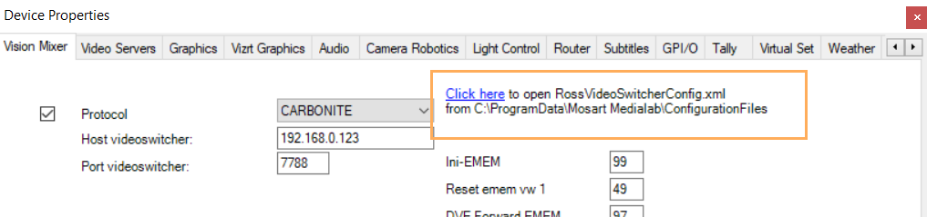

    1. There is a corresponding configurations file that contains additional settings:
      1. This is indicated by the text Click here to open xxx.
        In the example below, a Ross settings file is already located at C:\ProgramData\Mosart Medialab\ConfigurationFiles.
      2. Follow Click here to edit the configurations file.

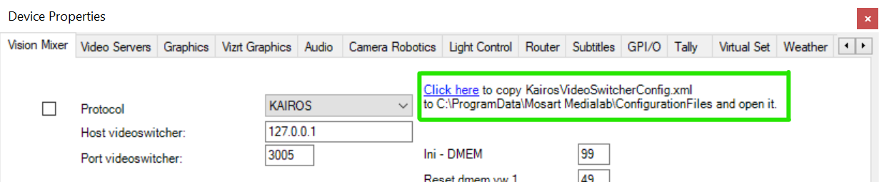

    2. There is no corresponding configurations file:
      1. You can copy an unused default file from the Installation folder.
        This is indicated by the text Click here to copy xxx.
      2. Follow Click here.
      3. The information text changes to Click here to open xxx, as the file now exists for editing, in a standard configuration file folder.
      4. Follow Click here to edit the configurations file.

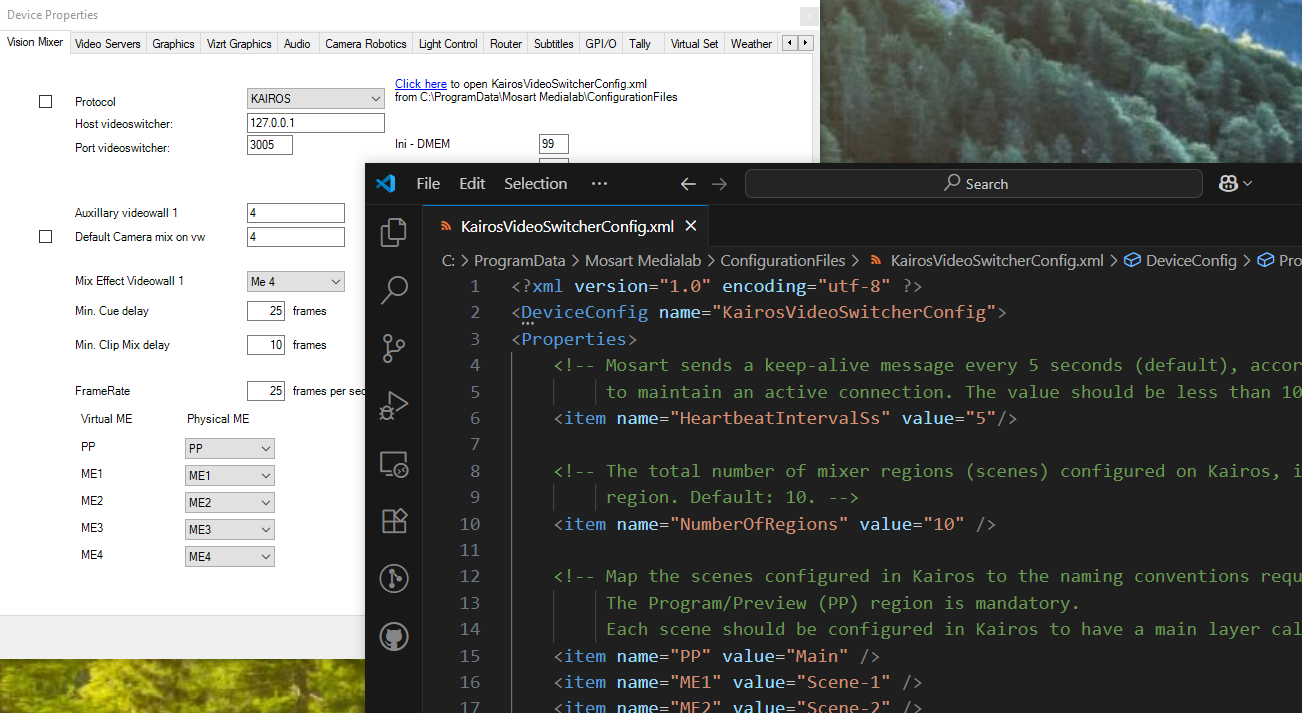

  3. The configuration file opens in your default XML file editor.

      • For ACUITY and CARBONITE video switcher protocols, a new physical ME named ME0 is introduced.
        ME0 shall be used to address the P/P on newer/updated Ross video switchers.
        Set this up under AV Automation > Device Properties > Vision Mixer > [Protocol = CARBONITE|ACUITY].
        This ME naming can, for example, control a Ross Carbonite Ultra video switcher from Viz Mosart.
      • For Carbonite, the MiniME-related settings control the corresponding MiniMEs regions on the switcher, while for Ross Acuity these settings are used to control the B-side of the corresponding mixer region.

KAIROS
Port video switcher: 3005
