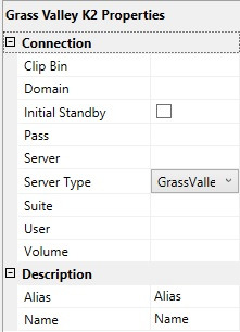

Grass Valley K2
Connection to K2 is initialized with a ping (ICMP) from Mosart to the server to confirm the connection. Then it uses port 3811 to communicate with the K2 server. Both must be open for Mosart to be able to connect.
Manus Admin uses a separate port when it connects: 49171 (a range is OK. Use 49168-49172)
  • Clip Bin: This value, together with that of Volume (see below), defines the default server location of clips to be played. This default location is used only when the location is not provided by other means. (In particular, it is not used when the setting IgnoreBin (in Media Administrator) is true for this server.) The value of Clip Bin should designate a bin in the volume designated by the value of the Volume setting.
  • Domain: The domain as part of the user credentials.
  • Pass: The password as part of the user credentials.
  • Suite: Arbitrary value. However, follow these guidelines:
    • For each K2 server, two or even three unique Suite values must be used:
      • First, the values for Media Administrator and AV Automation must be different.
      • Second, in a redundancy setup with Main and Backup Mosart server, the two values for Media Administrator must be different.
        Note: In this constellation, both Main and Backup AV Automation should use the same value, different from the two Media Administrator values.
  • User: The username as part of the user credentials.
  • Volume: This value, together with that of Clip Bin (see above), defines the default server location of clips to be played. This default location is used only when the location is not provided by other means. (In particular, it is not used when the setting IgnoreBin (in Media Administrator) is true for this server.) The value of Volume should designate a server volume.
  • Server: Defines the hostname or IP address of the video server.

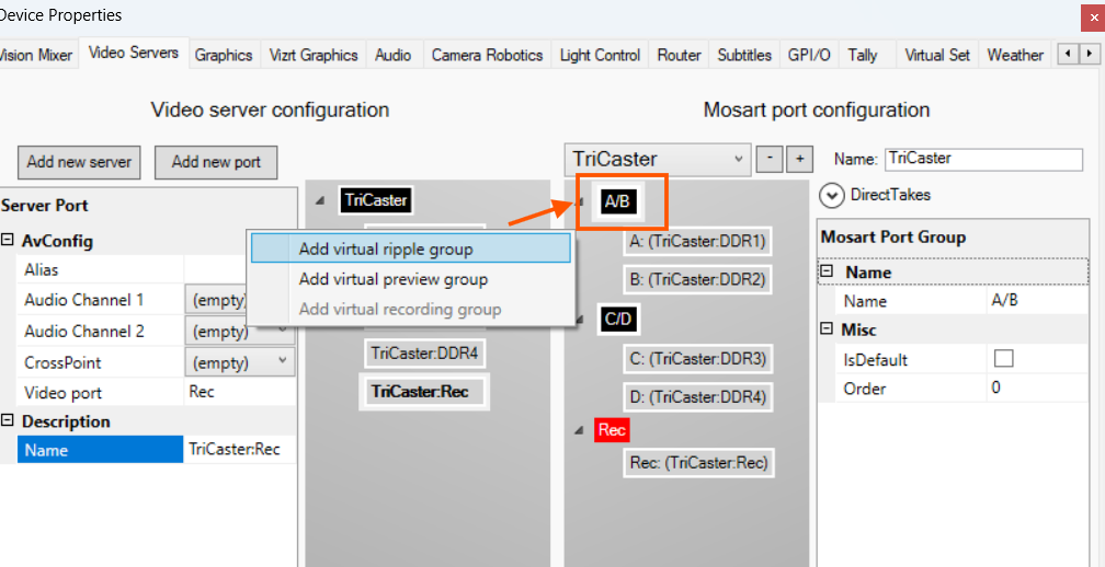

Mosart Port Configurations
The right-hand part of the Video Servers tab (titled 'Mosart port configuration', shown in the screenshot below) has three parts:
  • the salvo part (in the screenshot the first ‘line', starting and ending with 'Main’, and also the DirectTakes panel with four text boxes and labels)
  • a tree structure showing virtual ports and virtual port groups (the bulk of the left-hand side of the screenshot)
  • a panel showing the details of the virtual port or the virtual port group selected ('Mosart Port Group' in the screenshot).
A salvo is a particular setup of servers and ports. There will always exist at least one salvo. If several salvos are defined, these will usually involve different sets of servers and/or ports, and the user will be able to switch from the active salvo to some other salvo. This will involve, among other things, disconnecting from servers that will not be used in the salvo switched to, and connecting to servers that are to be used now. This will be discussed later.
Working with Mosart Port Configurations
The tree structure shows the virtual ports and virtual port groups defined. (These are the same in all salvos.) Visually (in the tree structure), the groups are black, and the ports are grey (and indented). A virtual port may have one or two server ports linked to it. (If it has two server ports linked to it, the two are mirrored. Mirroring will be discussed later.) A virtual port group is, as the name indicates, a group of virtual ports. Such a group may be used for A/B roll (playout of clips on alternate ports). Both virtual port groups and individual virtual ports are available for selection in the Template editor.
To add a virtual port group
  • Right-click in the Mosart Port Configuration tree (not on a node) and select either:
    • Add virtual ripple group to add a new virtual ripple group. The default ripple group names are A/B, C/D, E/F etc.
    • Add virtual preview group to add a new green virtual preview group to be used for preview ports. The default preview group name is P.
    • Add virtual recording group to add a new red virtual recording group to be used for recording ports. The default recording group name is Rec .
The virtual port group is added to all salvos.
You can edit or rename the selected group using the Properties Editor on the right.

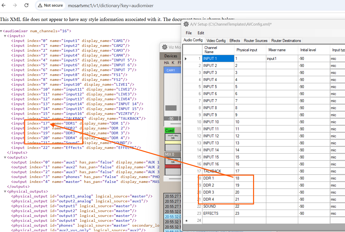

  1. Navigate to Av Automation > Devices > AV Setup > Audio config and configure the audio inputs as configured on TriCaster.
    The input indexes can be taken by accessing TriCaster over REST API:
    http://<TriCaster_host>/v1/dictionary?key=audiomixer
    For audio, the indexes are 1-based, so add +1 to the number found in the the request response:
    Alternatively, the input name can be mapped to the Mixer name column in A/V Setup in which case the Physical input value is not relevant, but must be filled to a number unique within the values from that column.

  1. Click the Plus sign on the right under Mosart port configuration to create a salvo for TriCaster:
  2. In Name, give this new virtual server an appropriate identity, for example, TriCaster.
  3. Right-click on the black box to add a virtual port group.
  4. Click on the first Video server configuration (physical) port on the left half and drag-and-drop it to the first virtual one on the right under Mosart port configuration.
  5. Repeat with the second port, by dragging another physical server port from the left side to pair them into an A/B ripple port playout group.
  6. Add another virtual ripple group with 2 virtual ports and link them with the rest of the physical ports, if any.
  7. A virtual recording group with one virtual port and link the physical recorder port to the virtual one in the same way as explained in step 12.
  8. Click Apply, then Save & Close.

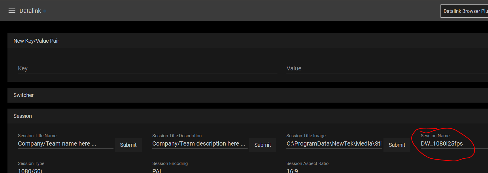

To find session name
Note: To find session name:
  • Navigate to the TriCaster DataLink menu:
  • The session name is also displayed on the TriCaster home page (hidden menu at the top left corner):
