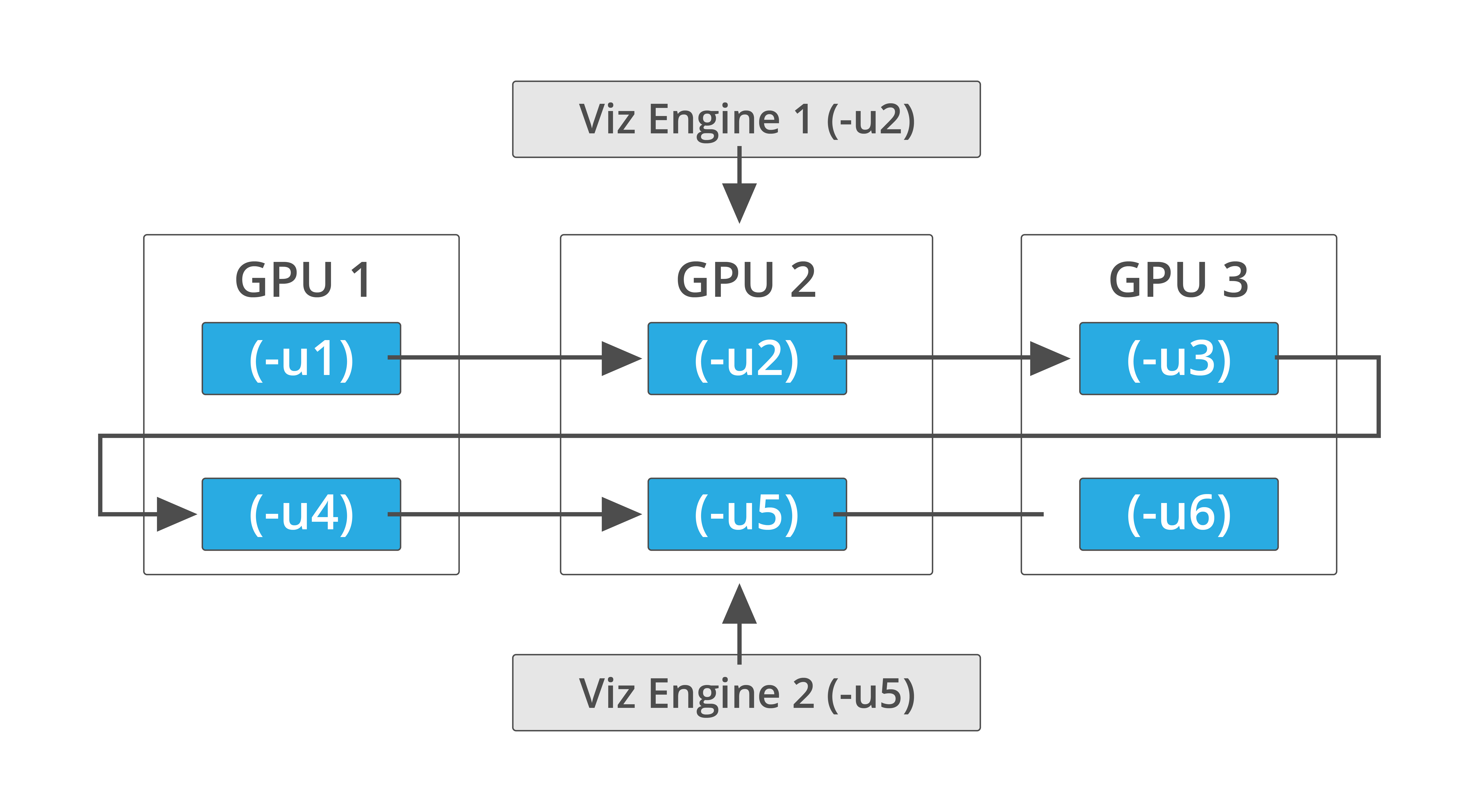

Systems with Two or More GPUs
It is possible to specify which GPU Viz Engine should run on, by providing the flags -u1 and -u2 for GPU1 and GPU2, respectively. A maximum of 24 GPUs are supported. This allows the system to run the Engine on one GPU while running Viz Config on another, for example:
<viz install folder>\viz.exe -c -u2
<viz install folder>\viz.exe -n -u1
More than one Viz Engine can run on one GPU (multiple Viz Engines can not run on the GPU with the same port number), use the formula m%n to calculate which Viz Engine instance to use (Viz Engine defined by -u<m>). Note, however, that Viz Artist can only run on Viz Engine instance 1 (-u1). Only the control GPU should have a display connected and is used for Artist/Preview.
Formula: m%n, where:
  • m = -u1/-u2/etc.
  • n = number of GPUs
For example, with two Viz Engines:
  • System with two GPUs: Engines run on GPU2: Engine 1 (-u2) / Engine 2 (-u4)
  • System with three GPUs: Engines run on GPU2: Engine 1 (-u2) / Engine 2 (-u5)
When either Trio One Box or Dual Channel Viz Artist versions are installed, GPUs are selected by default.
