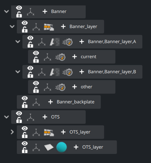

  1. Add a group container to the scene tree, and name it Banner. This is the placeholder for the banner’s toggle layer and backplate graphics for the banner object scenes.
  2. Add a sub-container to the Banner container, and name it BannerLayer. This acts as the placeholder for the Toggle plug-in.
  3. Add the Toggle plug-in to the BannerLayer container. This generates the default object placeholders for the toggle layer’ s current and other state.
  4. Add a sub-container to the Banner container, and name it BannerBackplate. This is the placeholder for the banner’s backplate(s).
  5. Add a rectangle and material to the BannerBackplate container, and adjust the Transformation Editor properties such that it creates the look and feel of a simple lower third graphics.

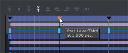

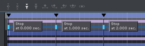

  10. Select the Banner director, set the director’s Time Marker to 0.000 seconds, and add a Stop/Tag.
  11. Select the tag and name it O (uppercase O, not zero).
  12. Add a new tag for the animation’s in point and name it LOWERTHIRD, and a second out point named O. These tags represent the basic states the graphics can be in.
  13. Open the Toggle plug-in editor, and click the Default Key Frames button.

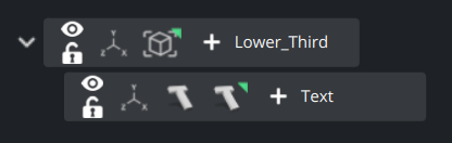

  1. Create a new scene, and name it 1000.
  2. Add container to the scene tree, and name it lowerthird.
  3. Add Control Object plug-in to the lowerthird container.
  4. Add a sub-container to the lowerthird container, and name it text.
  5. Add a font to the text container.
  6. Add a Control Text plug-in to the text container.

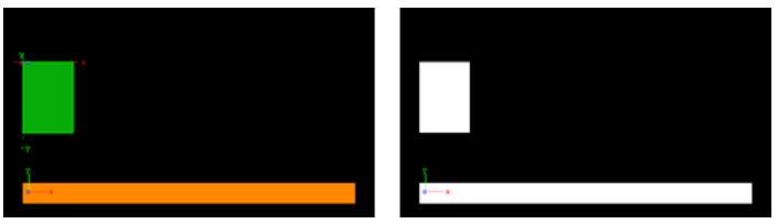

To Create a Background Image for the Object Scene
  1. Open the Master scene.
  2. Open the Stage view and set the layer’s state where it matches the state of the Object scene, for example LOWERTHIRD.
  3. In the Scene Editor, click the Snap button and save the snapshot. Make sure to give it an identifiable name, for example banner_lowerthird. The snapshots can be used as placeholders for the object scenes.

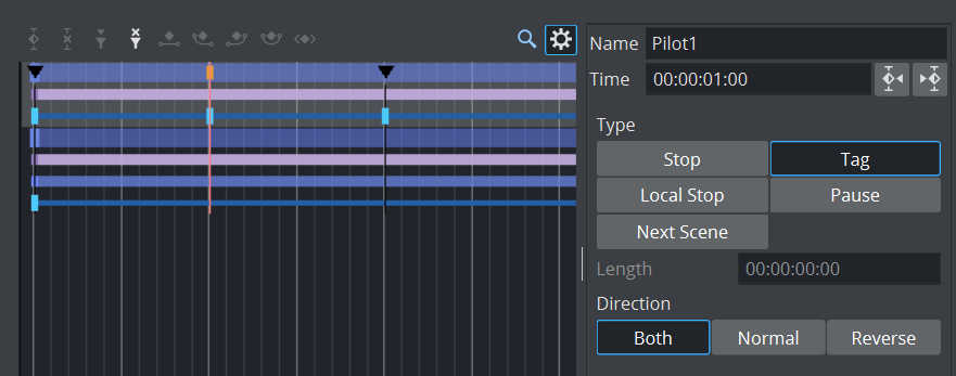

To Create a Preview Point
  1. Open the Stage, and select the Default director.
  2. Position the Time Marker from where you would like the scene to be previewed.
  3. Click the Add a Stop/Tag button.
  4. In the appearing editor enter Name as pilot1 (case sensitive), and set Type to Tag. When previewing using a remote (external) Viz Artist/Engine preview, either from a newsroom system, or when connected to a Media Sequencer with a control application, the pilot1 tag is the default preview point for the object scene.
